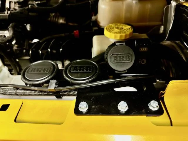

We haven't taken a trip yet, but from the install I'm pretty confident. I posted a bunch of pics here, @tjeeper picked one up too:
https://www.jlwranglerforums.com/forum/threads/rough-country-compressor.120976/
Note, I've been using the ARB single portable (one in the box) for a couple years. It was fast enough with a four way, but I was tired of lugging it in and out. The single box is pretty big, so a double with tank is probably sizable.

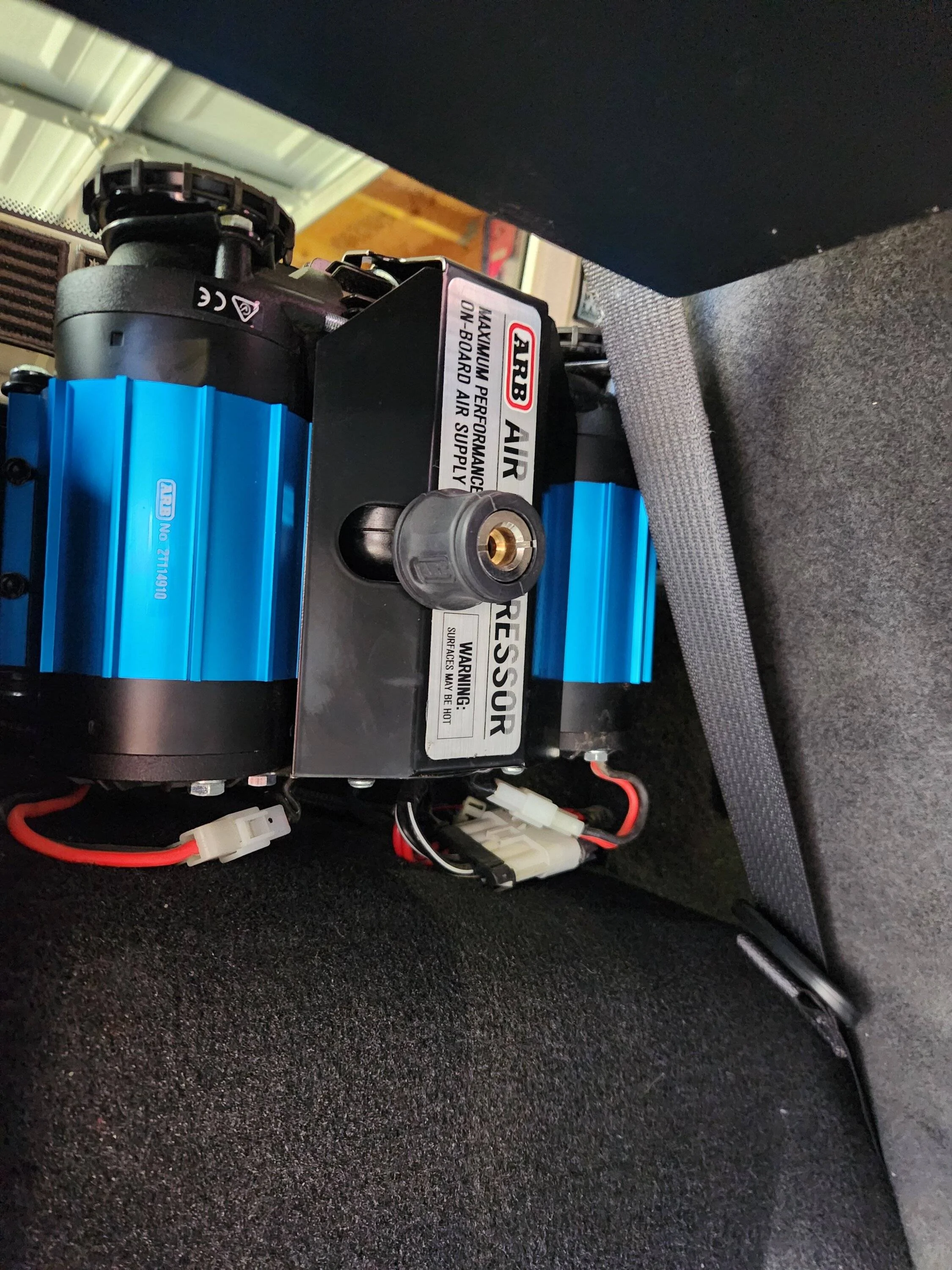

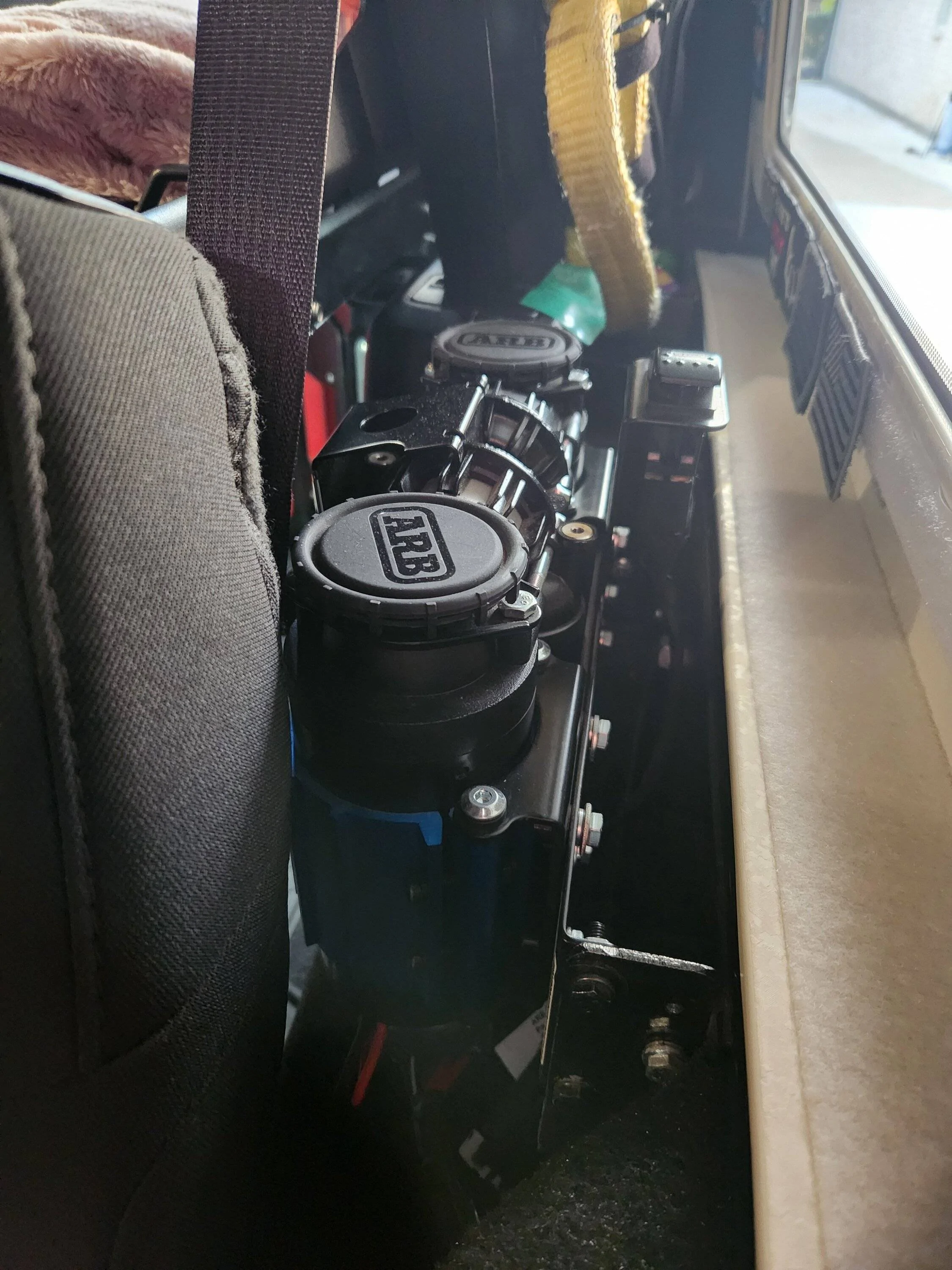

Innovative AT Products system under the passenger seat with the ARB twin. All 4 tires at the same time, same pressure
i really like that placement of the air chuck !!!!!!
Thanks for the info. I like the portable idea. Either that or behind the fender are my two options. So, if I read it correctly, the mounting spots are the same as the arb? Theoretically, any bracket that mount the pump behind the fender would work on this one?
Yup, same bolt pattern.
One on each side. It disappears until you need to use it. I’ve been very happy with this setup. It’s one of the things that puts a smile on my face every time I use it.
AC77
shoot! This is awesome! Im going to use your idea once day soon! its clean!!!!
