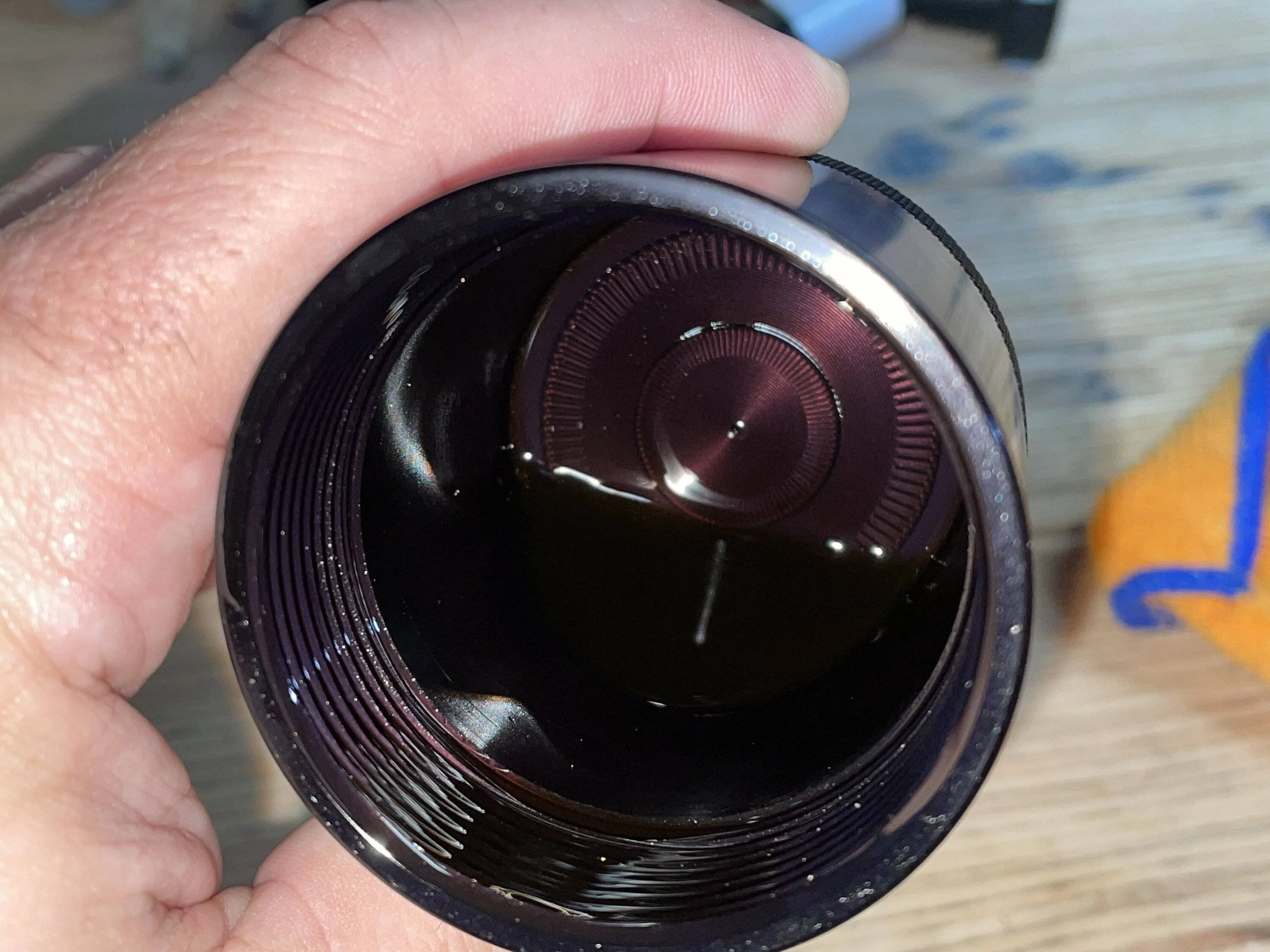

Took 2 months to get but after 500 miles I have about a tablespoon of oil. No gas smell.
I run one on my 6.4 challenger as well and at 1500 miles I had 3 tablespoons of oil.

Your report is literally first one here showing something more, than a smear of oil on the bottom of the catch up tank.
Not sure why. I've ran catch cans on any DI engine I've owned and they've all collected content of some kind. As temperatures drop I seem to get more watered down results but when temperatures are high, more concentrated oil.
I know that definitely what was caught would have gone into the PCV intake and eventually made it to the back side of the valves. After 50k miles i could definitely see the build up occurring.
With PFI it's not much of a factor as stated because the fuel cleans the valves but oil in the combustion chamber can effect octane levels.
