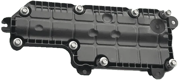

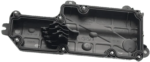

It looks like a straight forward baffle system. The oil return system must be built into the block, as I see no connections on the outside of the unit. It looks like the air moves through the baffle from the right side of the image and is maybe vented out a connection at the front, while the oil collects in the larger reservoir and flows back into the block.
I've not seen it on the engine so I'm speculating.
