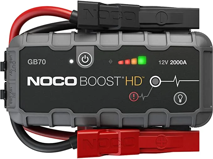

Meh...
Mine fits in the glovebox.
Jeep Wrangler JL Off-roading with a manual transmission? 91JeLn8iRZL._AC_SX679_
Clutch starting on the trail? On pavement sure. Better to carry one of these manual or not.

Unfortunately, I’ll have to say I would need to see this done to believe. Yes, I have push or roll started plenty of old school vehicles. Before the days of computers and fuel injection. With no ECM and no fuel pump, she isn’t gonna start. Just jump starting a JL can be a challenge, because of voltage checks or some such pre-crank requirements. Been through that myself not long ago.

I was going to say almost the same thing. On old vehicle you can pull/push/roll start a manual transmission, but it's not quite that easy on new vehicles if you have zero voltage from the battery and you probably can't spin the engine fast enough to get enough juice from the alternator to get all the electronics working. Just as an example of one part, typically when you first turn the key on (and not crank the engine yet) it turns on the fuel pump to prime and pressurize the system. If the battery is dead it obviously won't do that. Not saying it is 100% the case on every vehicle, but there would be times you could not pull start a new vehicle with a manual transmission if the battery is completely dead.
