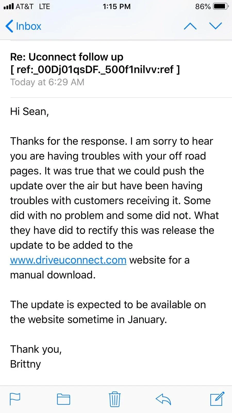

I finally contacted FCA to see if they could manually push the update to me. They responded that they aren’t doing manual pushes any longer as it seemed to be hit or miss, and instead they will make the update available for manual download on the Uconnect website sometime in January. I asked whether it was possible to sign up to receive notification when it is available, but they said no.
Jeep Wrangler JL Off Road Pages Update Status... 70C0DA73-5872-41DD-8F32-3B5E0FB45624
