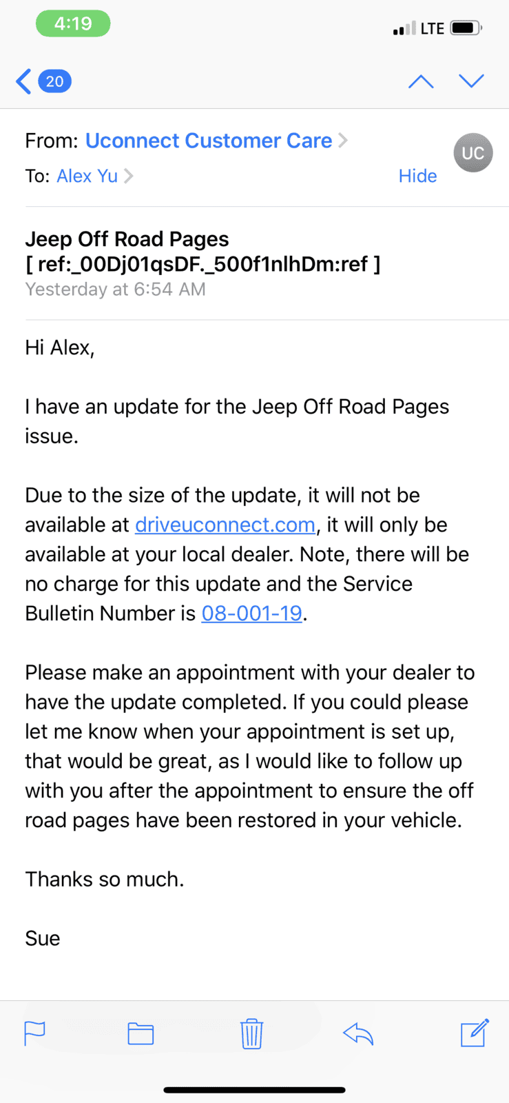

I just dropped it off at the dealer and they said it’s not applicable to my Jeep and said that if I bring it back again for this they will have to charge me for diagnostic fee. I brought my Jeep into Stewart Jeep in Colma, Ca. They said the tsb applies to a Chrysler Pacifica pcm reflash and sent me on my way.

Couple of questions for you... do you have the 8.4 NAV? Also, did you list the correct TSB 08-001-19?
Otherwise, the dealer is full of it. Customer service at its finest. Smh

Yeah I have the 8.4 Navi. Uconnect was the people that told me the update was available cause I made a support ticket with them. I attached the email
Yea, I would go in and ask to speak with the Service Manager. IMO it’s messed up threatening to charge you when they are the ones that made the mistake. Or just go to a different dealer (if you have another one close by).

Here you guys go if you guys run into the same issue as me. Here’s the actual TSB from Jeep.

It was a pcm flash for the Pacifica and they said it had nothing to do for the off rod pages. It said it was for the something about the driving module.
Hey alexyu650,
The JORP update should be able to be applied to affected vehicles under warranty, and please send us a PM so we can take a closer look.
