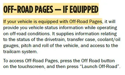

Would be nice to know what option or package has to be installed in the Wrangler to know the if/when the Off Road Pages are "equipped."
From the 2024 owner's manual:

Problem is it won’t launch. Referring to my post with a the vid.
I'm aware and believe your Wrangler does not have Off Road Pages available from the factory-as mine. It's sad really. Every Wrangler should have these Off Road Pages.
