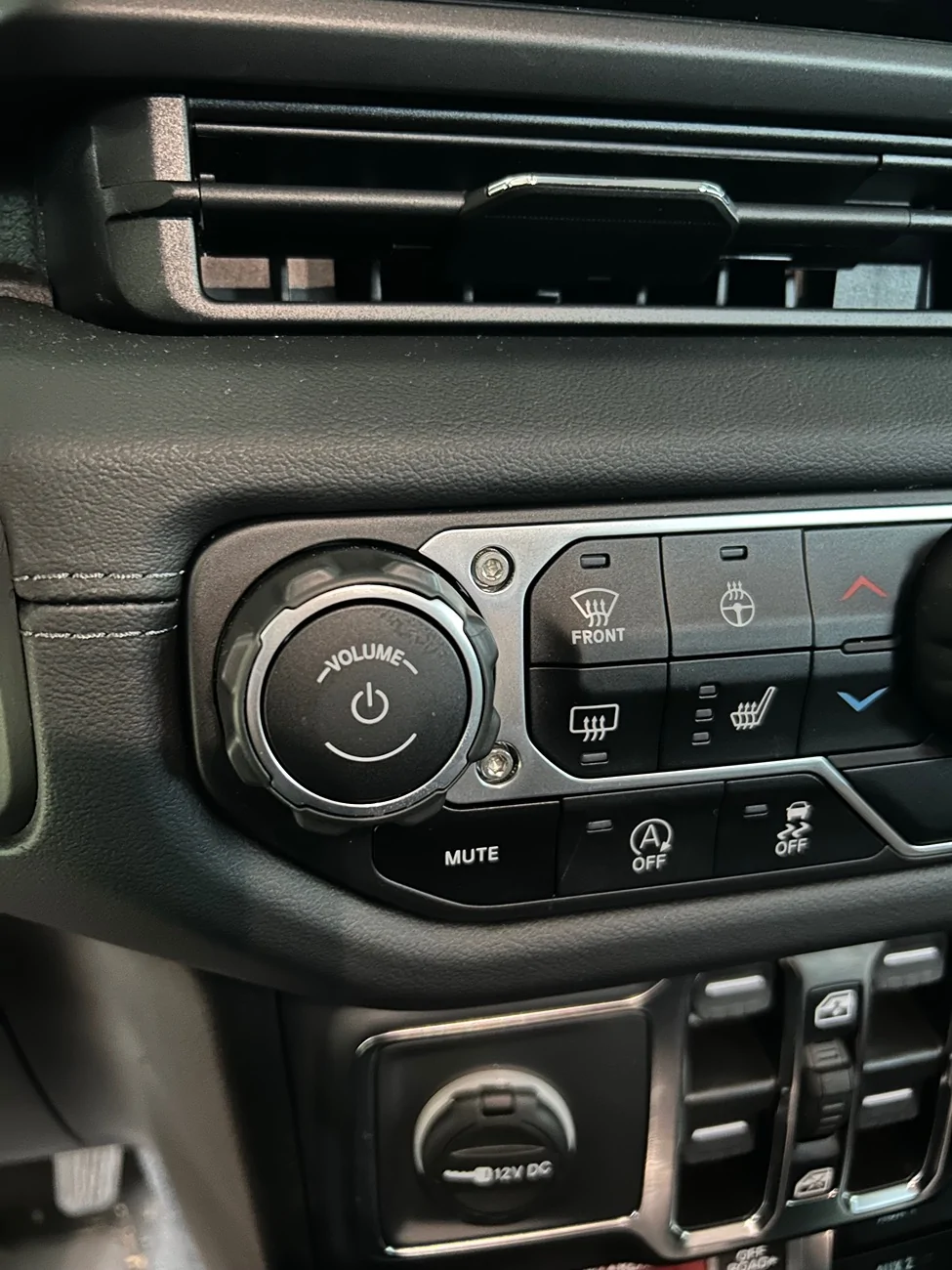

On the Volume control press and hold this in and the screen will turn off and reboot the system
