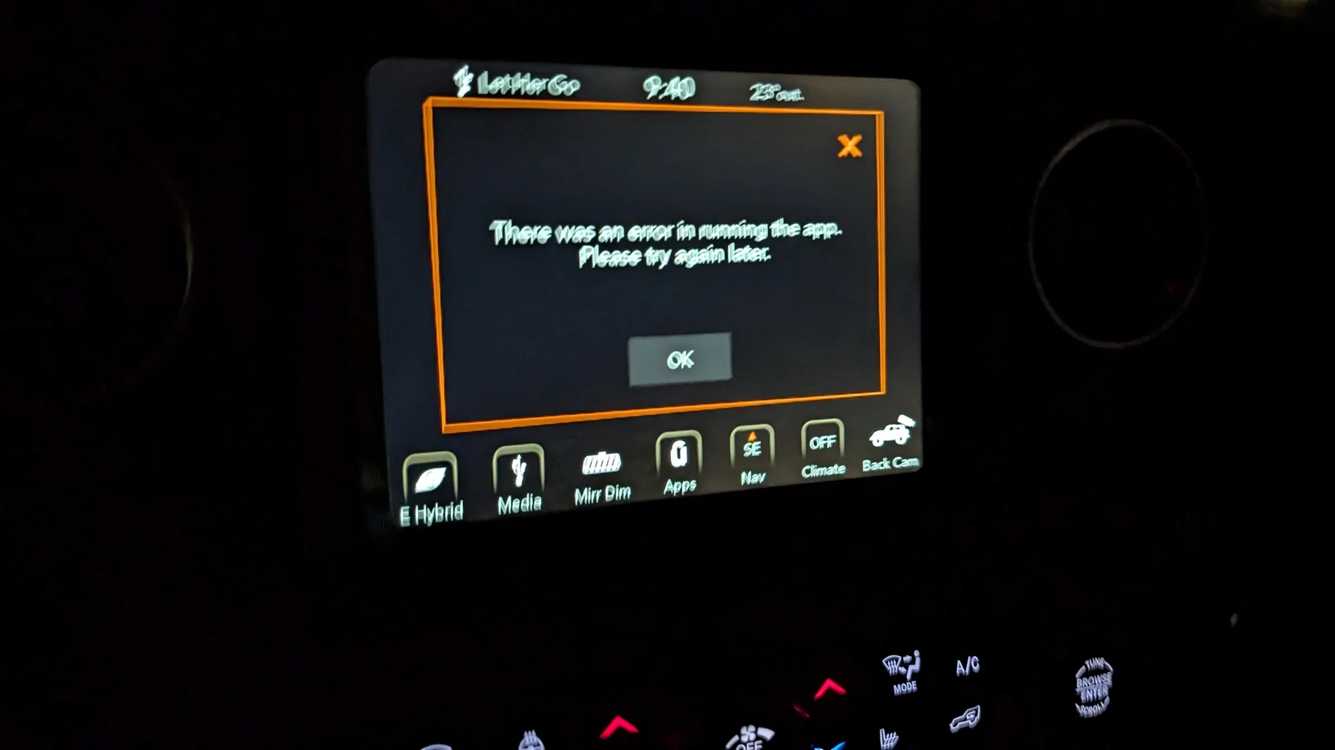

The off-road pages is junkware, the few times I was going to use it, it failed, and when it fails it messes up the layout of the screen, basically you are left fiddling with đź’© while driving.
It works most of the time, usually when I hit a trail and try to use it, it fails.
This is the last time I tried to use it on a trial in the middle of the night.
Anything to do with the uconnect system is utter garbage.
Jeep Wrangler JL Off Road Pages Not Working 1000024312

Mine will flake out once in a while, but it fundamentally works. On the trail yesterday, for example, the icon was gone. It showed up a few minutes later.
Fortunately you're still under warranty.

I use my off road pages every day, for the extra gauges.
Over the course of time, I've noticed that 'order of operation' seems to be important for the ORP to work properly. I think because it's loading in the background, and when the computer gets too busy, it acts stupid.
Acting stupid includes
No icon
Starts to load, then fails right after the tiny Jeep animation finishes
Busy, try again later message.
I have the icon dragged down to the easy access bar at the bottom of the screen (Uconnect 8) and what I've noticed is that it takes a minute for that lower icon to populate. And what I've learned is that as long as I don't interrupt the computer with some sort of extra task, until after that lower icon appears, all is well.
Specifically these things make my off road pages go stupid if I don't wait.
Activating the rear camera by shifting into reverse.
Connecting the phone with the USB cable
Receiving a call, no matter how your connected, BT, or USB
Oddly the phone self connecting with the BT, and auto-playing music doesn't seem to cause any problems.
Resetting fixes this, but sometimes you have to do it more than once. Especially if you have gotten the system busy, try again message.

I have a 2024 4Xe, and have found that when Off-Road Pages fails to work that creating a New Profile, and copying the old profile to the new (additional ) one, ORP works fine in that new profile.
Good luck!
