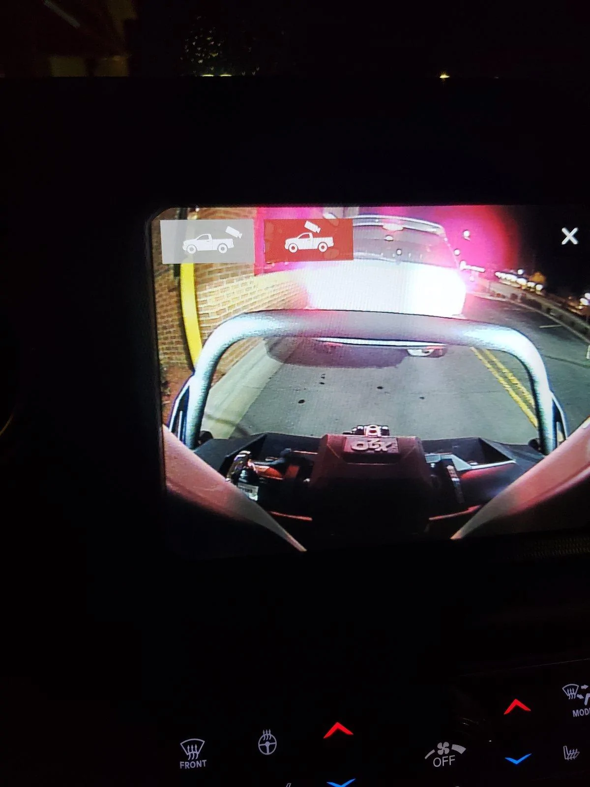

So I can only speak to my install, reference it earlier in this thread for details. Regarding your first question AFAIK separate power is still required with the camera I used or the chuanganzhuo. I know this because I purchased and tested both. I opted for the unit I selected because of the viewing angle. The one I used provides a 145 degree view whereas the chuang... was a 90degree. I preferred wider at greater distortion personally. (I included
Photos earlier so you can see my view earlier in this thread) You can double click mute as indicated to access and rapidly toggle between rear and cargo via touchscreen or make both available on the uConnect apps bar, I find myself using them both so ooften that I have both mapped to my apps bar. BUT selecting one allows for simply selecting the “other” in the upper
left portion of the display when camera view is up.
