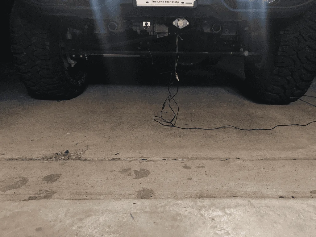

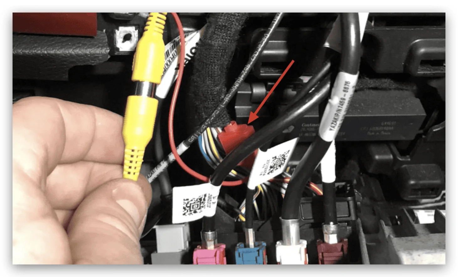

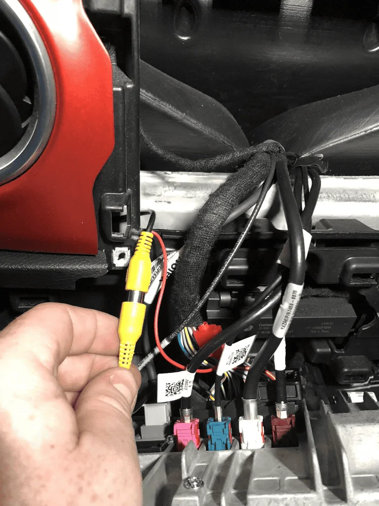

@tmakaro In case you're interested in changing your power source, I did get mine wired in to a 12v power source at the head unit. I just used a simple quick connect to tie into the larger red wire with a yellow stripe going into the 52 pin connector. It's right next to a black ground wire and pretty easy to verify with a voltmeter. On the RCA cable I had, the red power wire was super thin, so I stripped it back and folded the wire over itself before putting it into the connector to ensure good metal to metal contact.
While the wiring in the dash is all done, I still need to pull the camera through the firewall and get it mounted. Here are a couple of shots from it being roughed in, though. The camera is on the bottom of the bumper, centered between trailer breakaway connector on the left and the six pin trailer connector on the right.

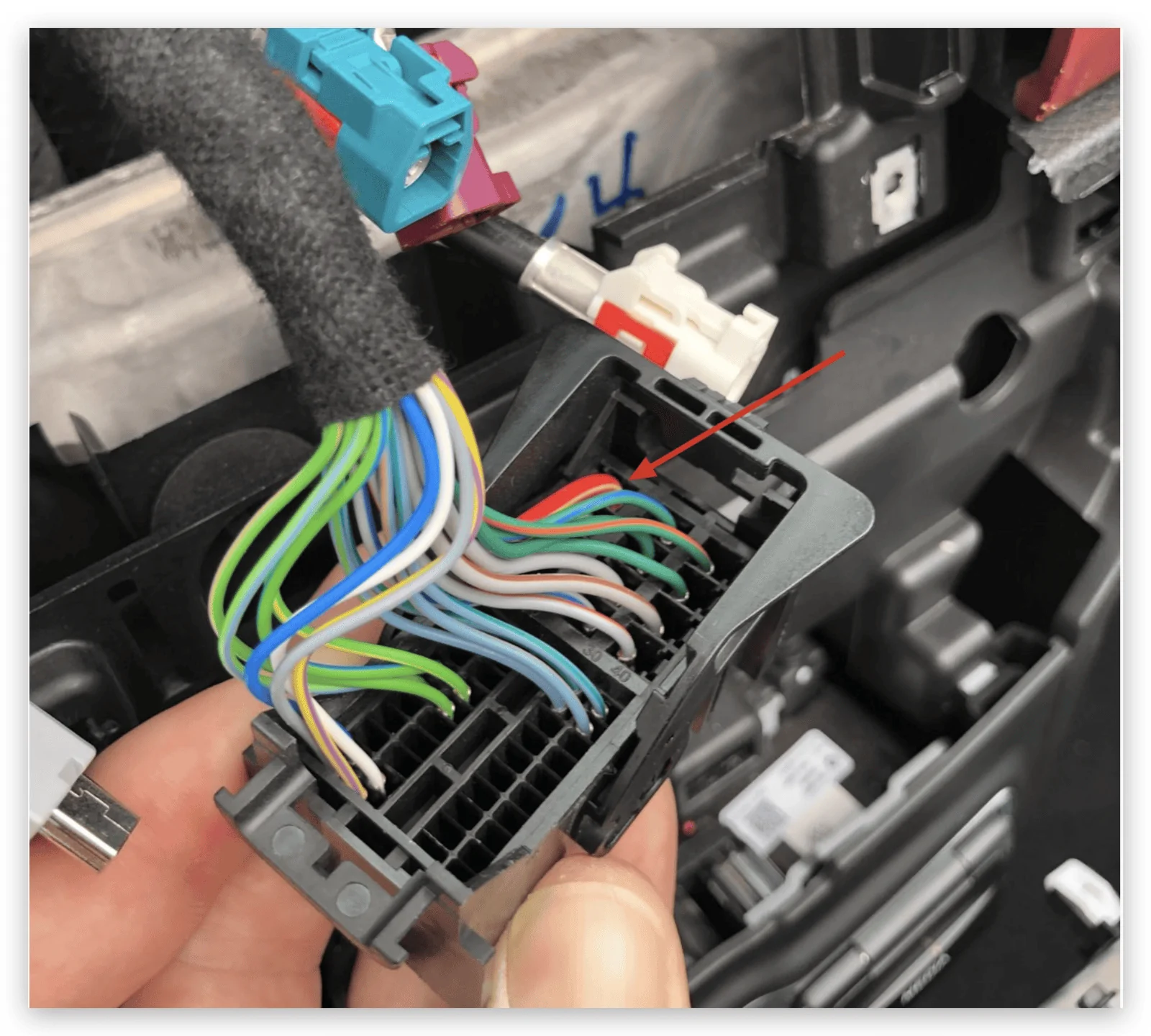

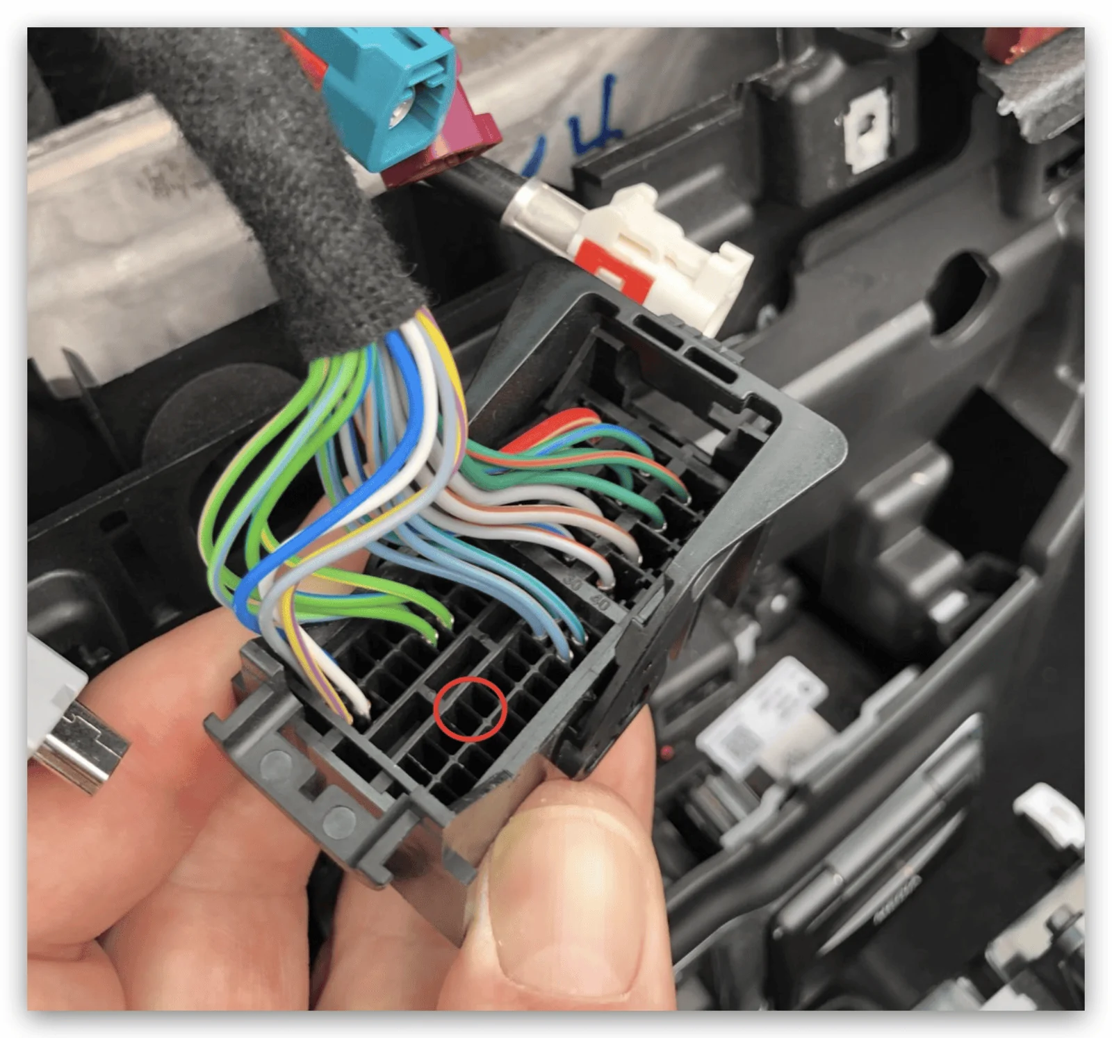

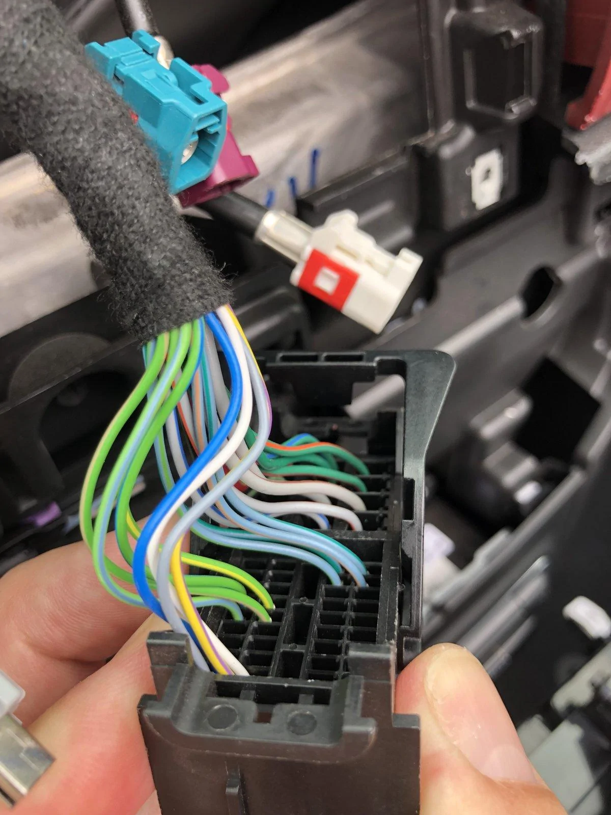

Question for you guys, I purchased everything you have recommended but unfortunately pin #24 & #25 were taken. What do I do?
Thanks,
Todd

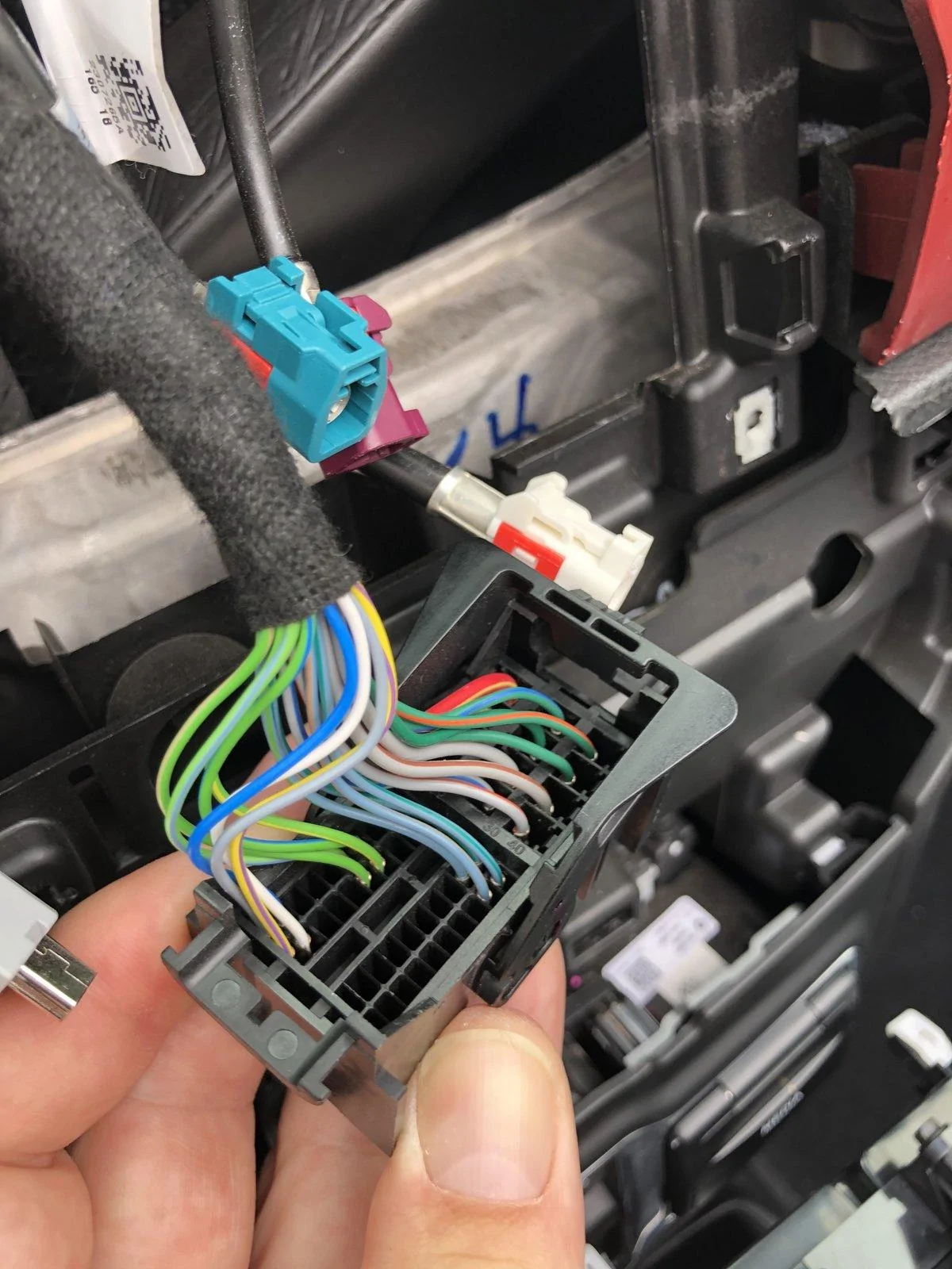

Thanks,
Todd
Is yours a 2019? If so, the wiring could be a little different. Either way, it looks to me like the pins you need are open. Comparing your plug to the instructions from the Z Automotive site (https://zautomotive.com/wp-content/uploads/2018/06/Tazer-JL-AV-Cable-install-guide.pdf), these appear to be the pins you're looking for.
Jeep Wrangler JL Off-Road Camera (front facing) writeup upload_2018-11-28_14-42-43
I didn't grab a good picture of mine, but if you look closely, you can see where the camera pin wire is in one of my screen shots and it looks to be about where I circled the two open pins on your connector.
Jeep Wrangler JL Off-Road Camera (front facing) writeup upload_2018-11-28_14-41-21

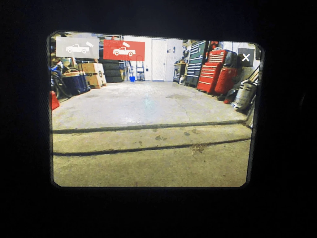

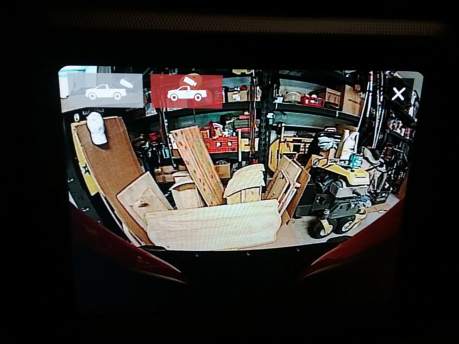

could you post a quick video going through the process of navigating the menus to get to the camera? Is the reverse camera operation unaffected? Easy to swap between cameras?
Reverse camera is unaffected. Under the apps view, you'll still have the option for the backup camera and after adding the new camera and configuring the Tazer, you'll see a Cargo Cam option as well. When you put the vehicle in reverse, you can also toggle between the two cameras using the icons in the top left corner. Rear view is still the backup camera and the cargo cam is the front camera.
Jeep Wrangler JL Off-Road Camera (front facing) writeup 80941
Thank you so much for taking the time to respond. I also texted Zautomotive and they were nice enough to respond too. Apparently I was counting backwards, I thought pin 10 was 1 and 1 was 10. I should be good, I'll try this weekend. Thanks again.

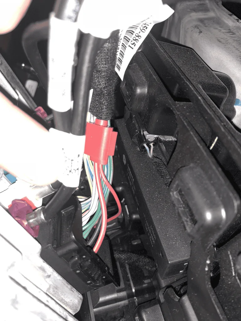

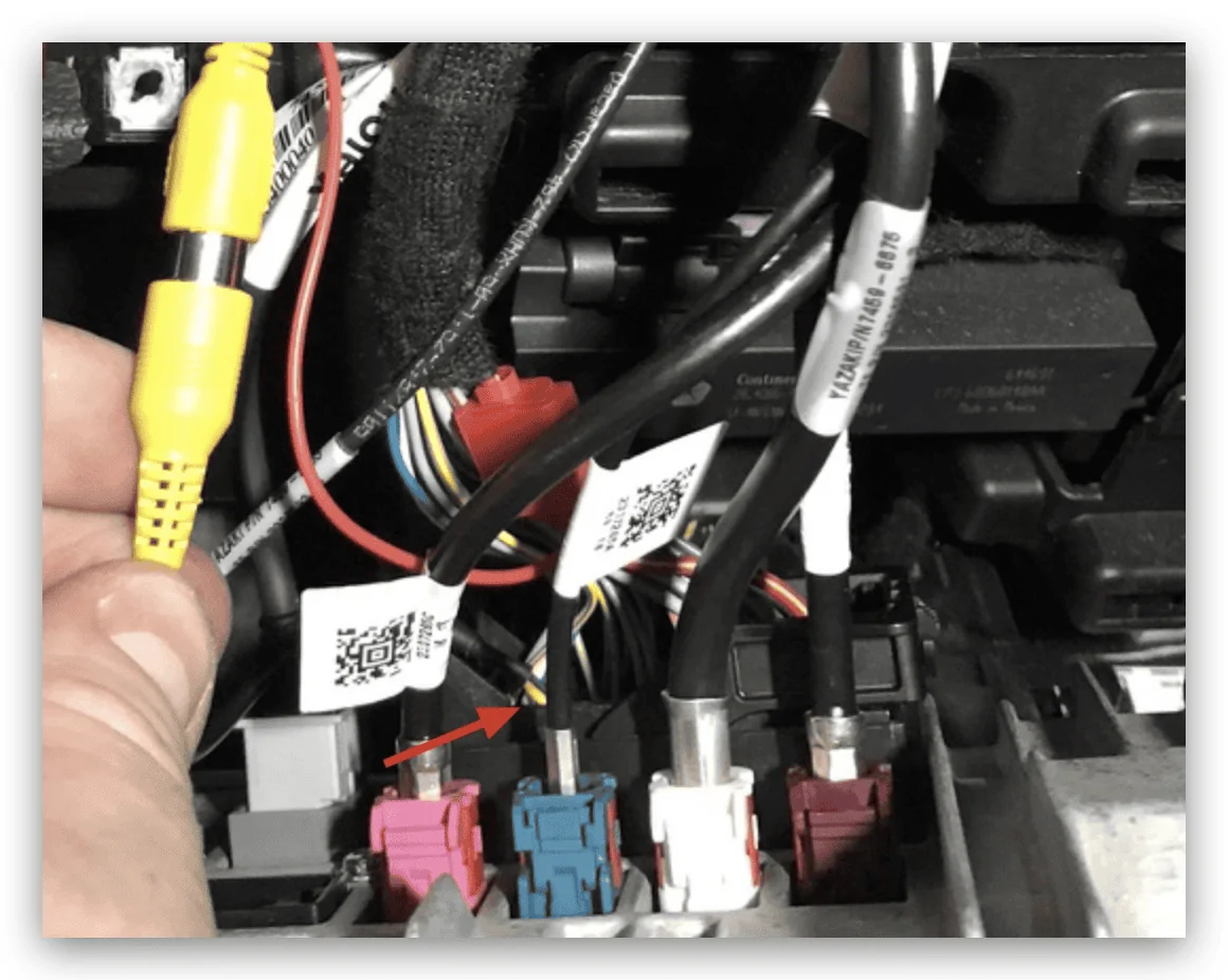

Thank you again. Can I pick your brain one more time? I'm looking at your pick on connecting the power source, it looks like you are in pin 44 not 52, would you mind circling the power source like you did in your last response?
Sure thing. Power source should be the larger red wire indicated below. Safest thing to do is to verify with a volt meter, but that's the one it was for me.
Jeep Wrangler JL Off-Road Camera (front facing) writeup upload_2018-11-28_15-22-46
If your camera is like mine and has the hot wire pigtailed off the RCA connector, just make sure you get a good connection. That wire for me was super thin, so I stripped it back and folded it over the insulation in order to get good contact and not have it fall out. I used a simple vampire connector to tie into the 12v source instead of trying to pull that pin and splice something in. For the ground, I just picked a bolt on the front end near the camera and grounded it there.
Jeep Wrangler JL Off-Road Camera (front facing) writeup upload_2018-11-28_15-26-35
You rock, thanks again for taking the time to help. Yes I bought the same camera you did based on your recommendation.

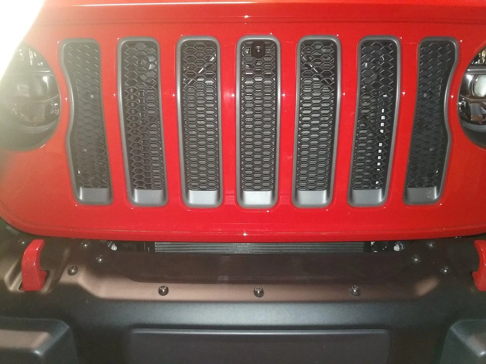

I used the same type of camera as @bwilliam79. For now I have it mounted high as possible in the center grille using a washer on the back to hold in place without drilling any holes, I may move it under the bumper later and having to drill a hole. The edge of the bumper cuts the view off a little, and the view cutoff is about 16 inches in front of the bumper at ground level, the higher off the ground level the shorter the view cutoff is.
https://www.amazon.com/gp/product/B07H852D49/ref=oh_aui_detailpage_o03_s00?ie=UTF8&psc=1
Jeep Wrangler JL Off-Road Camera (front facing) writeup camera
Jeep Wrangler JL Off-Road Camera (front facing) writeup vi
Sorry about my poor quality screen view picture.
