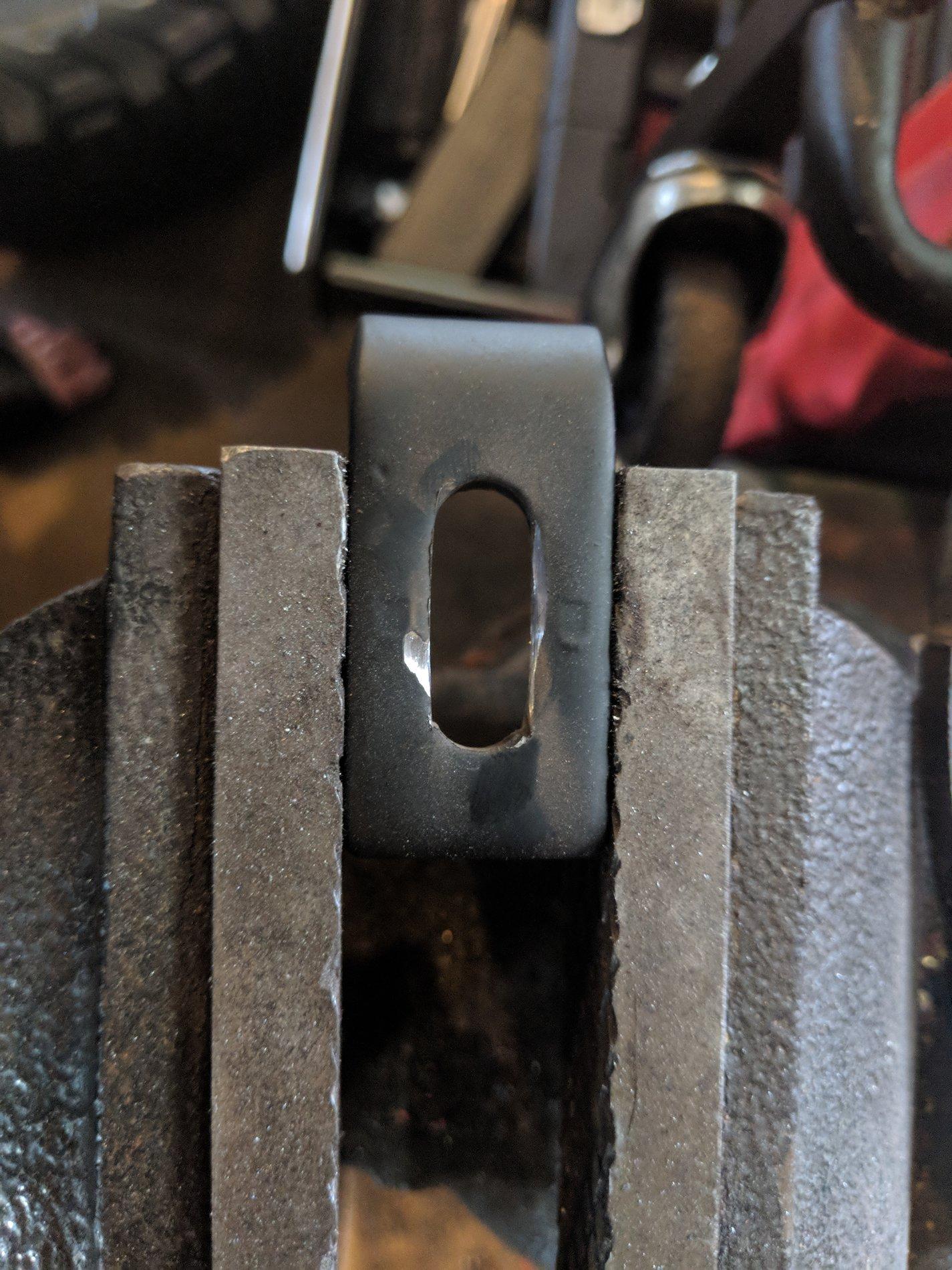

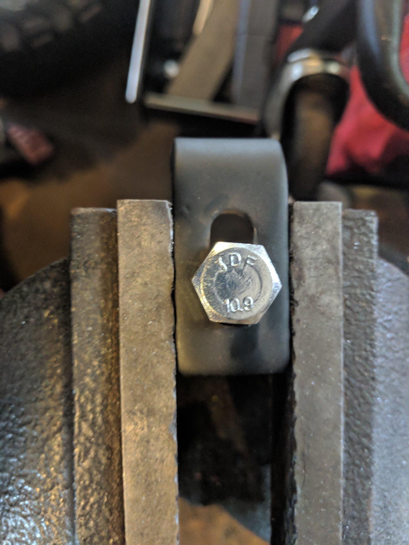

It nearly fits perfectly, the only difference from the JK to the JL is the bolt size for tailgate but $8 of new bolts and a quick grinding of one bracket with a Dremel fits perfectly. There are 3 bolts in the kit for the hinges that are not needed all the rest of the bolts in the are used.

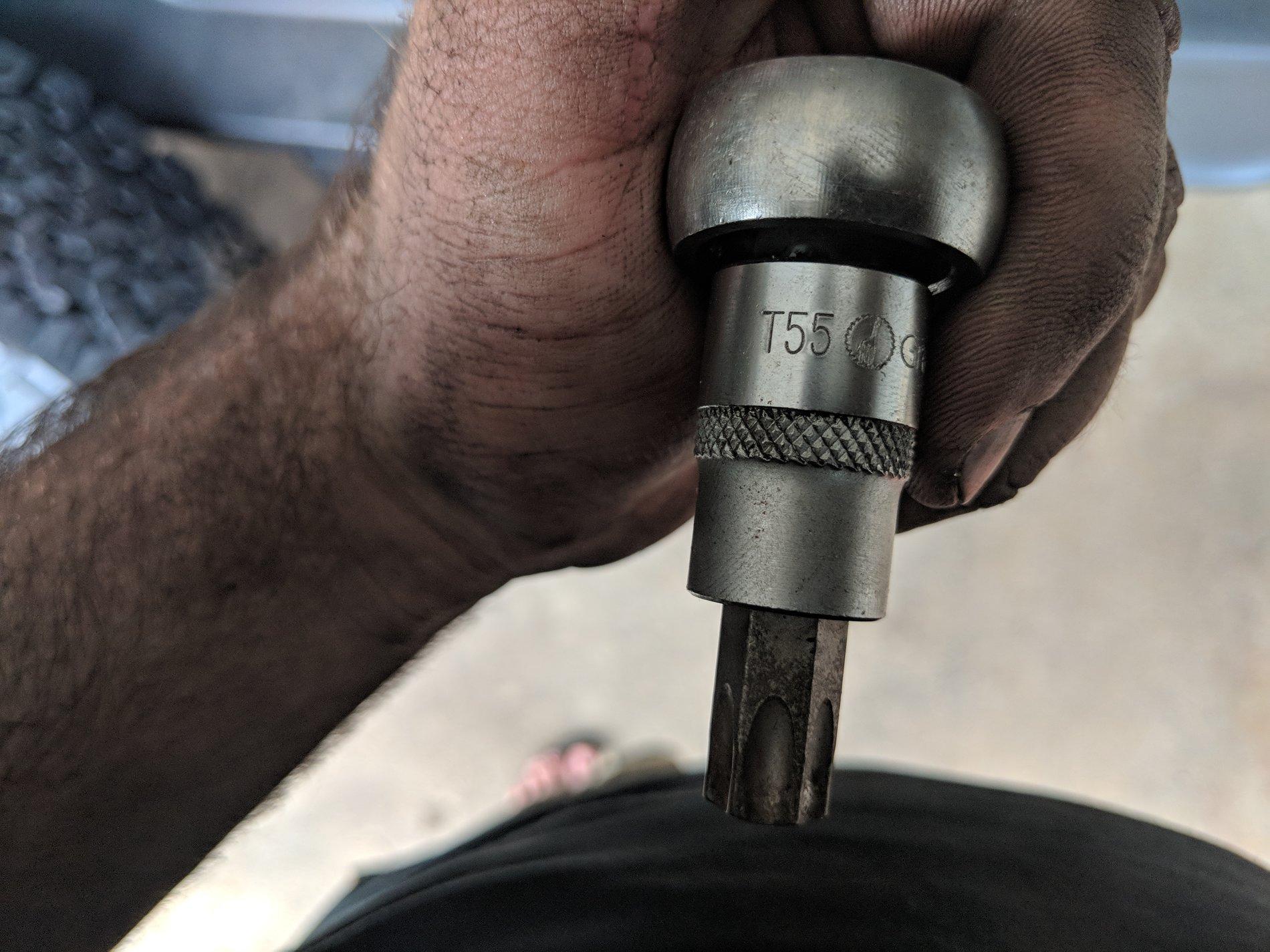

  • T55 torx bit

  • Dremel or anything to widen a slotted hole

  • 3 M10x70 1.50 pitch bolts
  • 6 M10 washer

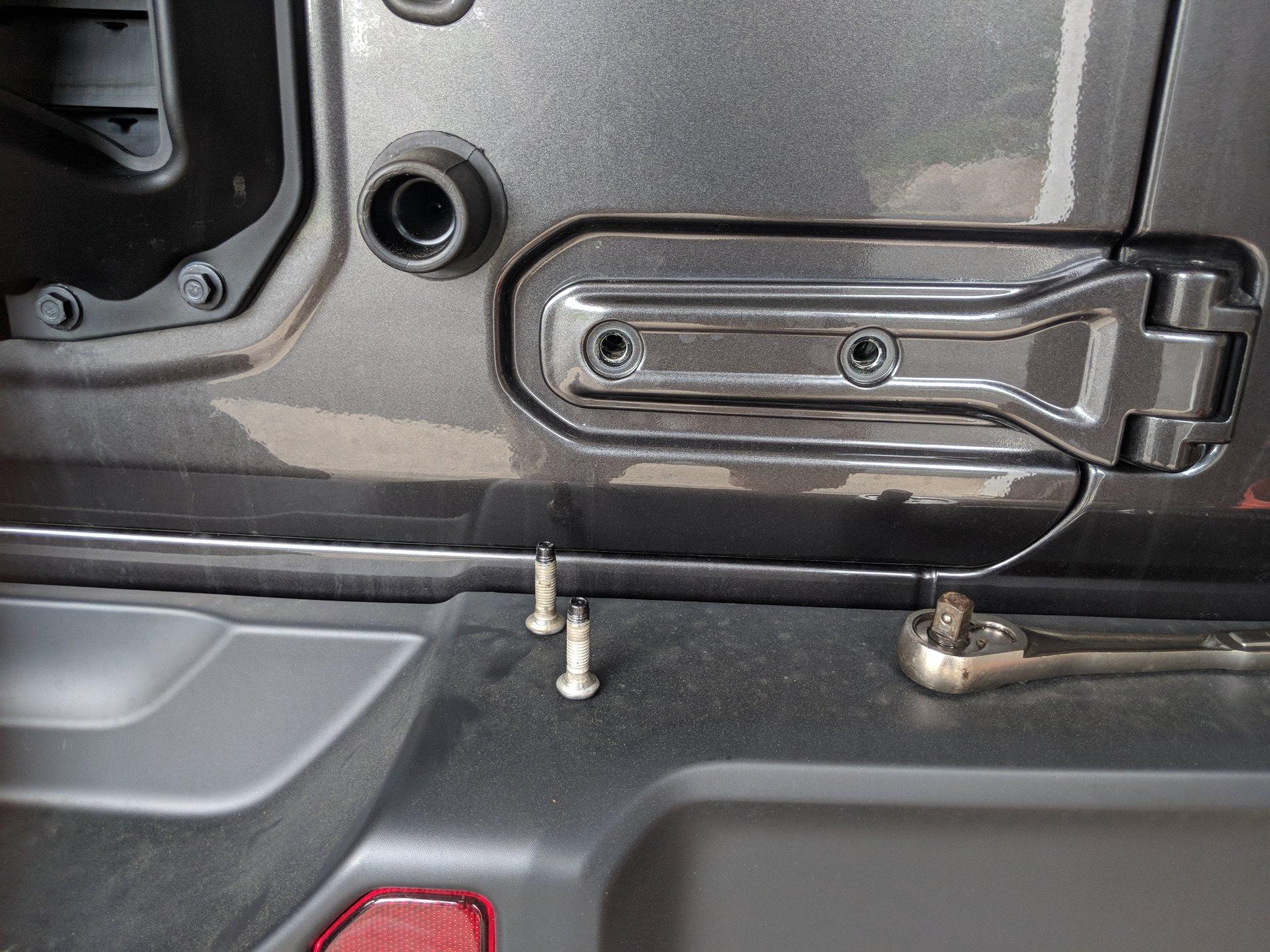

  1. Use T55 torx to remove the bottom two hinge bolts
  2. Take the base plate 2 bolts and 4 washers and bolt the base plate on I used a electrical tape on the back side of the washer touching the hinge to protect the paint
  3. Take the L bracket and widen the slotted hole to fit the new bolt, I used a Dremel

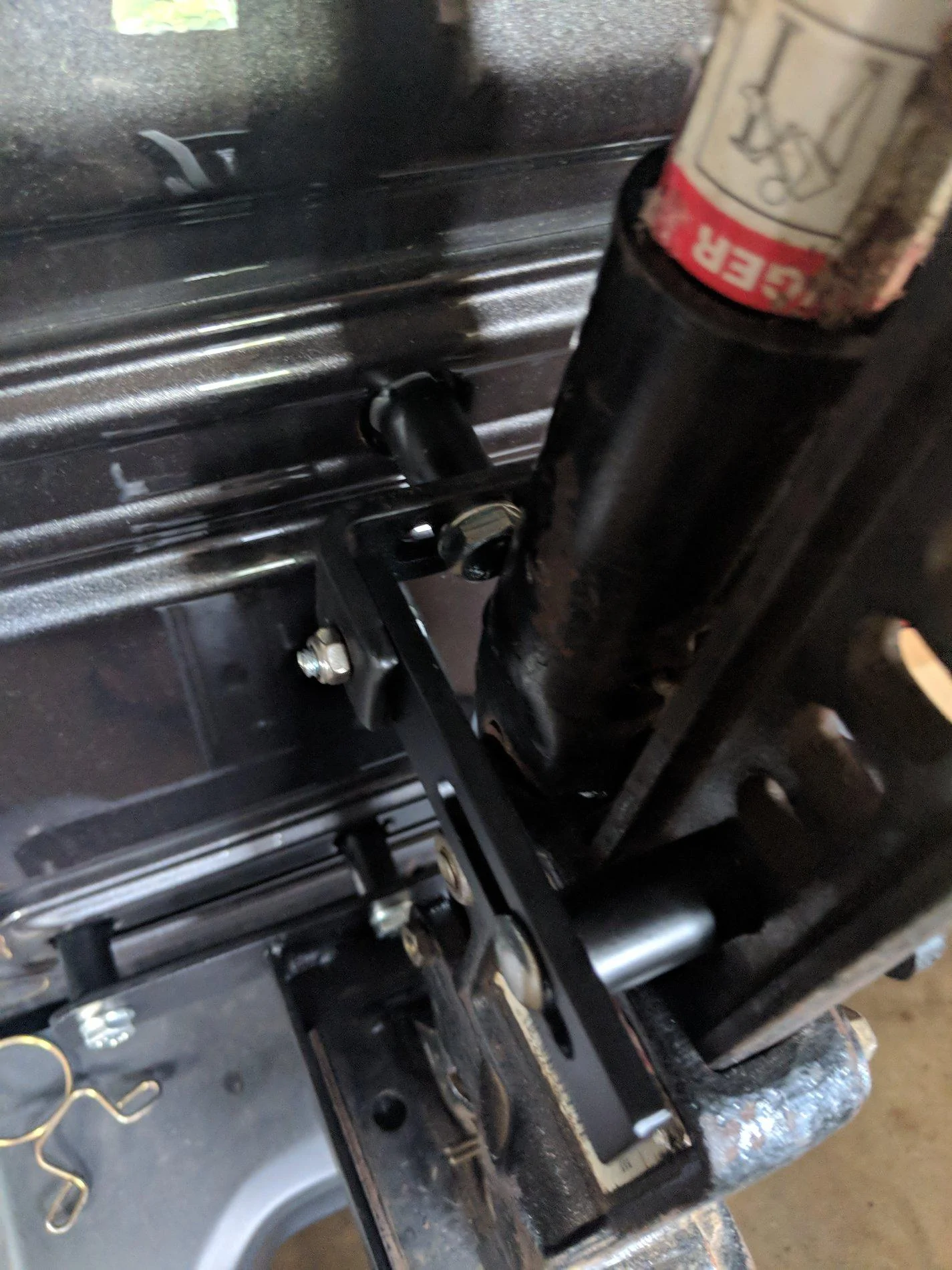

  5. Bolt loosely on the L to the bracket using a spacer from the kit and the last M10 bolt and last 2 washer
  6. Bolt on the extension piece with the hardware from the kit

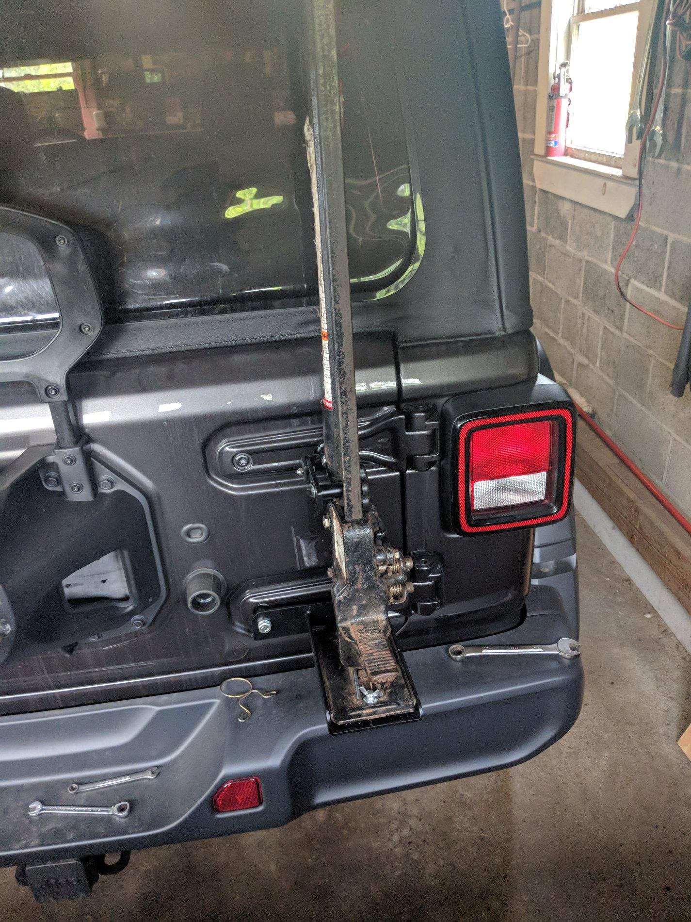

  7. Put HiLift on the base plate

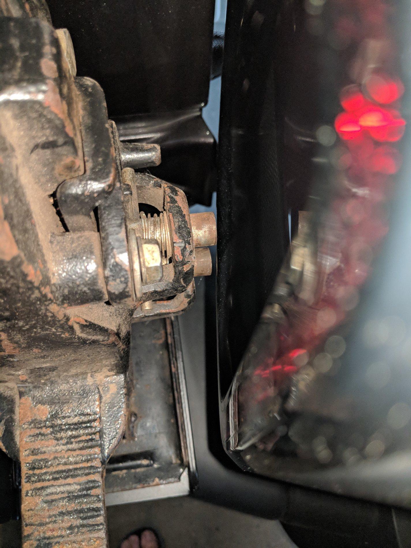

  8. Using the carriage bolt from the kit plus the other spacer and knob from the kit, but the bolt through a hole in the HiLift
  9. Attach the two wing nuts and some washers to attach the bottom of the HiLift to the base plate
  10. Tighten the bolt on the top hinge
There is a slight clearance issue with the jack and the tail light if you push the tailgate past the last detent.
