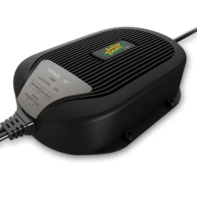

Any suggestions for Battery maintainer/tender ?
Here is one I looked up.
DBT022-0258-DL-WH Battery Tender 5 amp Automatic Battery Charger & Maintainer
Jeep Wrangler JL OEM Battery... 1094467
$119.99
QTY
Add to Cart
  • Shipping & Pickup Options
  • • Ship-to-Home from our Warehouse
  • • Pickup in Store
Call Garland Store for Availability
Change Pickup Store
Product Details
  • Designed with weather resistant casing to endure elements
  • Works with AGM, flooded, gel or lithium batteries
  • Adjustable voltage settings - 12 & 24 volts
  • Integrated mounting capabilities for installation on vehicles and equipment
