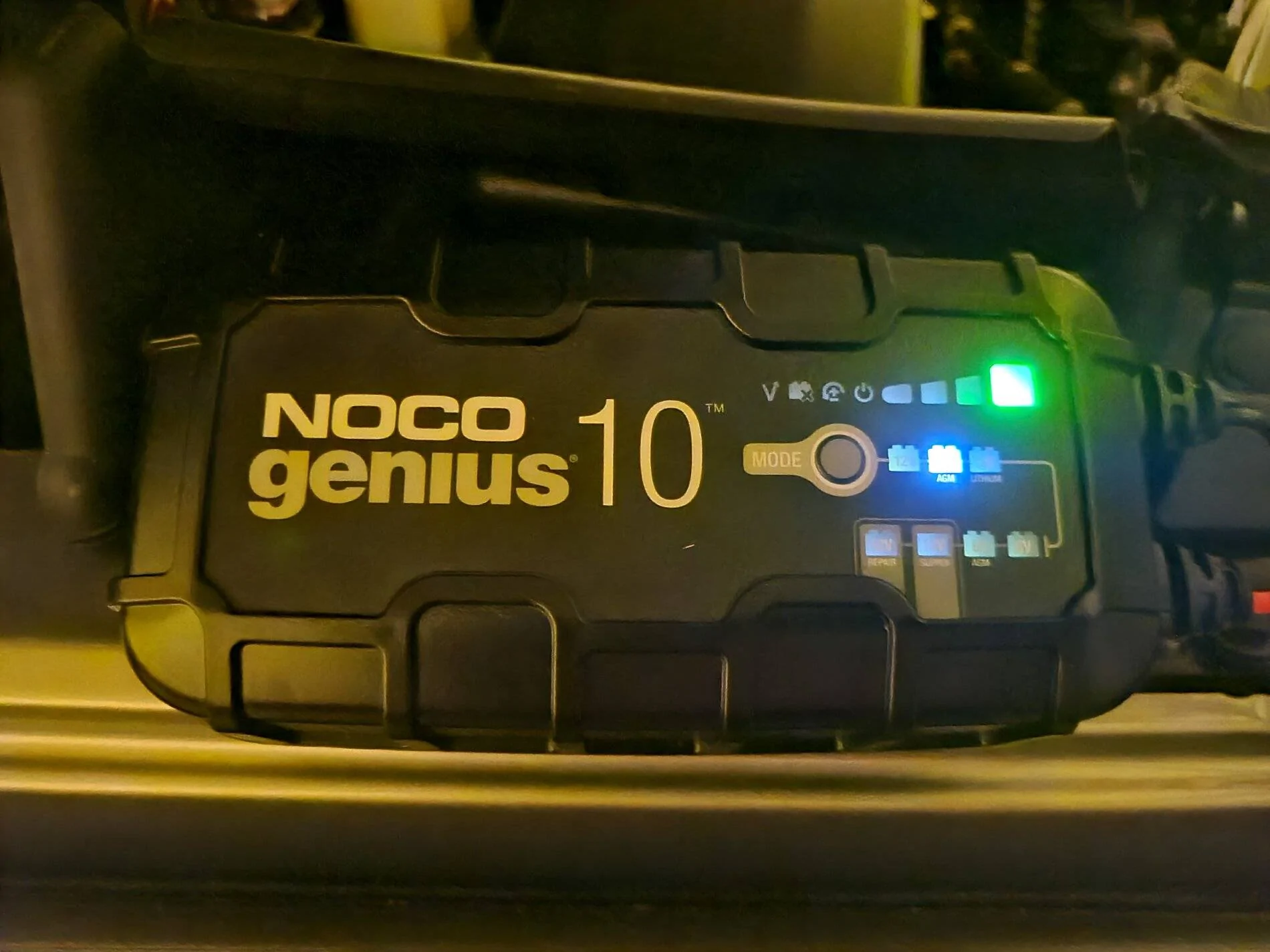

I do not have the Dual battery set-up like @WranglerMan runs. My Jeep is only few months old.
I do keep my Jeeps on the NOCO Genius 10 now. Picture shows fully charged and flashing Green is maintenance charging.
