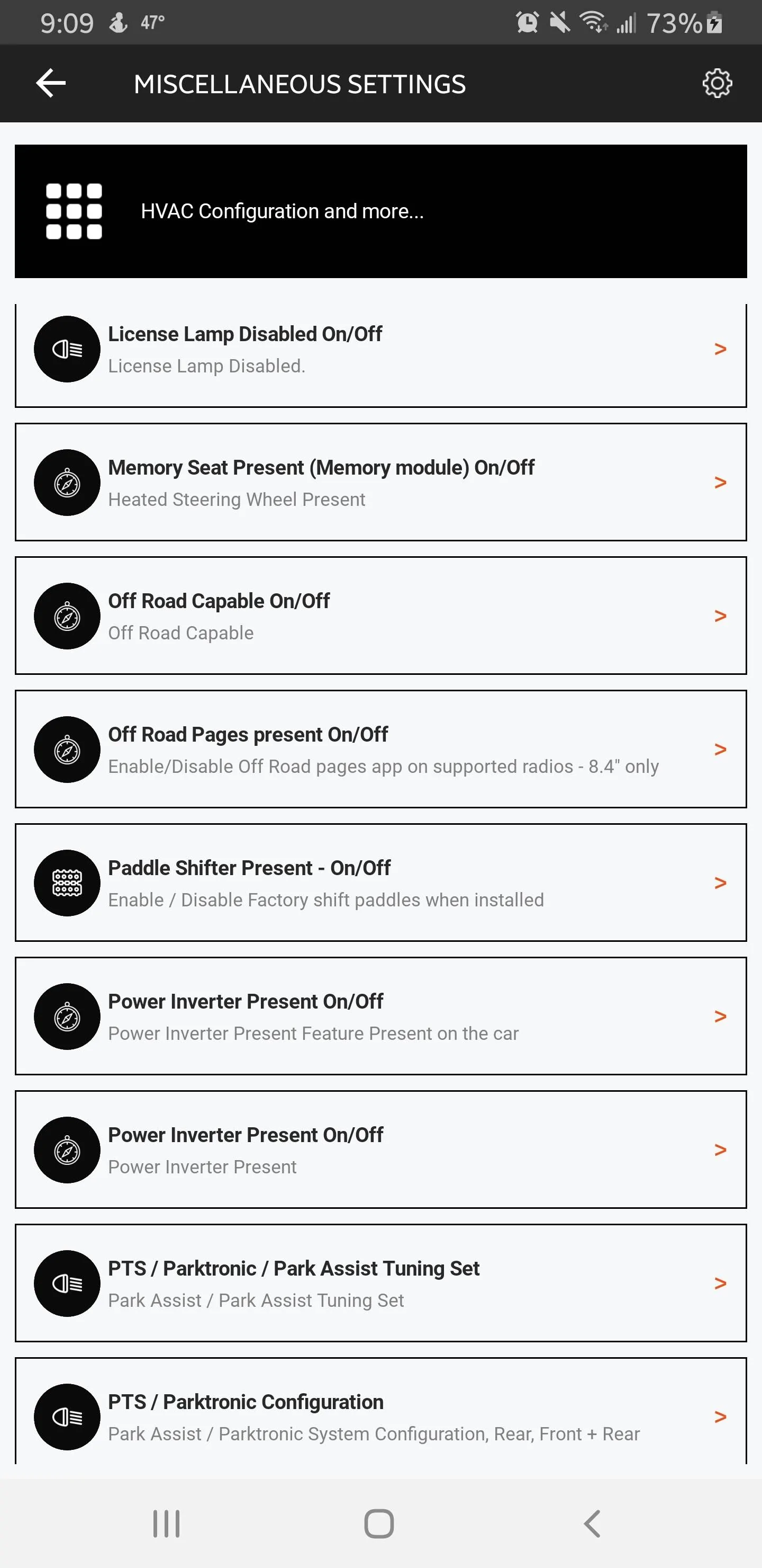

I need little help on activating ORP.
I switched from 7" to 8.4" and I have J-scan but I cannot find which menu to go to activate it. ><
Like J-scan but sometimes the procedure is a bit of pain.
THX
THX
Its under the miscellaneous settings. Once you activate you may have to wait a few hours for it to show up.
Jeep Wrangler JL OBD JSCAN - Off Road Pages Screenshot_20221012-210903_OBD JScan
itsooh
Oct 7, 2020
78
NJ
2014 BMW335i, 2021 JLU Rubicon
Great! Thank you!!
