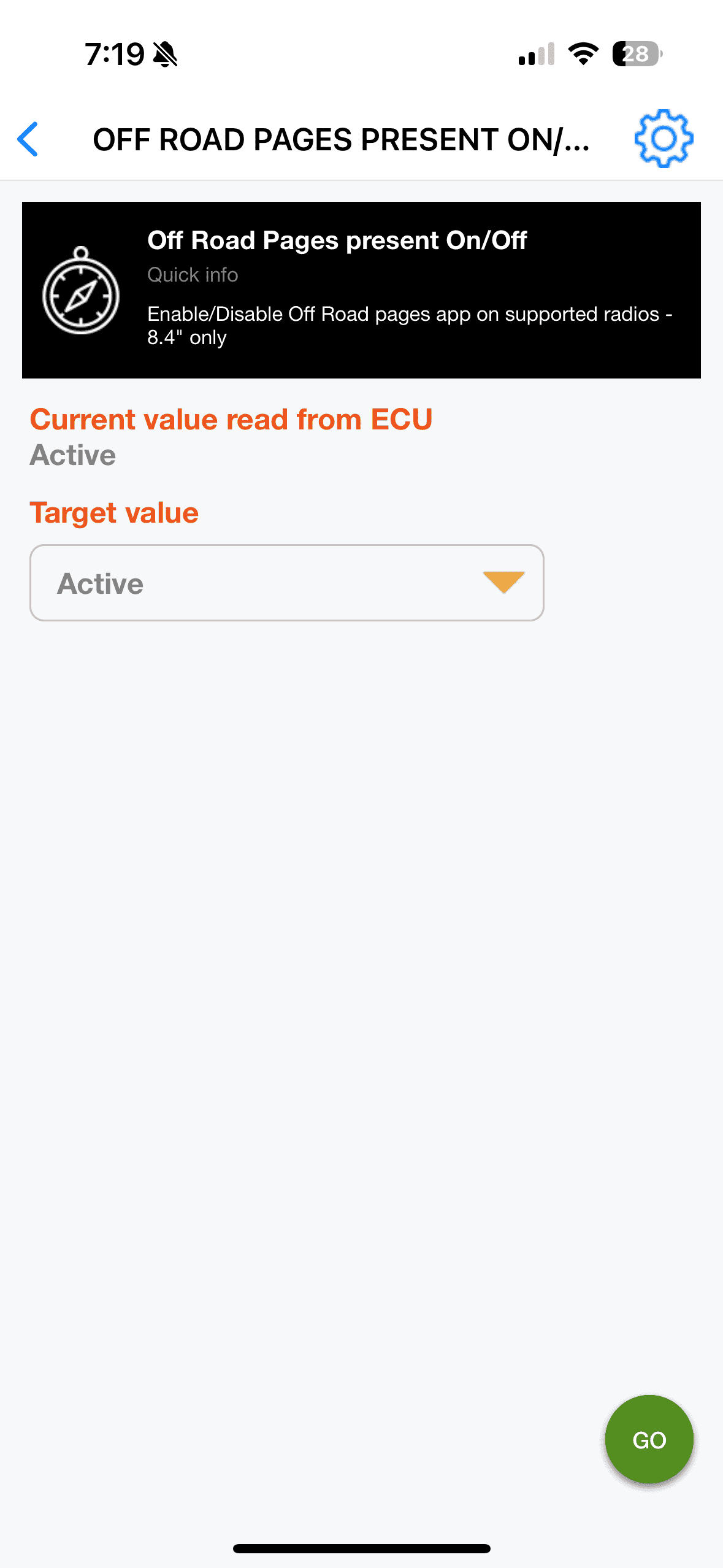

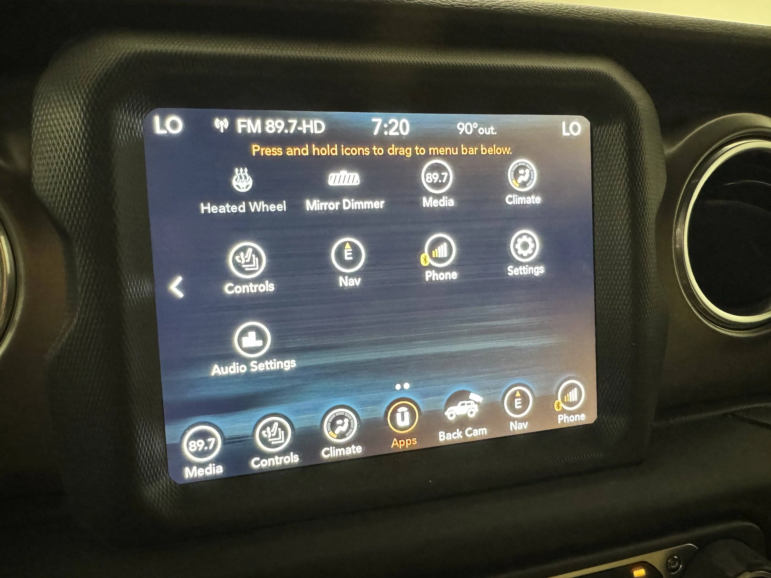

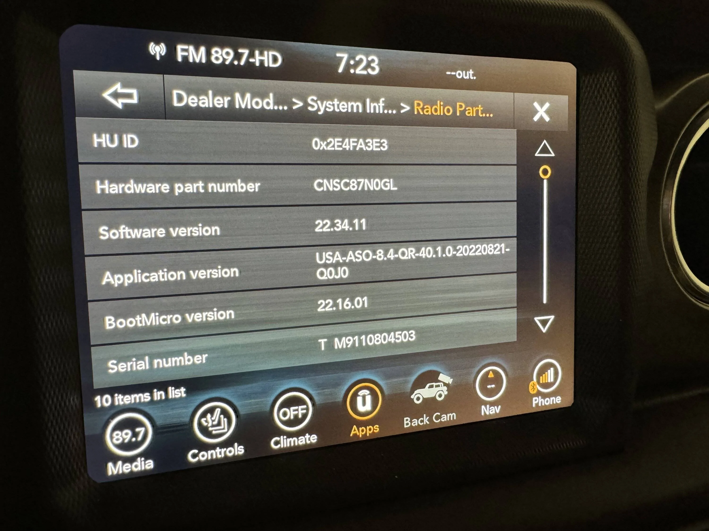

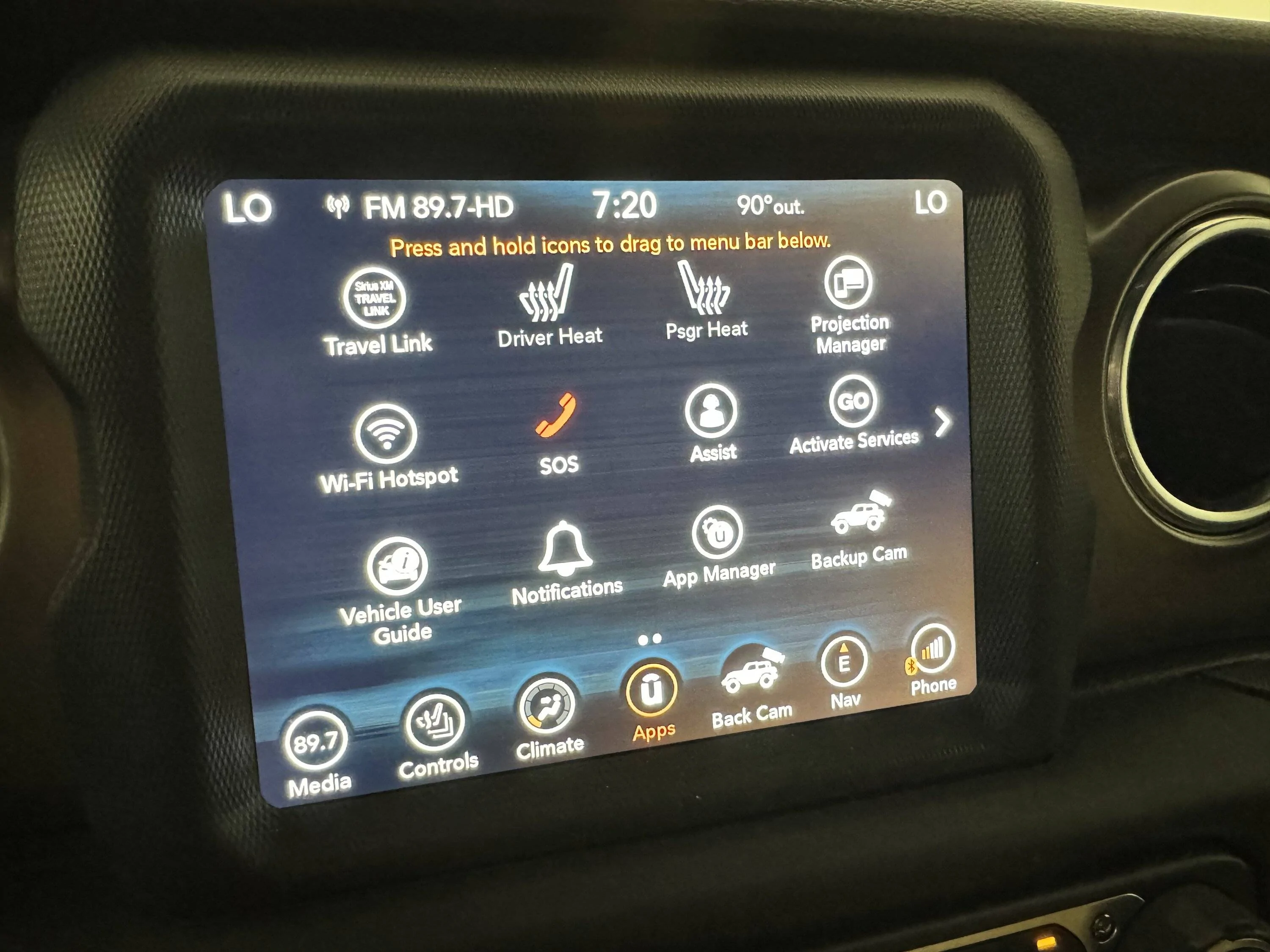

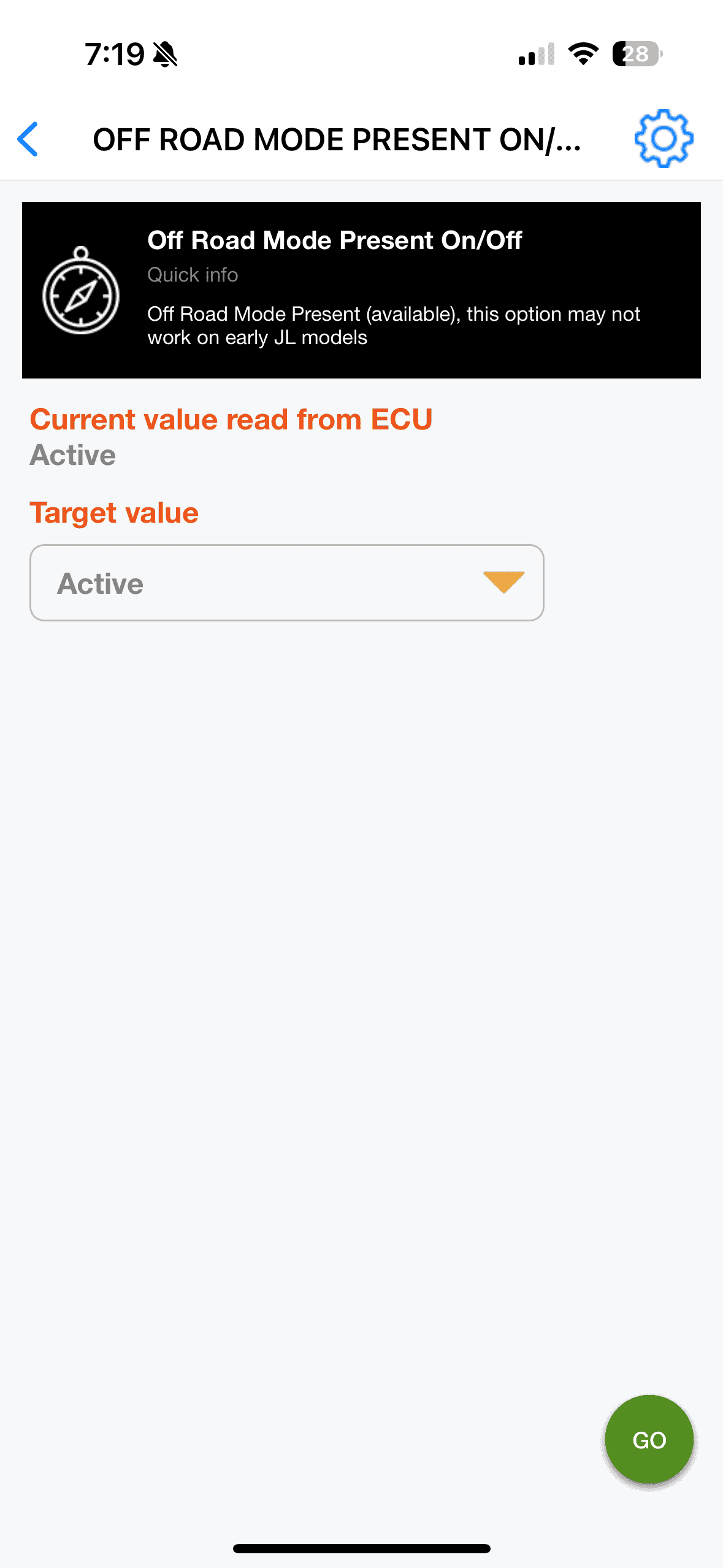

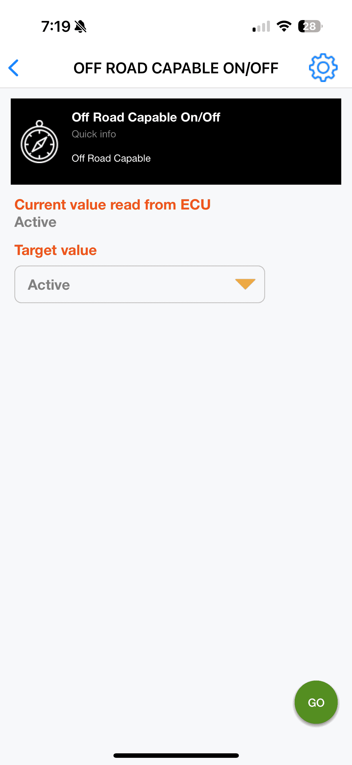

My 2018 JLUR that I own since new, has never shown the offroad pages on my stock 8.4" headunit. I recently updated the firmware, and used JSCAN (with the ECRI security gateway bypass) to activate the following:
- Off Road Pages present On/Off (by the way, this item was already active in the ECU, so I set it up to inactive, then back to active)
- Off Road Mode Present On/Off (was inactive). Not sure what this one does.
- Off Road Capable On/Off (was inactive). Also not sure what this one does.
I did the restart all ECUs / all modules twice. No luck. The offroad pages won't show up. I have waited two weeks already since I did all of the above and nothing.
Any advise is appreciated.
