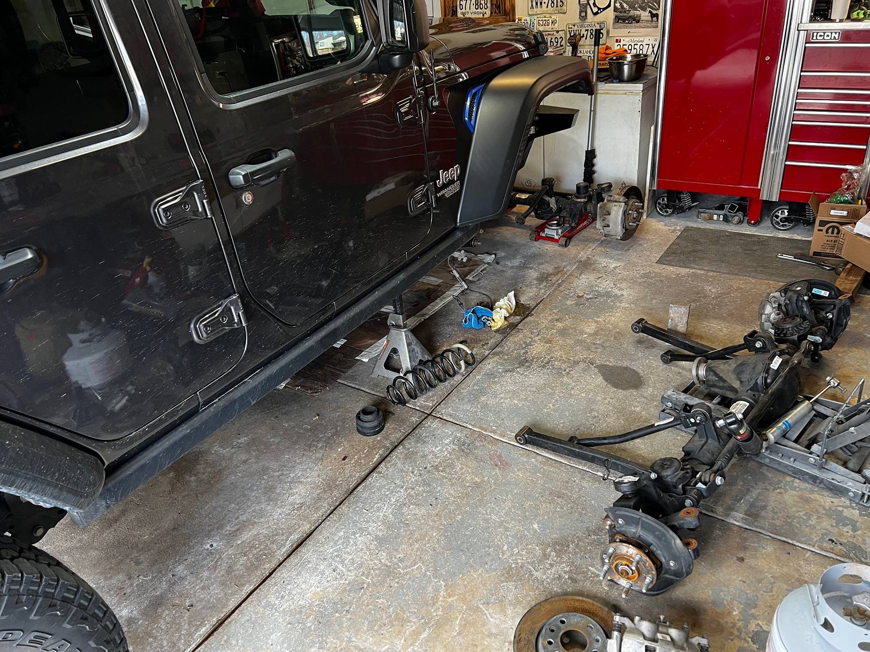

I have a 2018 JLU sport S with the FAD
I’m in the middle of installing 2022 JLUR looks like it has a FAD delete (capped or the 22 didn’t come with the )FAD?
Can I delete this with the Jscan I have?
Thanks!
Jeep Wrangler JL Help with OBD Jscan and FAD delete IMG_0910

Yes, just tell jscan no FAD and change gear ratio. if have factory Aux switch can tie lockers into that or even add the lasfit aux switch bank. I did and can know lock front and rear at any speed or force to be in 4 low.
