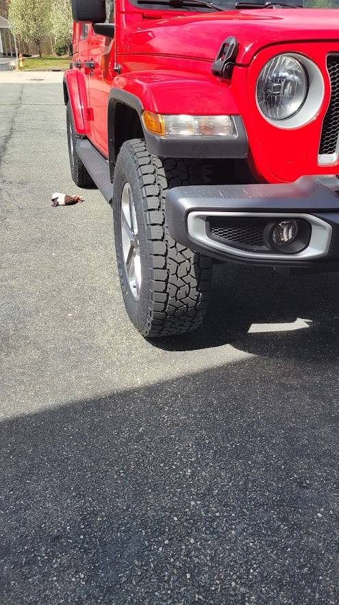

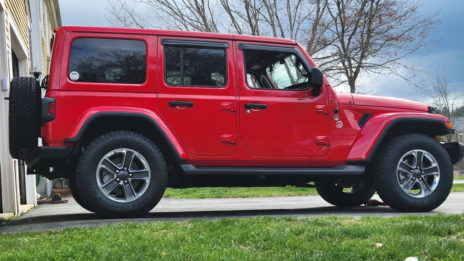

just put toyo open country A/T 265/70/18 on my daily driver as it also is a pavement pounder.

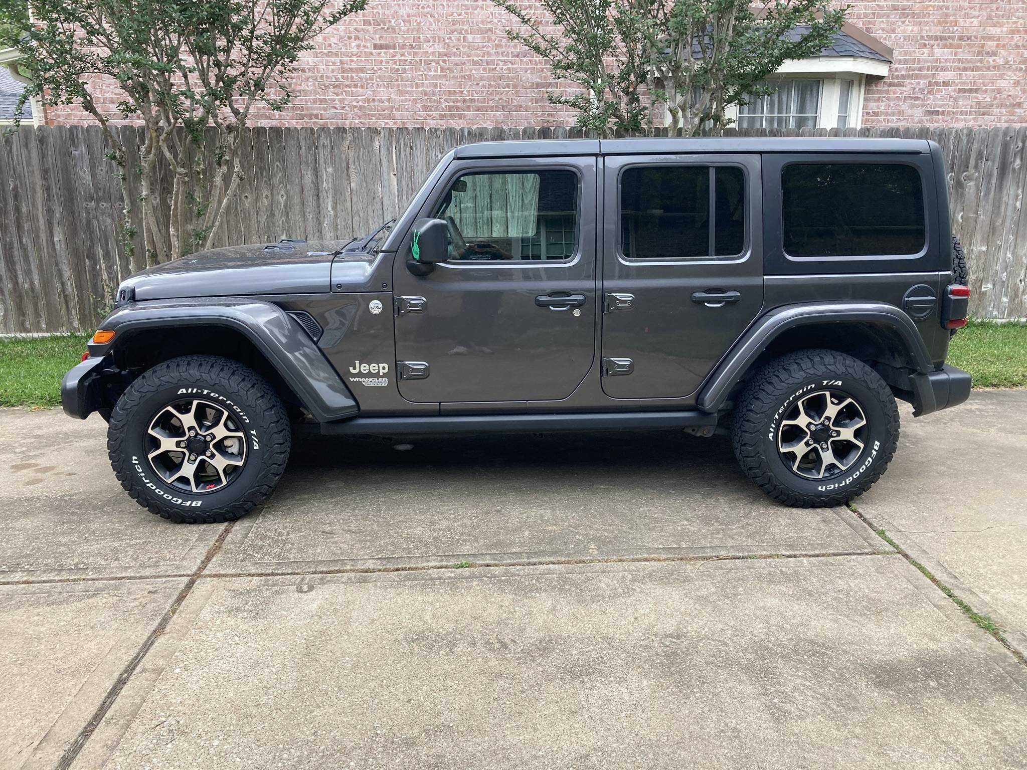

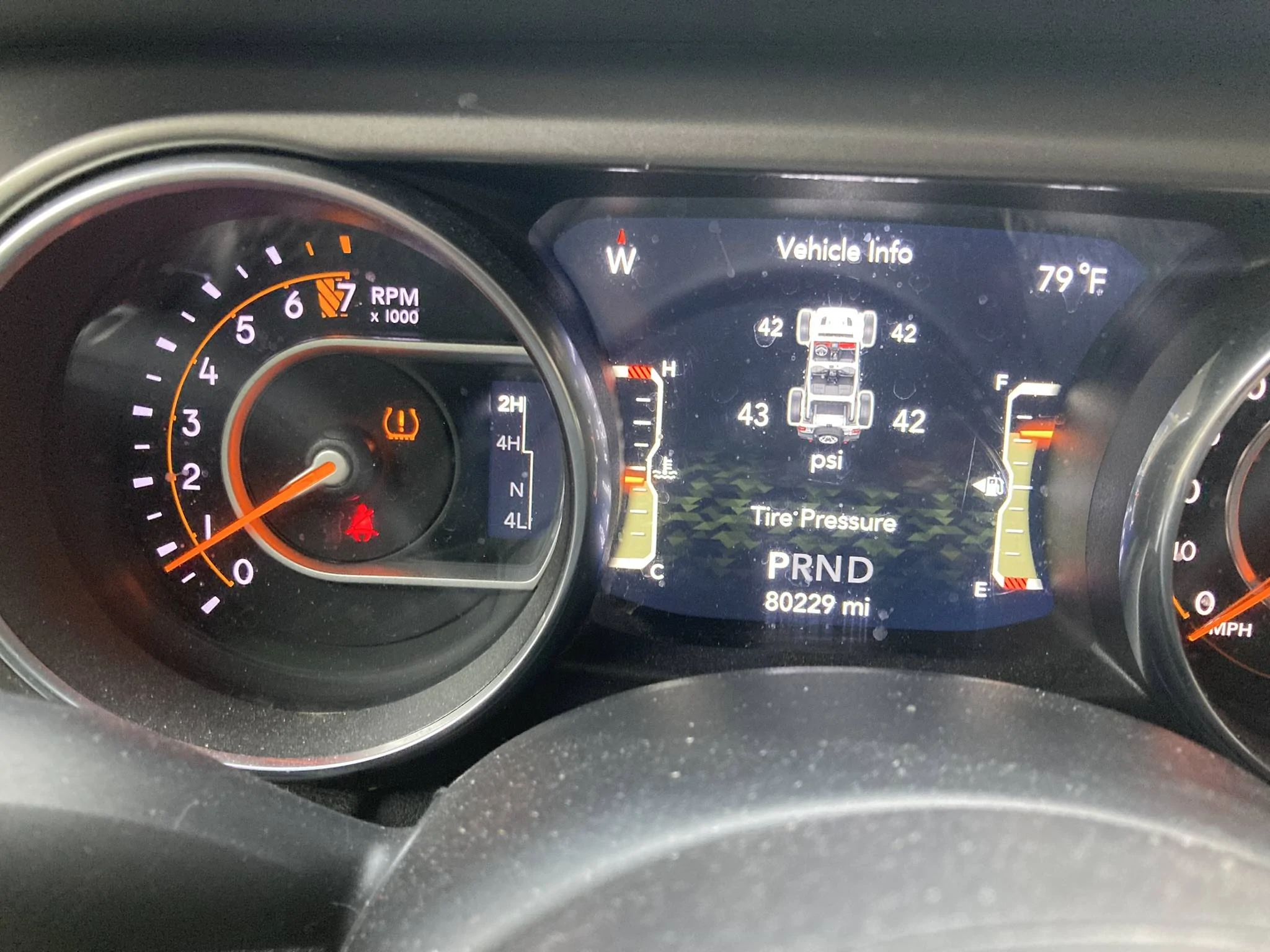

So she is happy. Now just need to figure out why TPMS light is flashing yet the pressures are being displayed correctly. All new sensors installed with tires.
265/70R17 on a 2018 Sport with Rubicon fender flares, no lift. Tire wheel combination weighs 75 lbs. Jeep sits 1” higher than stock 245/75R17 Bridgestone Dueler. The online tire size calculator told me they would be equal height but that was wrong.
Try airing the tires down to 35 PSI and see if it goes out. They aired them to the max on the sidewalls, not what the Jeep is rated for, which is about 37 PSI. Also, when your tires are aired down it will handle better and be closer to the same height is was with the 245s.

The door sticker says 36 but I dropped them to 38 and took a drive. The light will flash for about a min and then burn solid. If I shut the engine down then restart, the pattern repeats. Will ck with the tire store tomorrow.

Weird, since the pressure is showing on all of them.
Sounds like a disconnect somewhere in the system. My bet is a simple re learn will reset the system for you. Your local Discount Tire location can diagnose that for you at no charge.

I set all 5 tires to 36# then drove the highway for an hour plus a number of short trips and still have accurate readings on the Jeep screen but also still have a TPMS light flash for about a min then solid the entire time the Jeep is running. Talked to the tire store and then to Schrader who made the OEM sensors and got a part number in case I need to buy another set.

I purchased a set of 5 OEM sensors from Schroeder for $165 had Discount tire install them this morning for a cost of $40.00. As soon as I drove out of they lot all sensors funcioned as the should and light went out.
now when I got home and took out my torque wrench to check all the lugs (supposed to be 130lbs) I found 3 nuts hand tight, two of which are the locking lug nuts.
in conclusion I and happy this is all over but more attention needs to be paid to ensuring all the lug nuts get tightened to the correct torque.
