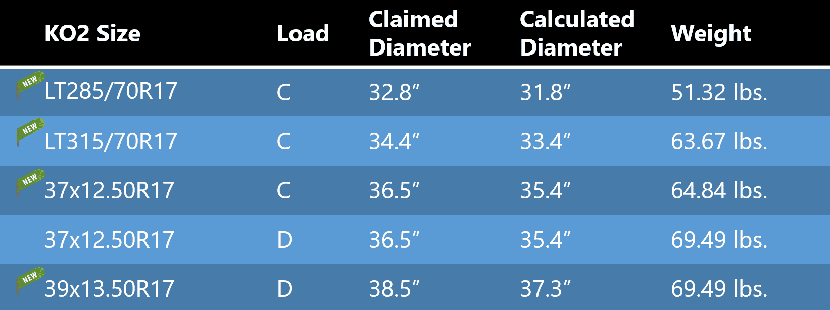

Here's a comparison chart on the KO2's from BFGoodrich site. The 285s and 315s are also marked "new" but I'm guessing it's a re-labelling exercise and the tires aren't materially different? 🤷‍♂️
Interestingly from a weight perspective it's pretty much a wash once you go bigger than the stock Rubicon 285s. It's hard to imagine between 315s and 39s there is only 9% weight difference. And the 39 and 37 weigh the same (both load D) but one is 2" taller and 1" wider. This all seems to challenge conventional wisdom. As more people get these new tires it'd be great to post their actual weight on here. :like:
[Edit: Included the calculated diameter based on manufacturer's revs/mile figure]

Definitely check & use the rot/mile rather than the published diameter for a more accurate size comparison. BFG'S published values are optimistic at best.
Size
285/70
Rev/MI
635
Diam(in)
31.8
35/12.560233.5
37/12.5 C56935.4
37/12.5 D56935.4
39/13.5 D54037.3

This is good info, but real measurements mounted on the Jeeps and compared to other tires, seems to indicate the KO2 are much smaller than the specs.
I was fully prepared for my 37 KO2s to measure Ëś35" under the Jeep, but I was not prepared for the 34" that I got. For the road it is great. For the offroading that I do (most friends on true 37s and up) it is lacking.

Your comment had me curious so I just went outside and measured my stock Ko2s (285/70) and they do indeed seem to measure 31.8 as the rev/mile chart indicates. That makes me hopeful that when my 37s arrive, they too will match the 35.4 listed on the chart.
