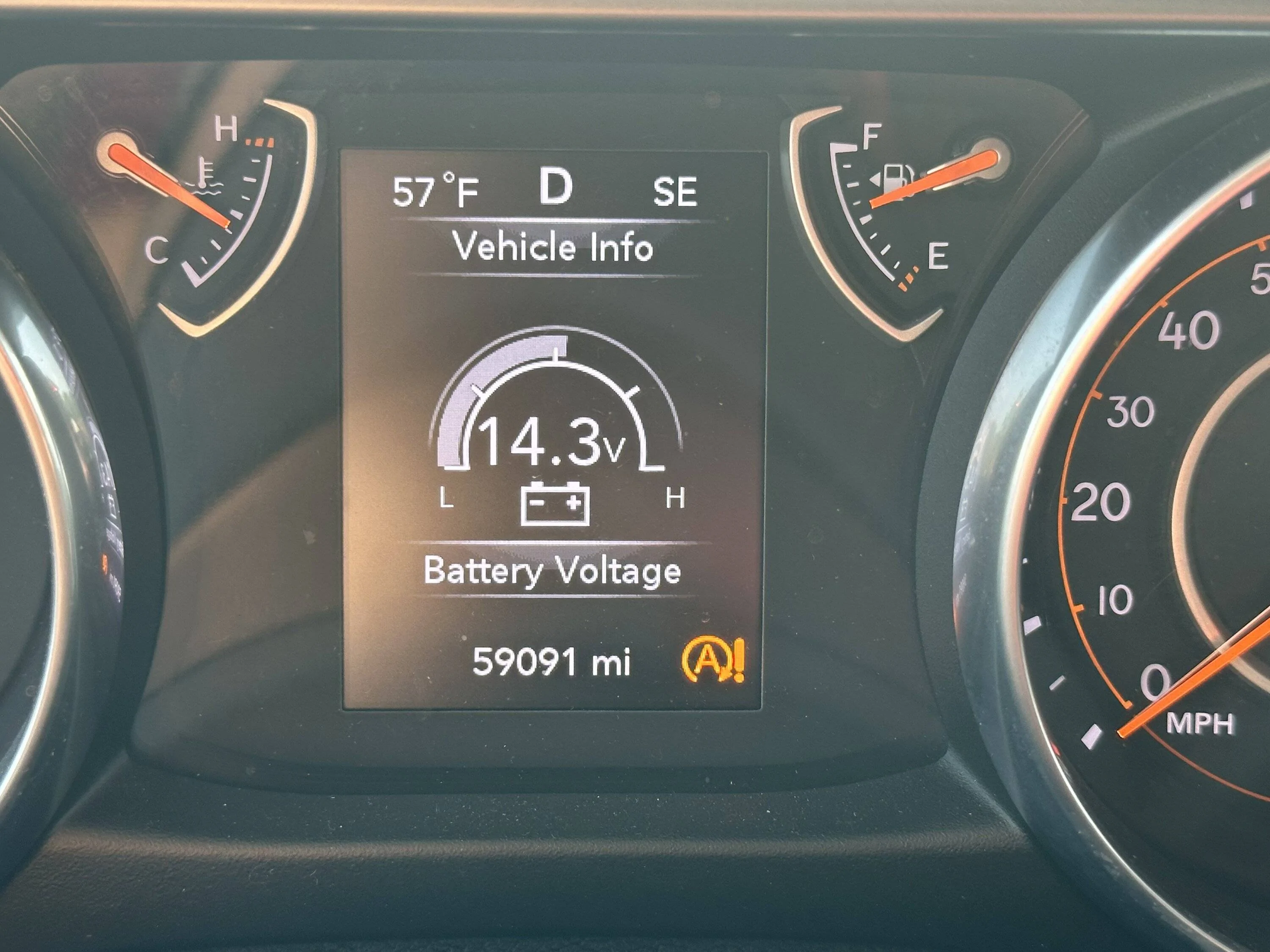

Also, Have both batteries checked. If you are still on the original battery it is probably time for a new one and bad batteries can cause all kinds of strange issues on these.
Thats my battery status

You were given three great pieces of advice on a 5 model years old (soon to be six model years old) Wrangler.
1) How old are your batteries? If older than two (2) years, you may want to replace them.
2)Open your fuse box and push everything in to make sure all fuses are making proper connection.
3) As Steph1 wrote - Disconnect, lube with WD-40 all and reconnect all ABS connectors.
Have you done anything that was suggested? This forum is a great learning tool for all Wrangler enthusiasts. You asked for help while questioning Jeep's reliability on a first year, 5 year old Wrangler with 59,000 miles on it. We'd like to learn from your experience.
