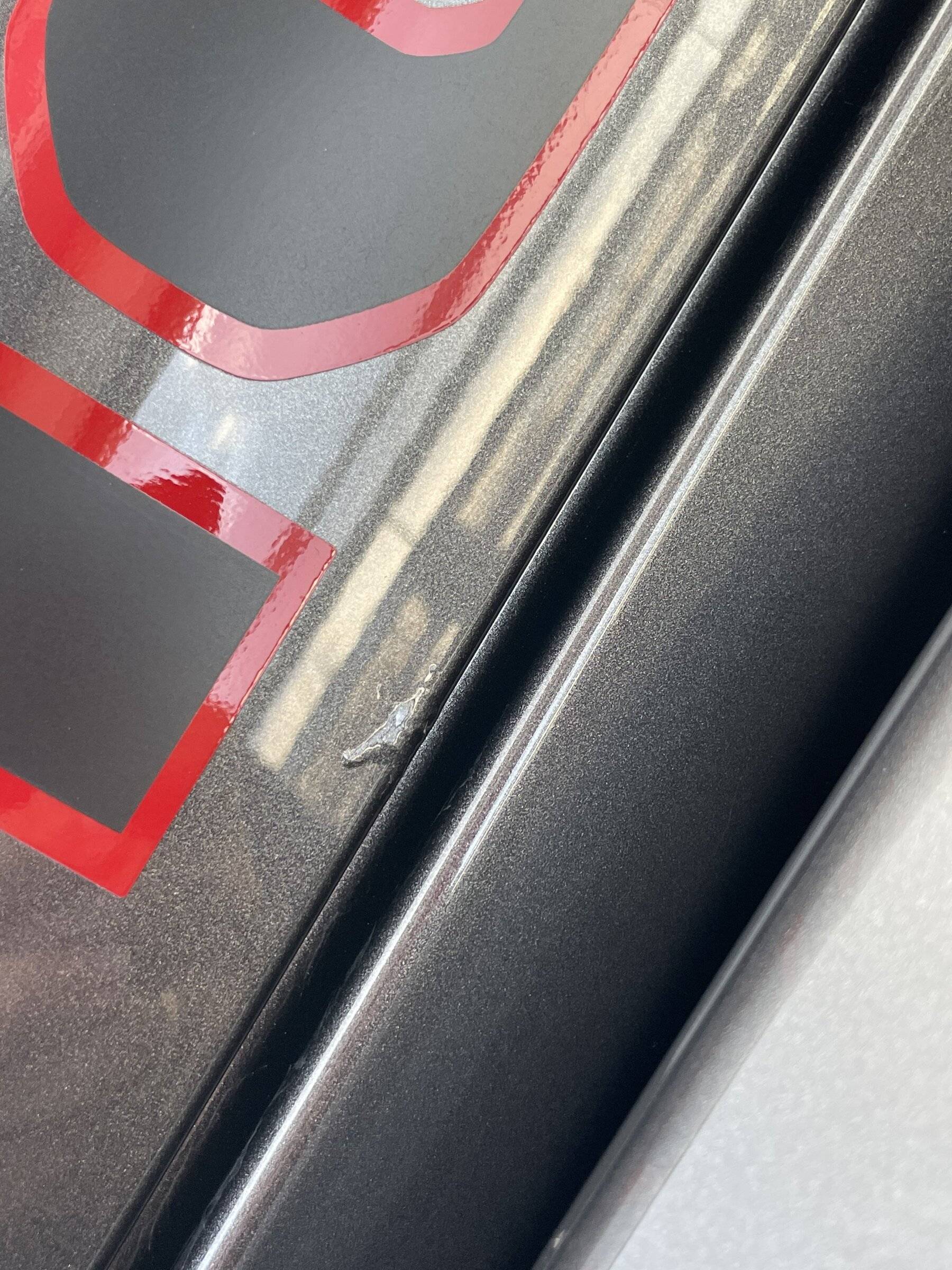

Hi i’ve noticed today a paint bumbber on my jeep wrangler on the left side of the driver !
Does anyone knows the treatment of this problem or have a problem like this and how to deal with it

Looks like under paint corrosion to me, I might be wrong, but if that is the case there is nothing you yourself can do about it. You will need to make a warranty claim to get it repaired.

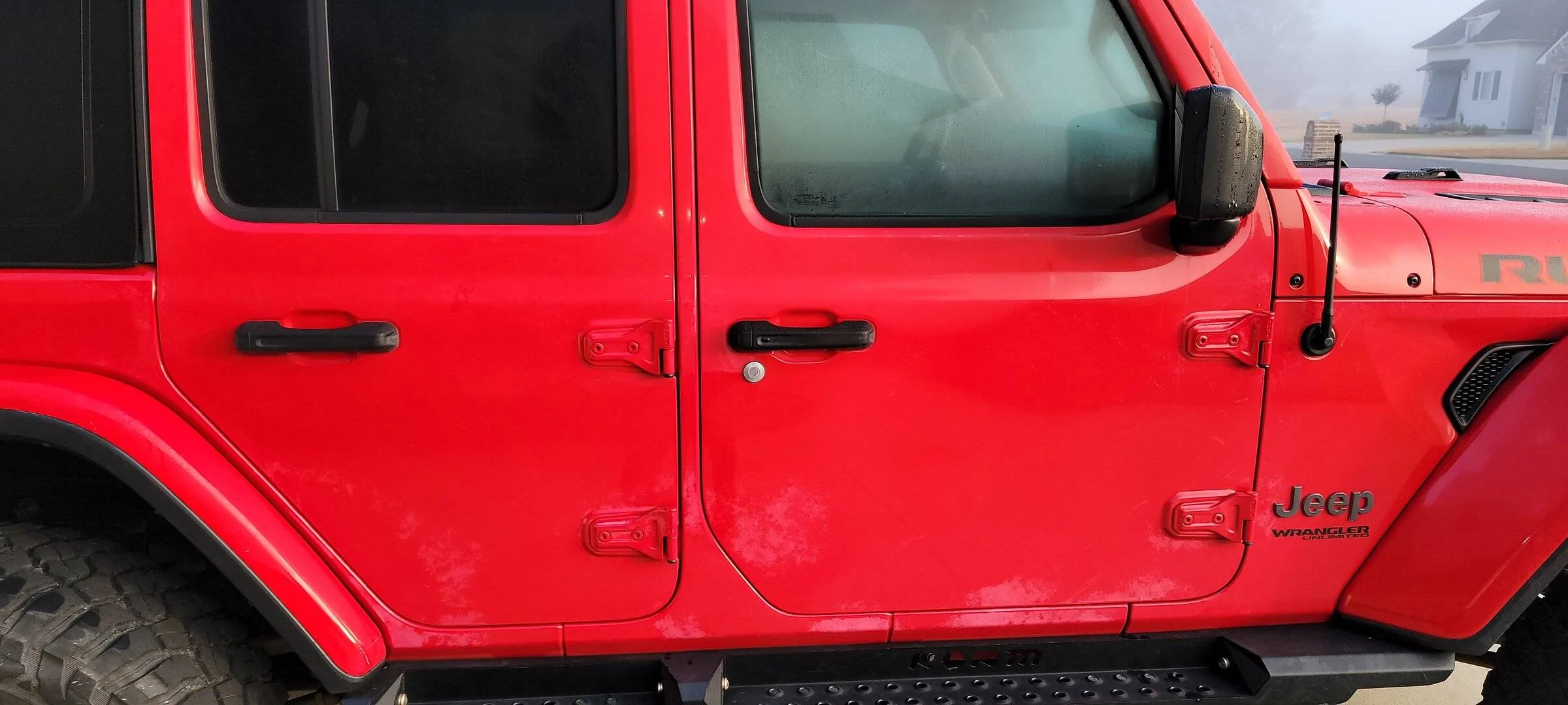

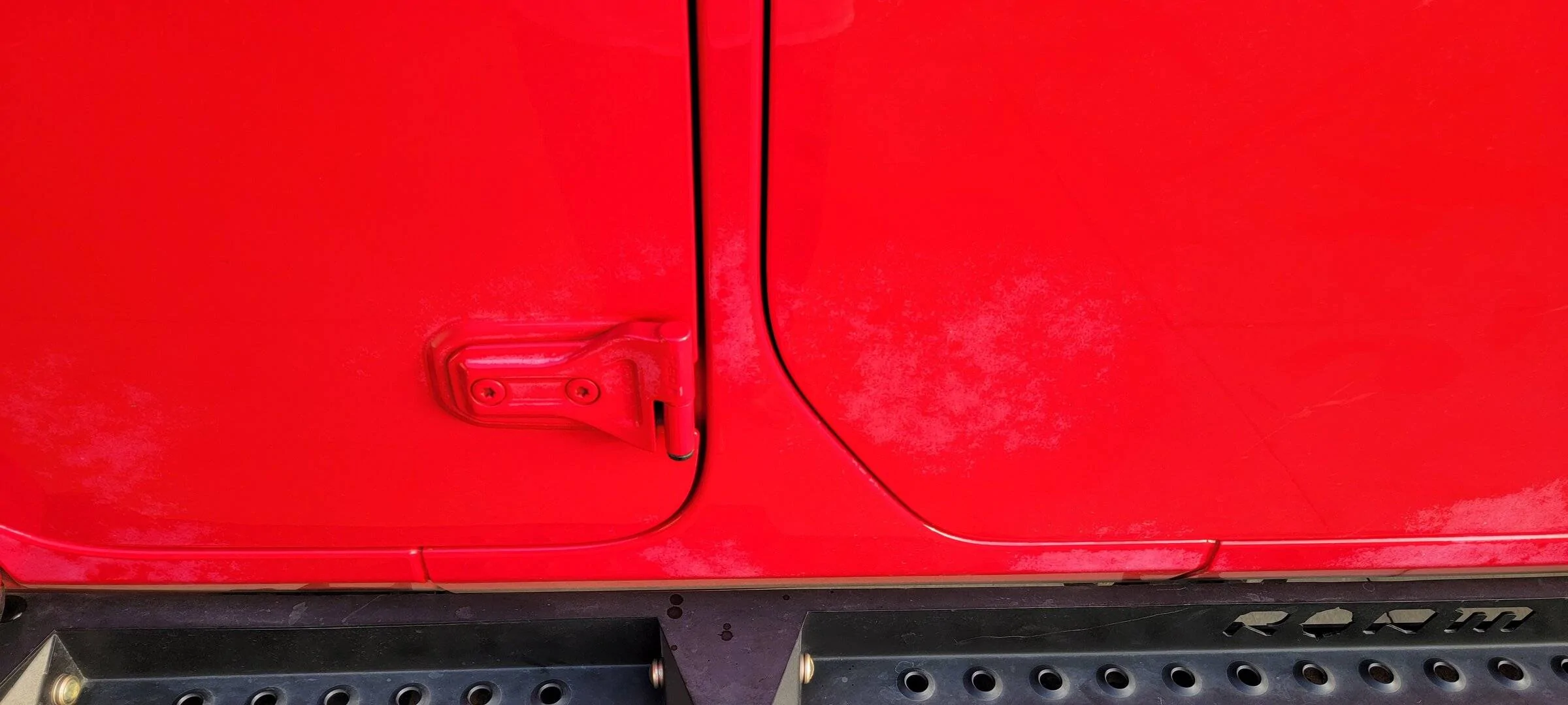

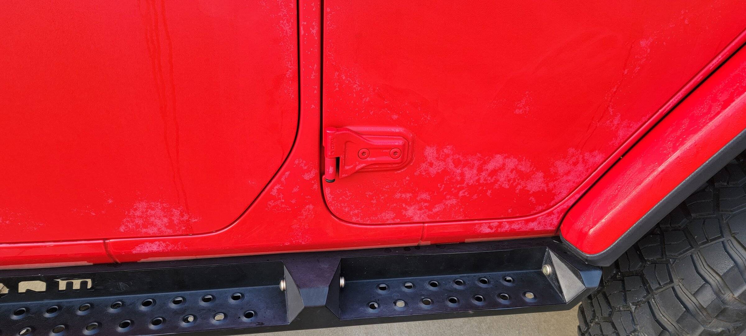

Had the same issue on my hood last year. Had to replace the hood due to corrosion. Now my entire jeep is doing it. Currently fighting them on getting it covered as they were quick to say my bumper to bumper was out just two weeks prior to it showing up. They had a guy come to look at it and he said it wasn't corrosion but when I went to pick the jeep up I found 3 spots on hinges and now more is showing in other places.
