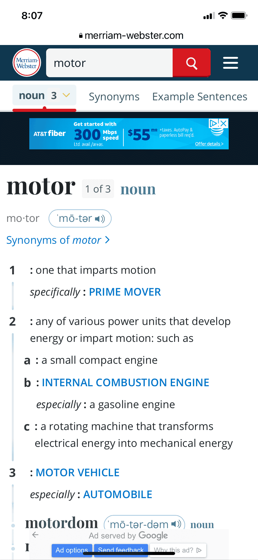

Also, unless you have a 4XE your Jeep does not have a motor. If you have the 3.6l fron 2016 you have an internal combustion engine. A motor runs off an external power source, say a battery like a 4EX. Your 3.6l generates it's own power. Sorry, that has always been a pet peeve of mine...
JS…
Jeep Wrangler JL New Motor ? 73CD9AC1-55ED-4F09-B9C1-419195BCDE60
