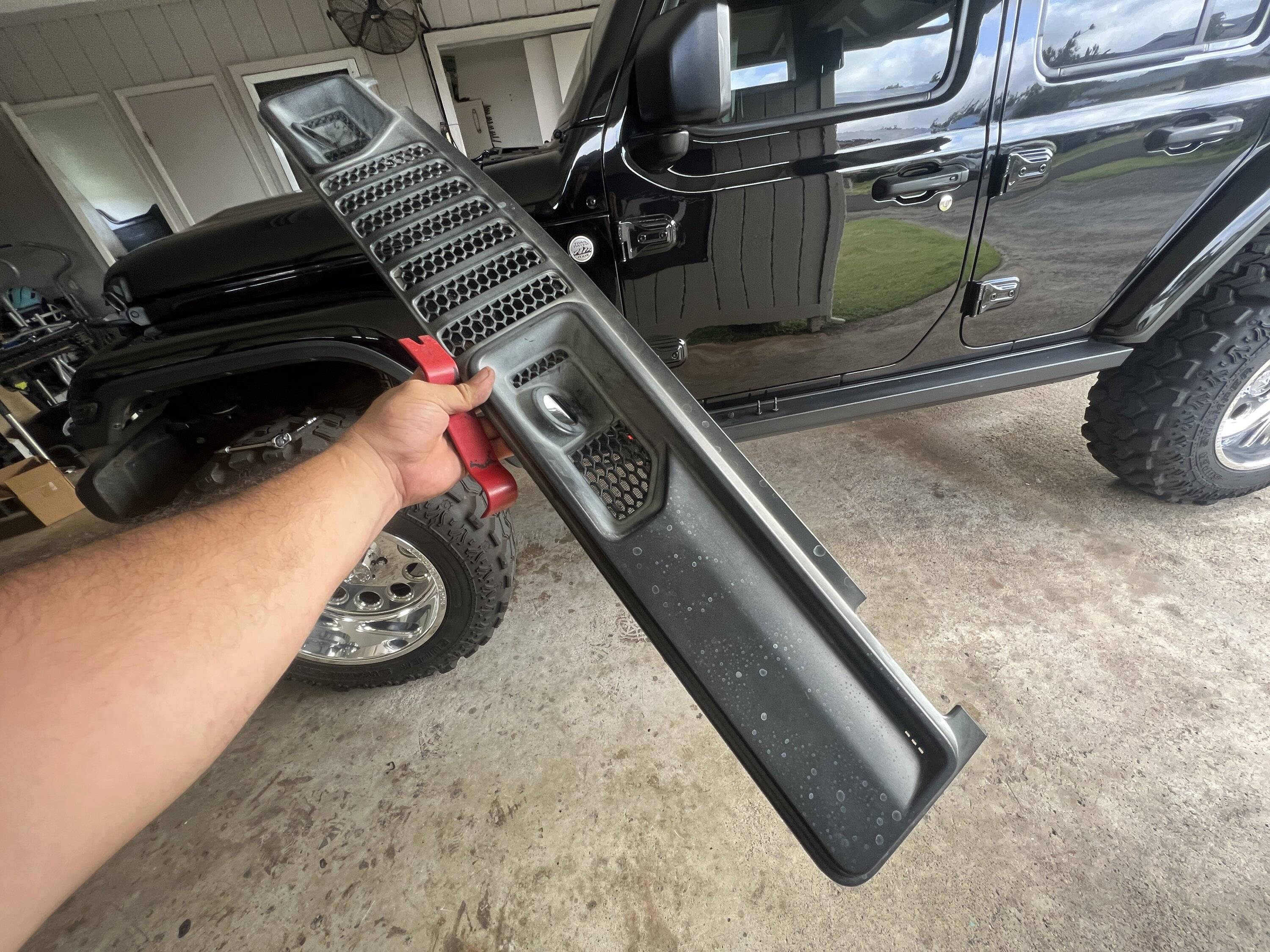

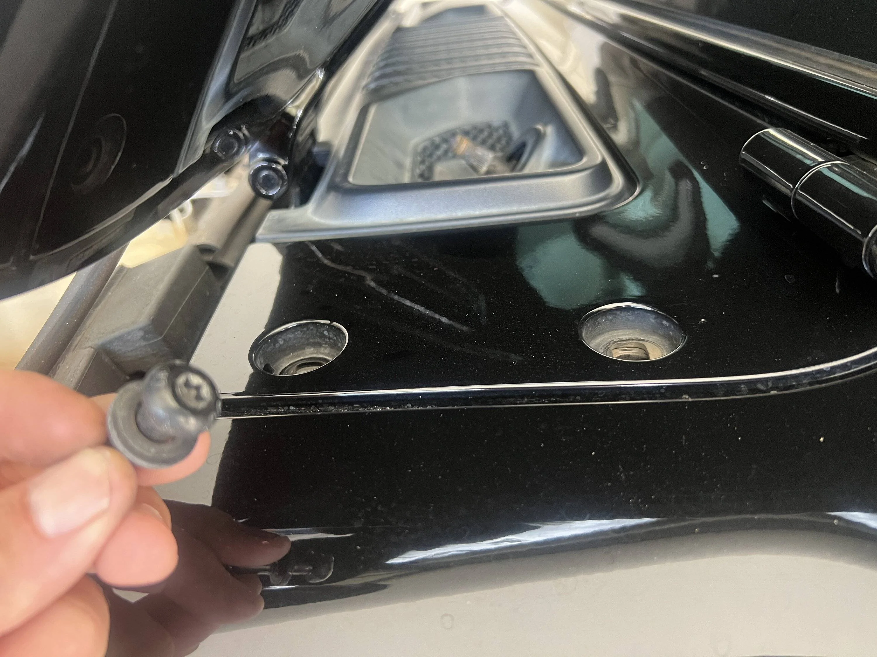

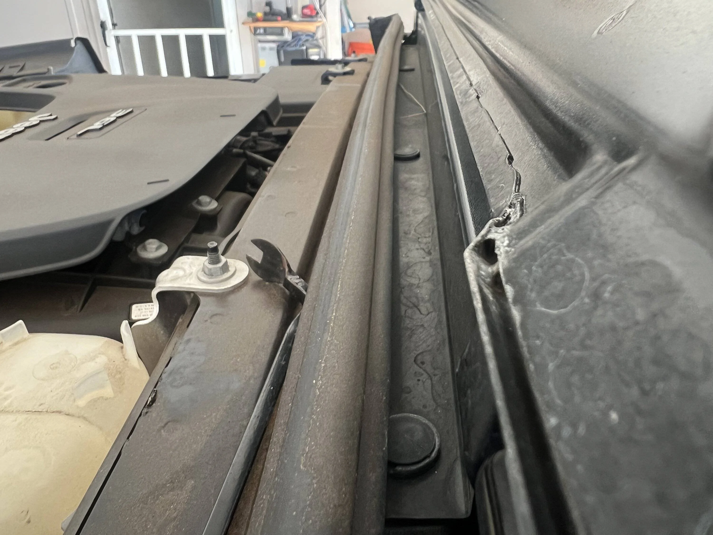

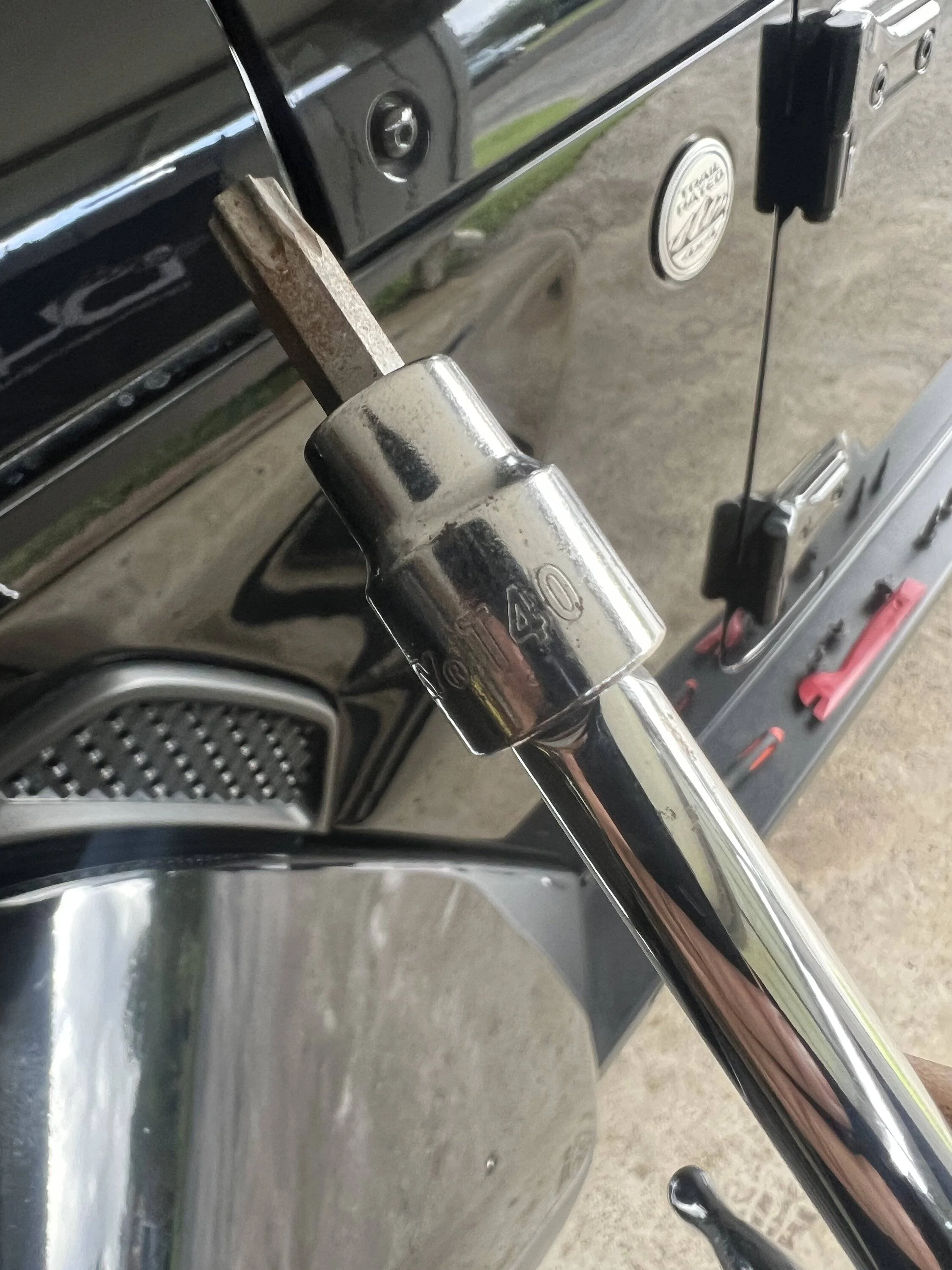

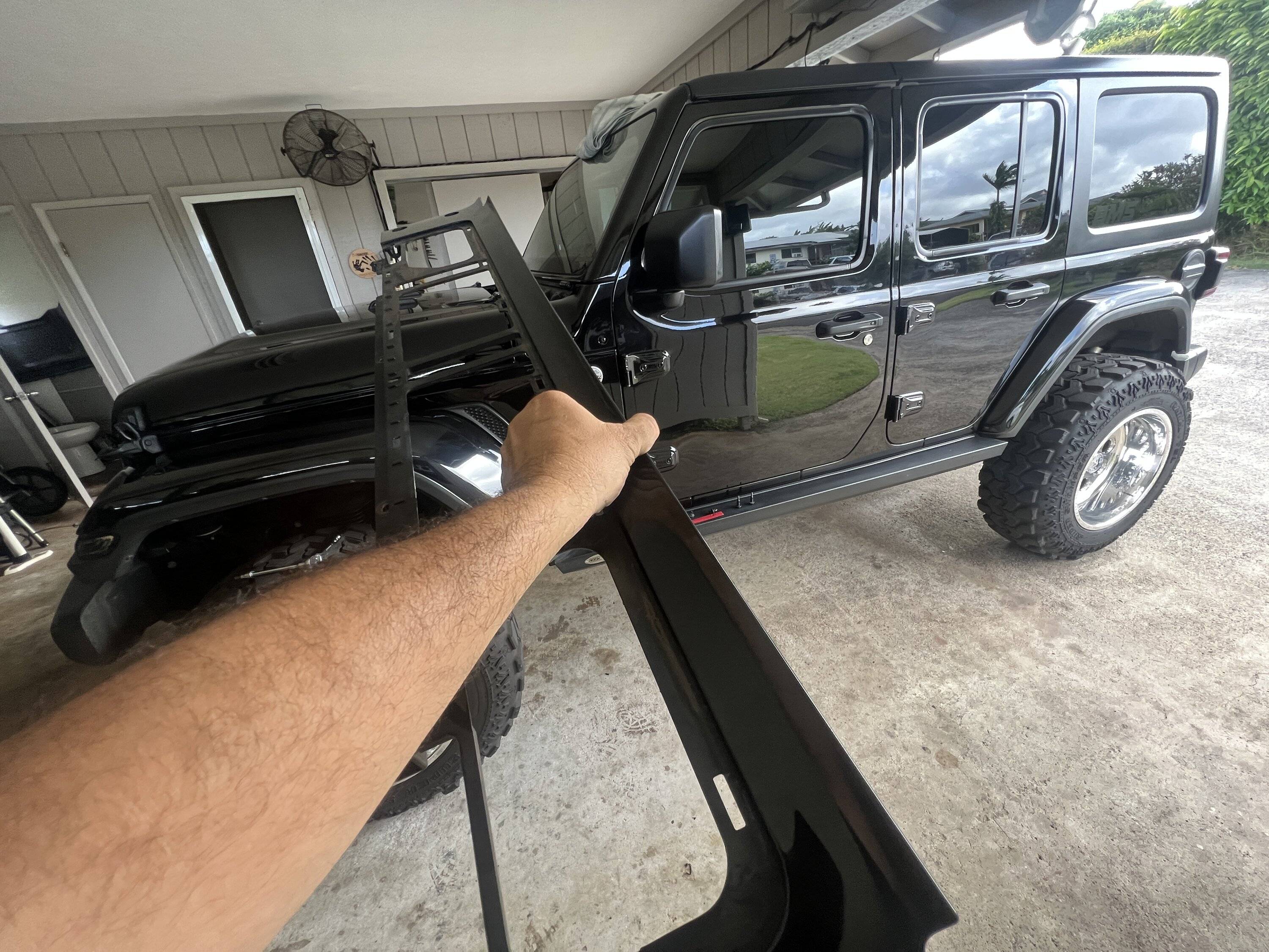

Well.
Fast forward a few weeks

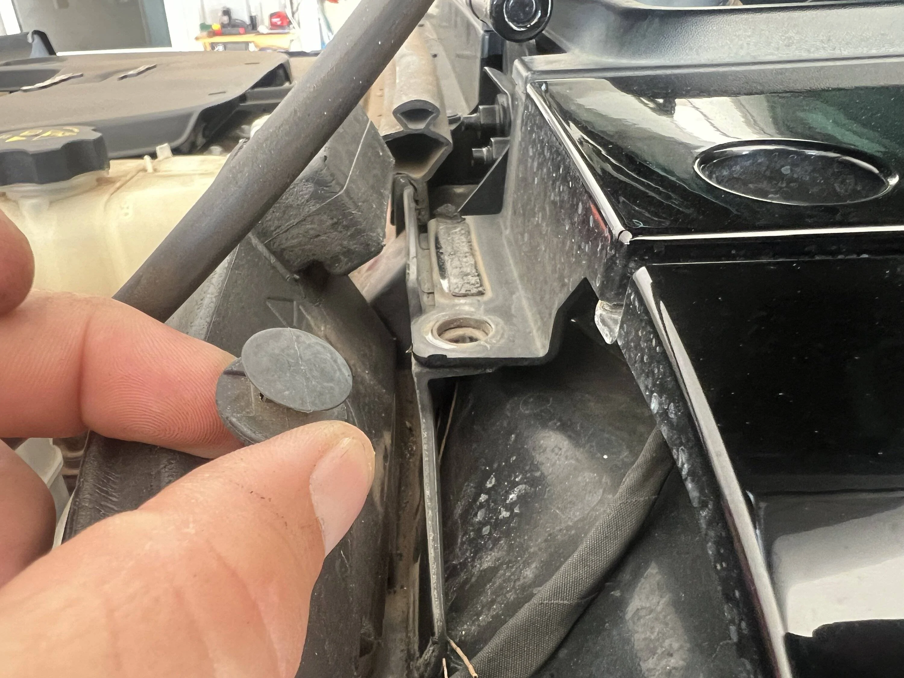

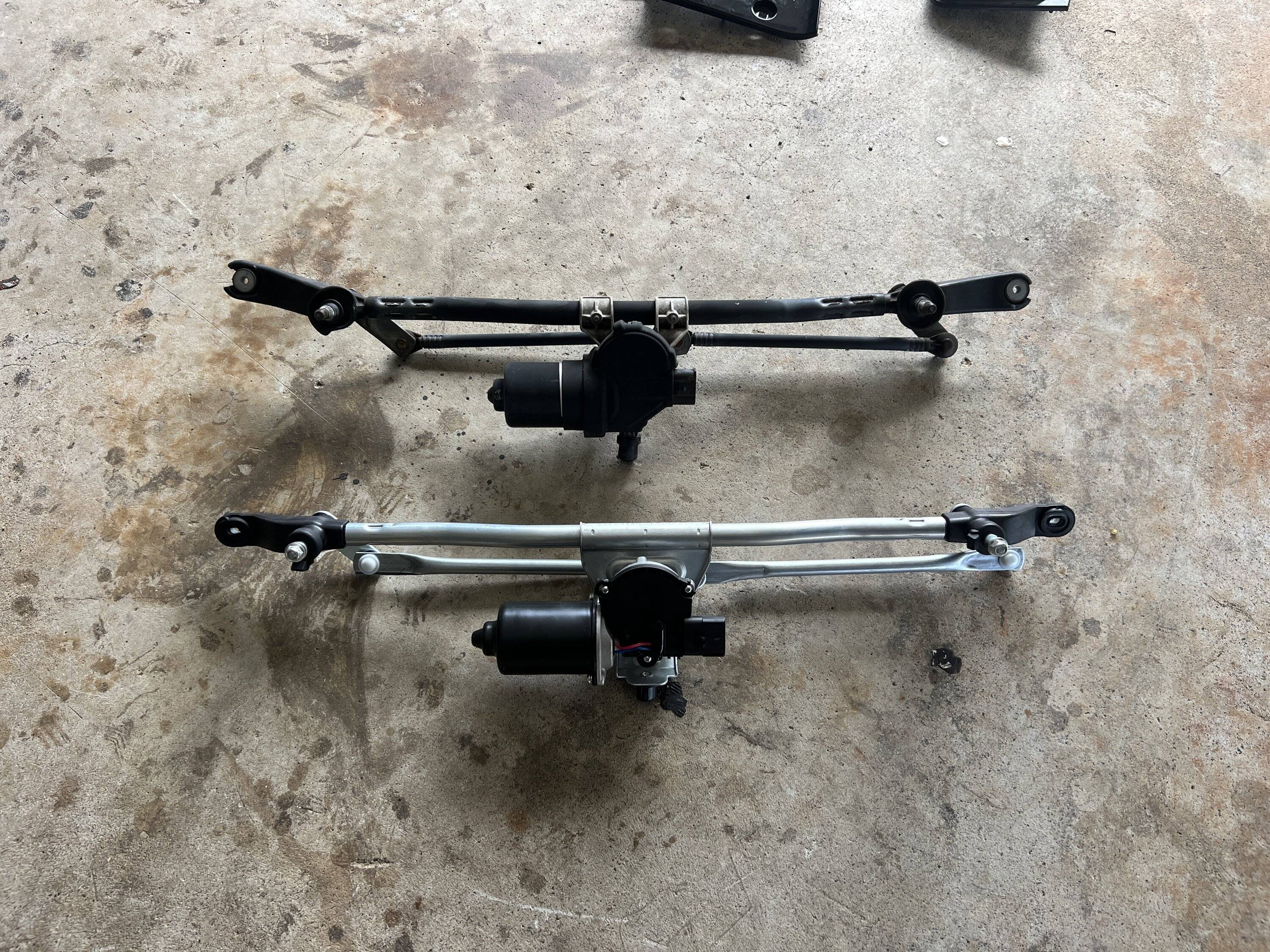

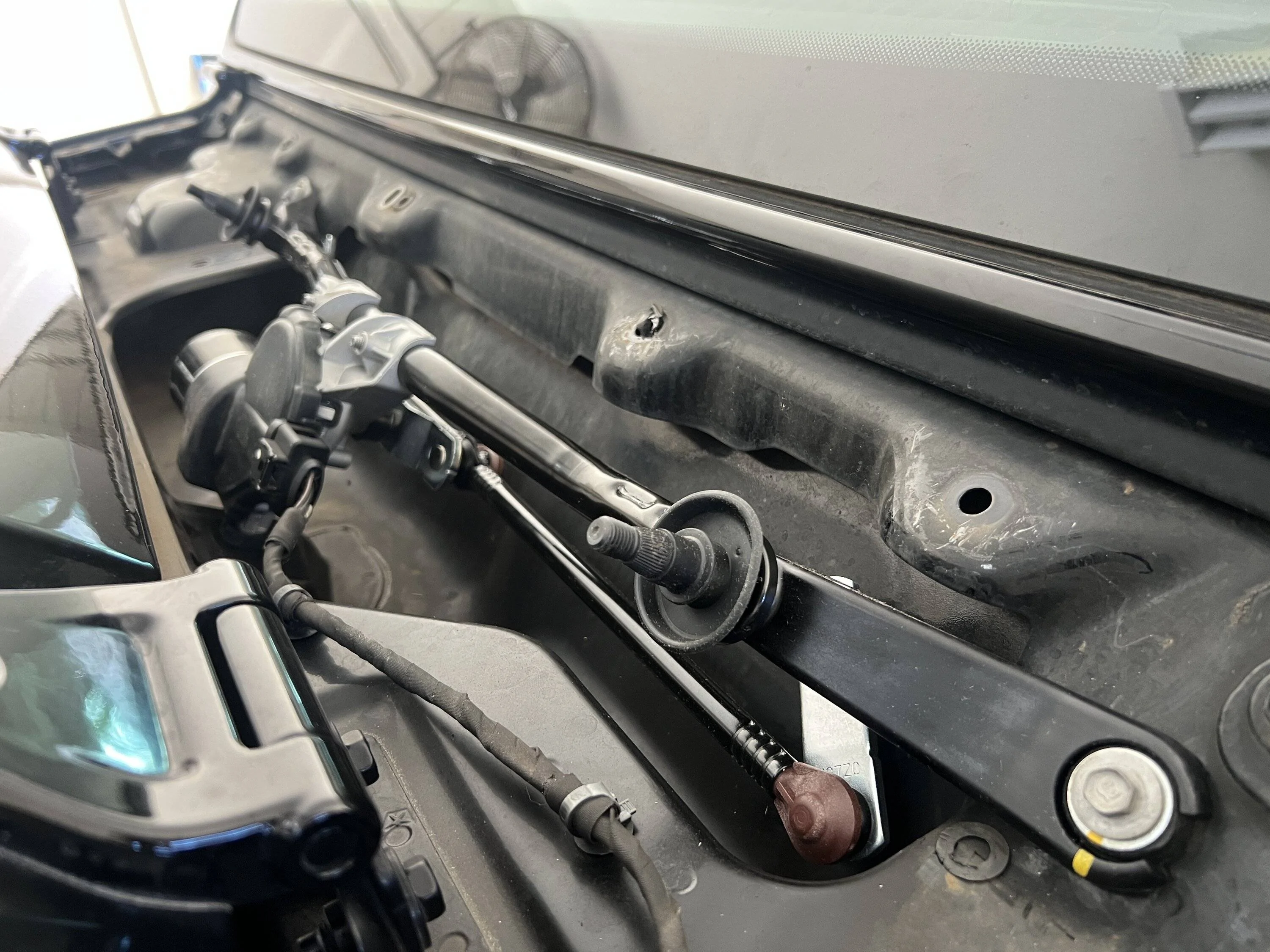

Ended up ordering a new wiper motor assembly from Autozone……
Here’s how that went.
Jeep Wrangler JL Windshield Wiper Motor Failure IMG_2665
Jeep Wrangler JL Windshield Wiper Motor Failure IMG_2663
Jeep Wrangler JL Windshield Wiper Motor Failure IMG_2664
Jeep Wrangler JL Windshield Wiper Motor Failure IMG_2670
Jeep Wrangler JL Windshield Wiper Motor Failure IMG_2662
Jeep Wrangler JL Windshield Wiper Motor Failure IMG_2668
Jeep Wrangler JL Windshield Wiper Motor Failure IMG_2671
Long Story short, It was the wrong assembly. Tech ordered the JK version from what I believe……
So I went online bit the bullet and ordered the overpriced Mopar assembly.:headbang:
I’ll update the post when the new part comes in next week.

Update:
One month later :facepalm:
Genuine Mopar JUST got delivered today.
Shipping to Hawaii SUCKS
Jeep Wrangler JL Windshield Wiper Motor Failure IMG_2963
Jeep Wrangler JL Windshield Wiper Motor Failure IMG_2962
