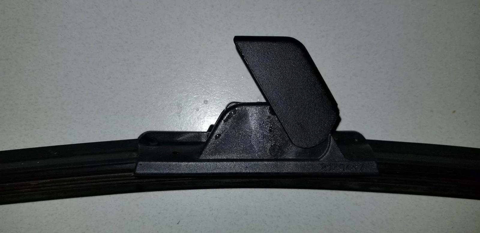

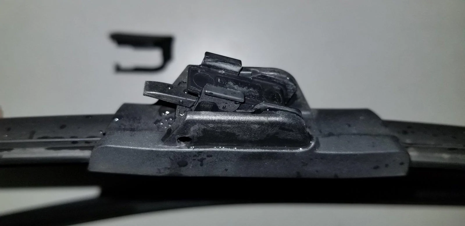

Tried to look up how to replace wiper on a jl sahara, could not figure it out.
Turn out has cosmetic plastic cover.
Flip up plastic cover, release latch slide towards arm bolt, then remove off j bracket.

Any 16” blades from auto parts store will do. I just replaced mine with Rain X blades.

Wanted to keep factory blade cover w air spoiler, or did u just replace blades only?
