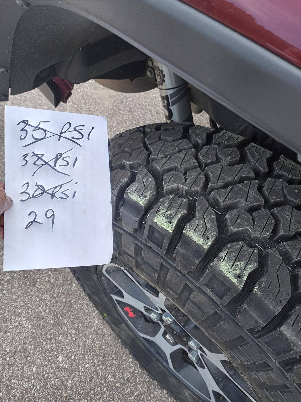

I typically run at about 13 PSI off road, as needed.
You will get lots of answers.
Jeep Wrangler JL Need Tire Pressure Advice 1744296180128-2w
I also do the chalk test on all new tires to see what wears off the best. Currently when every-day-driving, I run about 27-29, when the tires heat up.
Just google chalk testing tires.

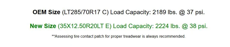

20s push equivalent pressure up a bit. Assuming E loads, this is using the tiresize.com pressure calculator, which is a good starting point based on load capacity:
Jeep Wrangler JL Need Tire Pressure Advice 1744300546984-9
Since the load from the factory sticker is already high for efficiency, I'd try closer to 35 psi and see what you think.
