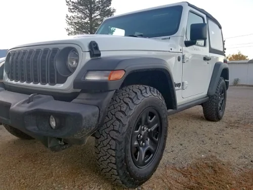

Here's pic with those new tires.
Jeep Wrangler JL Advice on tire pressure J

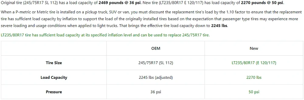

Someone on here posted a link to Tire Pressure Calculator so I entered the info from OE tires and KO3 and this is what I got.
Jeep Wrangler JL Advice on tire pressure PSI
Is that 50 psi recommended for Hwy driving? Discount Tire put 36 psi as stated on a door jamb label.

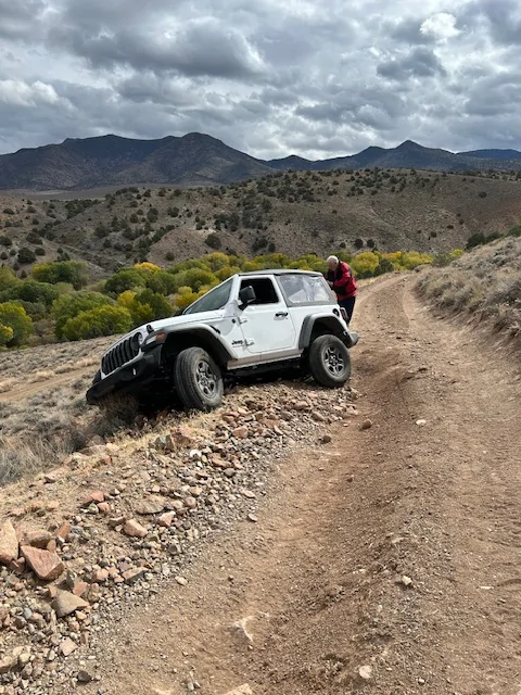

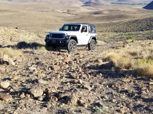

How much should I air down those KO3's when I am on trail like this?
Jeep Wrangler JL Advice on tire pressure 11

If it were mine I'd run 35 psi on-road and 15 psi off-road. The writing in too small for me to read but 50 psi is way to high on road. Have fun with the new ride!

Lots of people recommend using a chalk test to figure out what pressure works for your specific combination of tires and vehicle weight. It's pretty simple and should give you a good idea of where it should be.
50 PSI is way too high. You'll probably want to start in the low 30s and work up or down from there.
15-ish is a good starting point for on rocks. Start there until you get comfortable going a little bit lower and depending on obstacle difficulty. I'll usually go to about 12 when doing difficult stuff and (extremely rarely) down to 10 when it's an insane obstacle. Higher when it's primarily for comfort / damage reduction over stupidly long stretches of washboard roads.

50 psi is the pressure used for the maximum load rating. It is not the recommended pressure unless your Jeep weighs 9080 lbs.
Oh ok, good to know Thanks

A chalk test with my 37x12.5R17 BFG KO2 showed my sweet spot to be around 34 psi on pavement. I air down to 12 psi when off-roading.

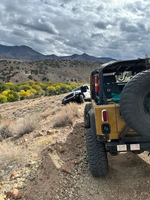

Yeah, I wondered myself but at the time I was so pissed I didn't think to go back and investigate. The problem was that I was going too fast on OE tires on a rocky section of the trail. I got a lot to learn as far as off-roading.
There was another time I looked at my Cane Corso running by my left side and I almost rolled my Jeep over. It scared the shit out of me. I don't have a cell phone so I had to walk 3 hours home and call a couple guys from a local jeep club to help me get out.

i typically run Cold PSI in the low-mid 30s on the road depending on conditions; if i see pressures rise more than about 10% in regular use i know my Cold PSI is too low and adjust.
off-pavement i usually start around 12PSI, and will run lower if on Sand or loose Snow.
