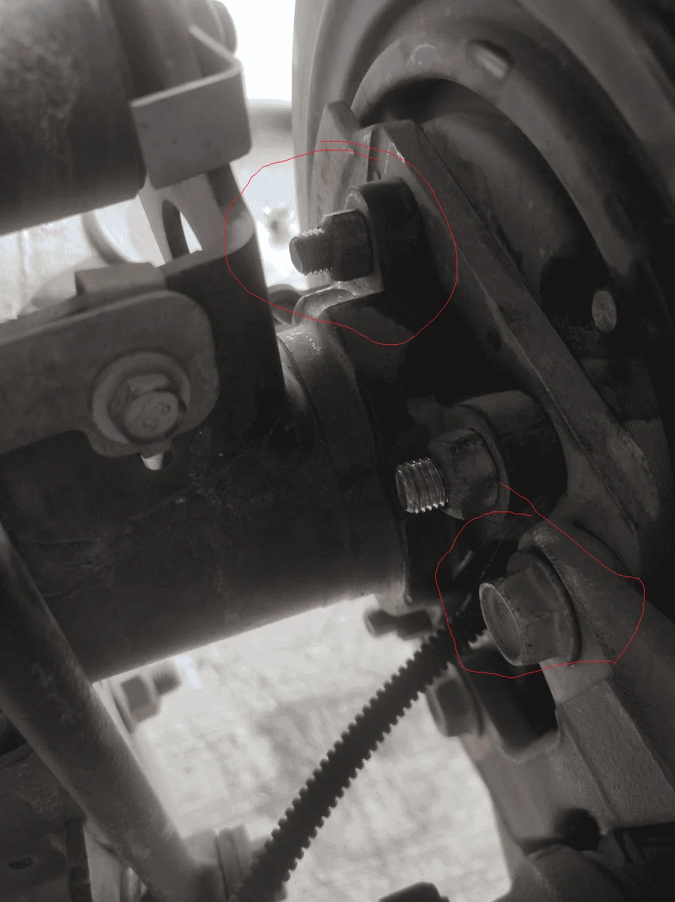

it seems I'm not able to find the torque values for those nuts and screws, first cause I don't the name in English and second searched the axle shaft on the torque reference post and could not find them. Help please

The upper one circled on your photo (for which there are four nuts) are axle shaft retainer plate nuts - 59 foot-pounds
The lower one (for which there are two bolts) are brake caliper adapter bolts - 74 foot-pounds

Thank you @azwjowner
