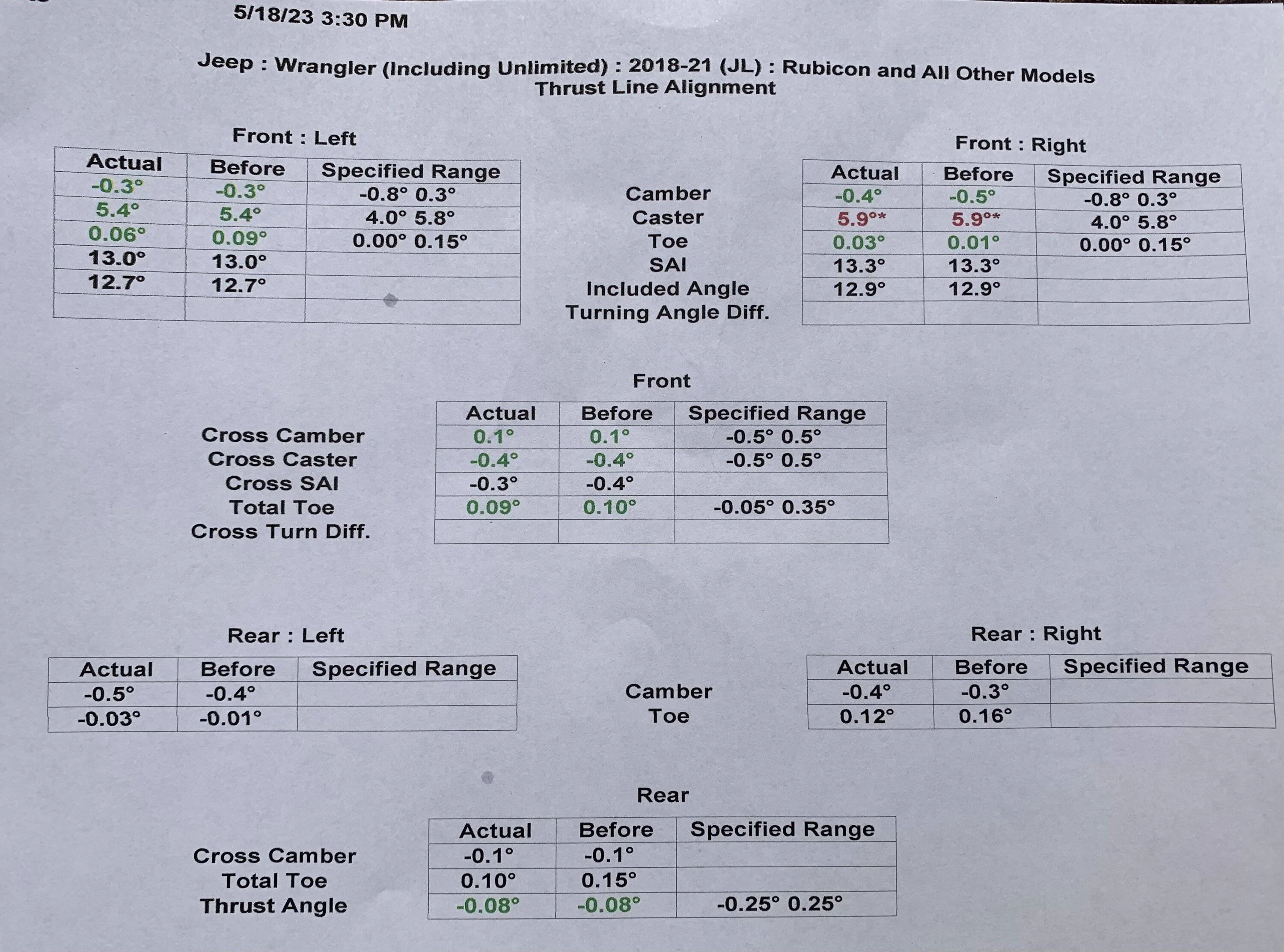

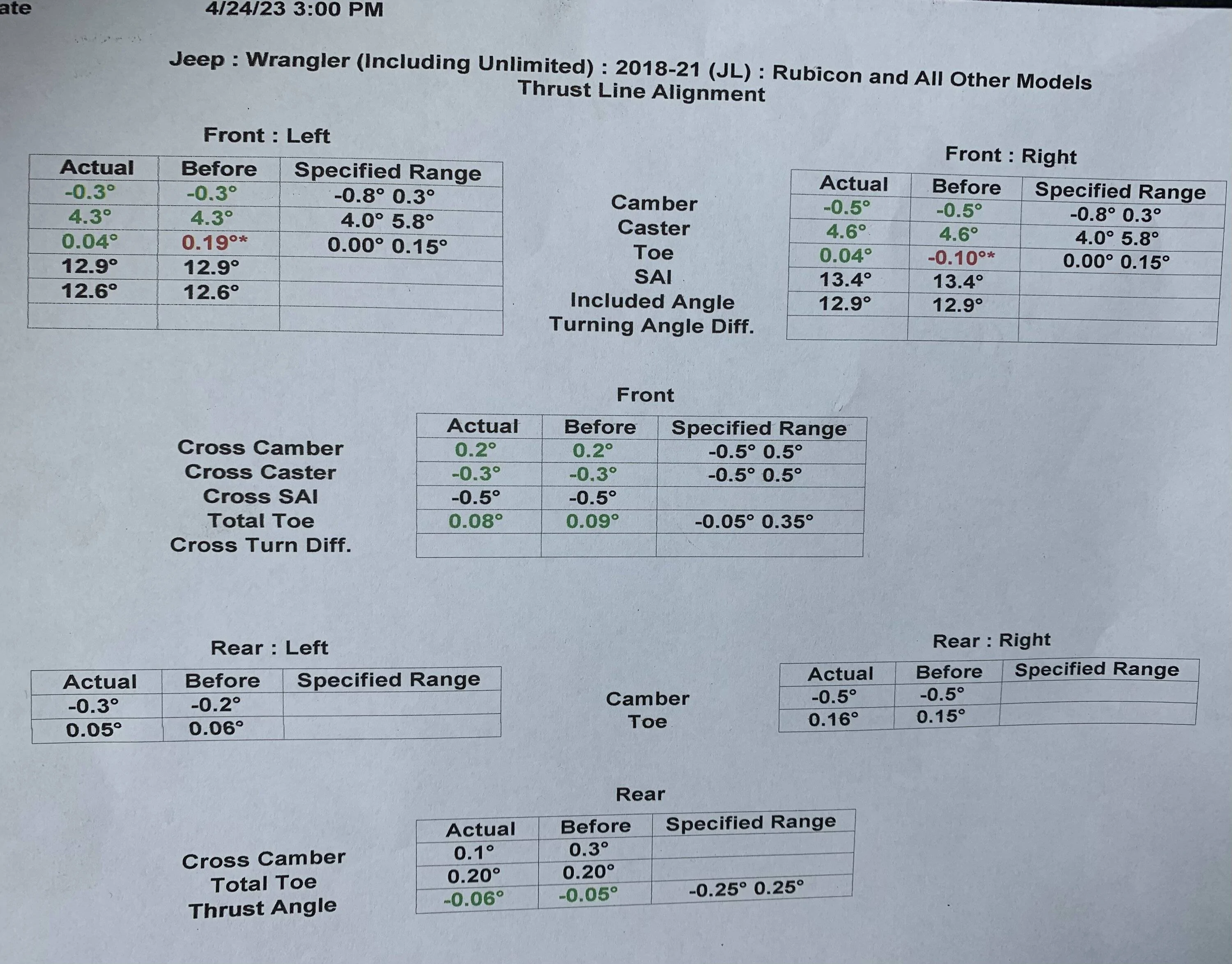

Just wanted to share my before and after the Mopar LCAs swap if can be any help to anyone who searches for this topic. My stock 392 XR was great to drive even before the swap, the extra 1/4” length does improve the ride and increase 1 degree caster angle. Now it tracks a bit better and has better return-to-center.
Jeep Wrangler JL Different values for left/right caster: How much is too much? IMG_4528
Jeep Wrangler JL Different values for left/right caster: How much is too much? IMG_4824
