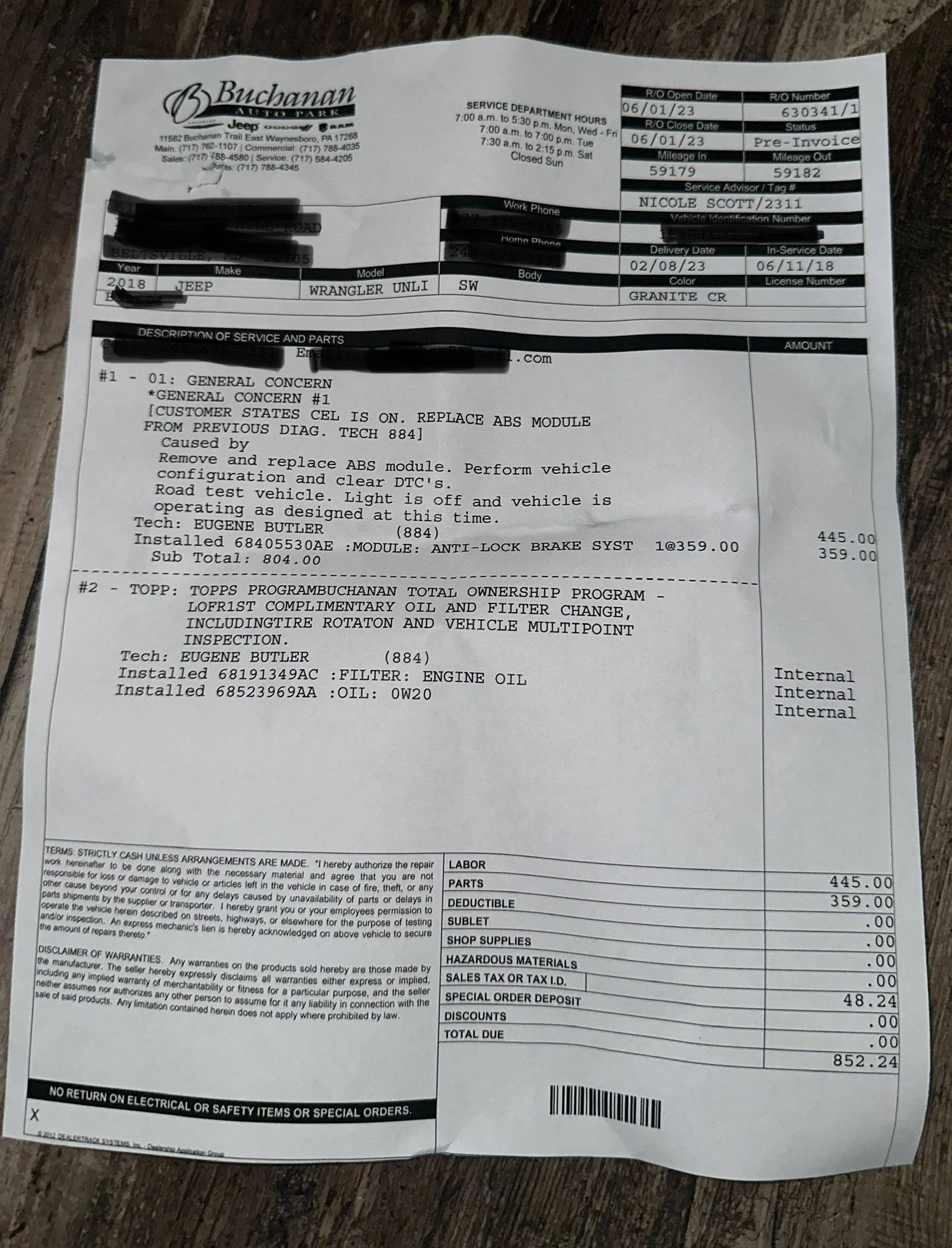

Hi @JeepCares , my story starts from here first my jeep’s dashboard showed “abs light” for which I checked with my dealership, they said it needs new abs module which doesn't cover in warranty and they also said its okay to drive it with precautions. After driving for few days without replacement of new abs module..one day my jeep showed all these lights on dashboard and the shifter got stuck on Park then i turned off my jeep and started with “ remote start “ then shifter starts working . also whenever i starts my jeep with “remote start” , it only stays ON for few seconds. On last Thursday, i took my jeep to the same dealership, so they can install new abs module and they did , after that my jeep worked fine for few days but today morning when I started my jeep , all those lights showed again, the dealership charged me $ 852.24 for installation of new abs module , and still not fixed
my jeep info: 2018 jlu bought few months ago in with 56,000 miles on it
Jeep Wrangler JL Need help!!! 4F862656-029F-4AD2-AF22-63F2C56A269E

Does it really cost >$850 to replace the ABS module…? ?
And to do it at a price >$445 for labor…? ?
And that didn’t even fix the problem…? ?
Its probably a 3-4hr job and the tech only gets paid a fraction of what the Dealer actually charges.
If you are willing to beat the shit out of your body for years there is good money to be made in it but its not really fun work.
