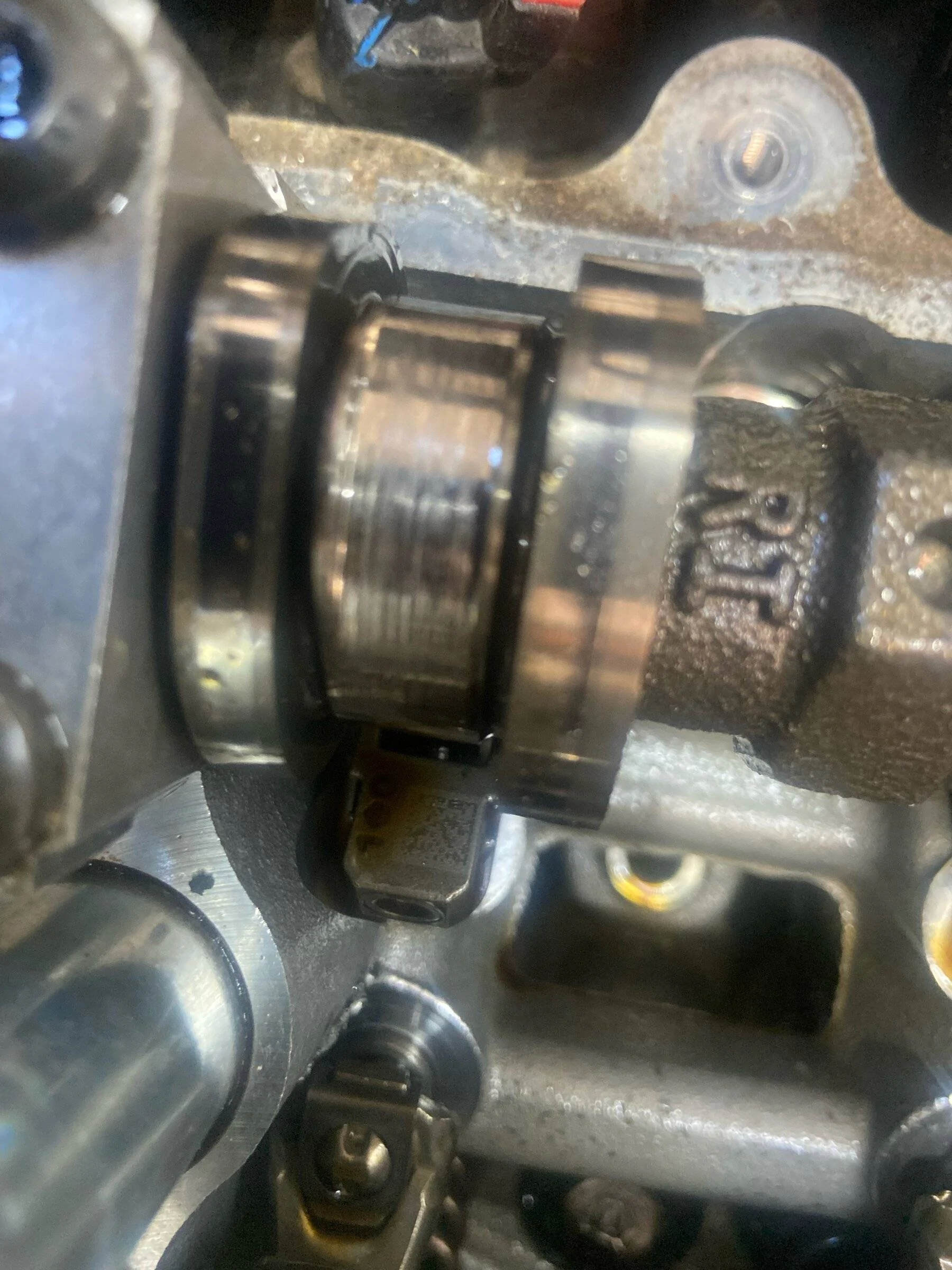

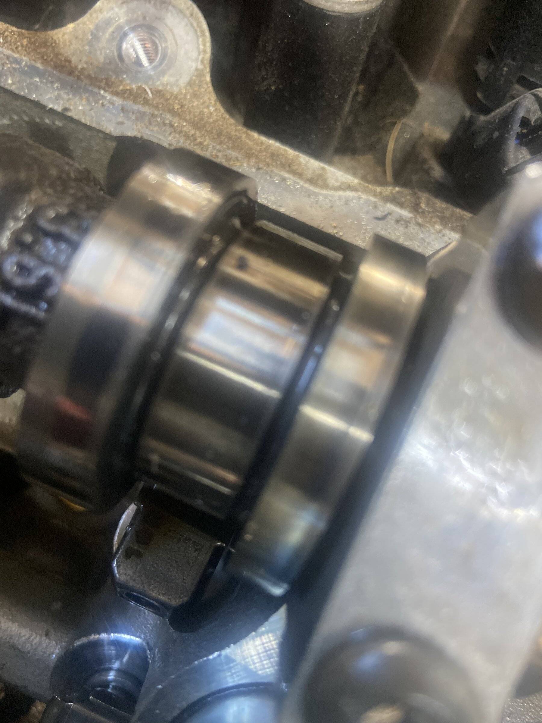

Apparently I will need a cam. Said the worn out rocker arms ate away at it. I attached the pictures that I got sent. Damn this is gonna get real costly once I find everything out Monday.
