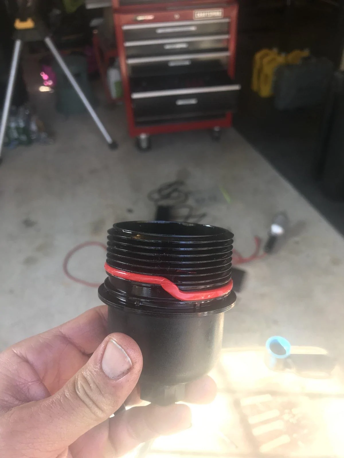

Nope. Just put in new filter and changed out oil. Still leaking. And a lot. Hard to see because it is so tight. Looks like it’s underneath the oilf filter casing. Can’t really tell though.

There is definitely a puddle of oil sitting under the filter housing. I stuck a thin stick down there and that’s when you can see it.
