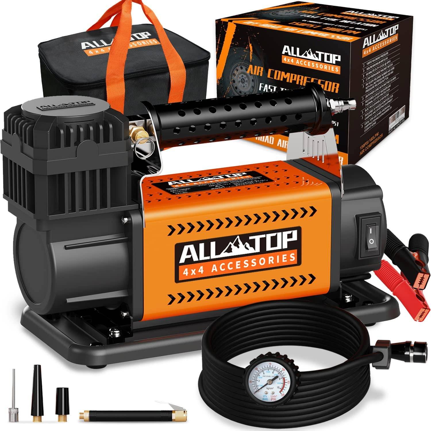

If you are patient you can find a maxi-trac style 300lpm air compressor on sale for around $150 (all top air compressor), but that is overkill unless you use a 4 tire inflation system. The napa one is currently at $150 but has a weird connector that only works with the supplied hose.
If you don't want to deal with a 4 tire inflation system, right now the single pump version can be had for a pretty good deal (never seen it this low: $52): KAFLLA 12V Air Compressor Kit. it even has a pressure relief valve so it doesn't gernade if you eventually decide to mod it for a 4 tire setup.
These are all pretty much made in the same factory in china, the caveat is that you will need to be a little handy and inspect them; the price is so low because you are now the quality control. I bought an alltop one and it was missing two out of four bolts on the pressure head which could have been bad news if I had tried to use it. alternatively you can spend double for a morrflate; you get the same thing with a different paint job, but it might have been held to a higher quality standard.
edit: just a note, none of these run off internal batteries, they pull a lot of amps and need to be hooked up to your car battery when used.
