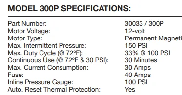

To give you an example of duty cycle, here's the specs on the Viair 300P which is right in your budget.
Jeep Wrangler JL Need a new air pump/air compressor they keep breaking 1705356110086
You can use it for 30 minutes continuous at 30 psi in decent temps, but if you start cranking up the PSI, it gets closer to 20 mins on, 40 min cool down.
You should have no problem airing up all four tires into the 30s in less than the 30 minute max.
