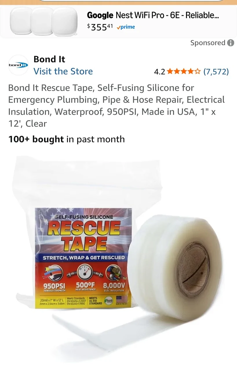

I don't know about the grease. I assume any will do but I like marine so it fights water a little. Instead of duct tape use rescue self vulcanizing tape. I like the "Bond It" brand myself. Just search on Amazon rescue tape and a ton will come up. It's silicone tape that if it's clean will vulcanize to itself and create a good barrier. I've used it on radiator hoses before so it's good stuff.

This?

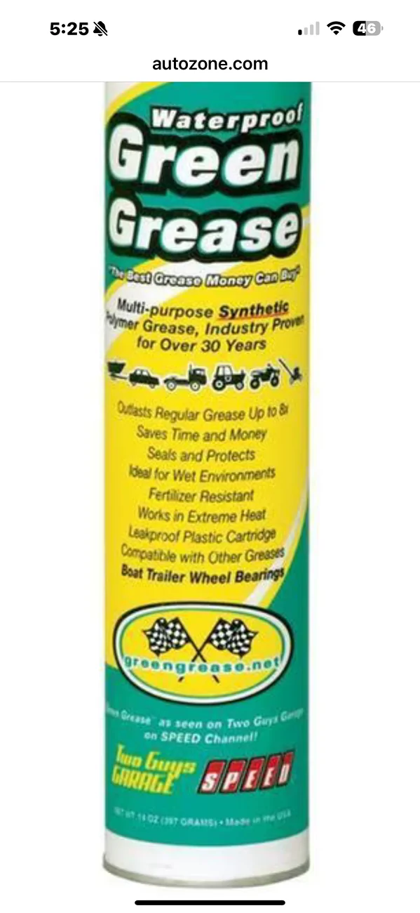

The grease looks like Green Grease. If it is, it’s synthetic, stable to 500° iirc, and waterproof. Great stuff. I’ve been using it exclusively for about 30 years, including when I had RCV’s (they approved it) in my last JL. Here’s a screen shot of what it looks like and you can get it at Autozone.
