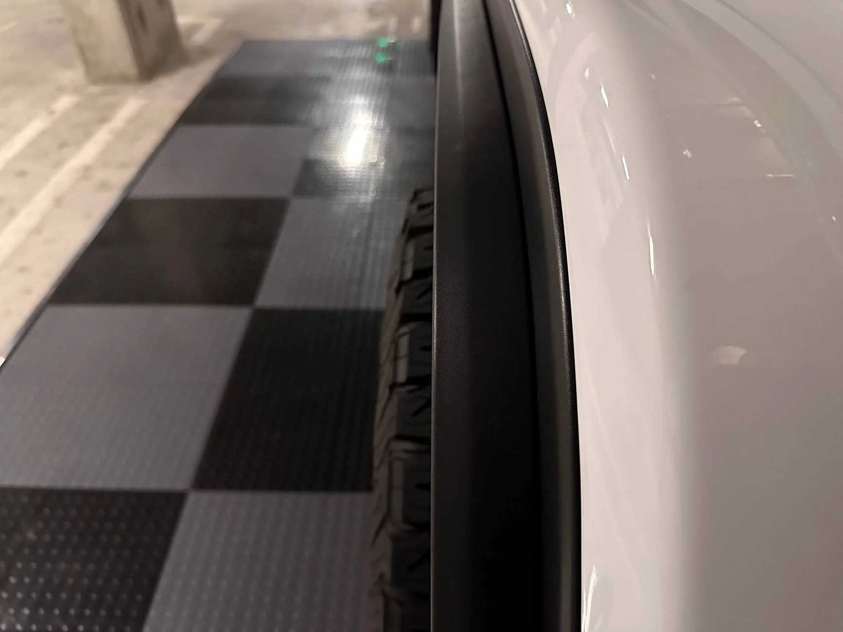

Yes, I did and I’m very happy with it

Mine are 1.75 and no cutting of the studs. With the Xr flare extensions it is about perfect imho. Just barely outside the flare
