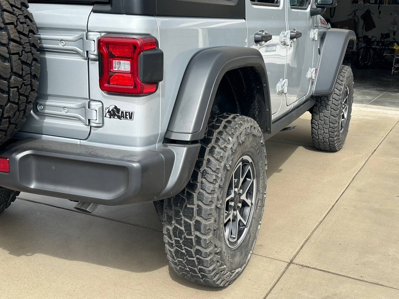

wanted to keep my stock wheels and am running skinny 35's so stock 7.5" wide wheels are perfect for my 255/85-17 Micky Thompson baja's but wanted just a little more clearance at the rear swaybar link. I have for years run spidertrax on JK's but they only made 1.75" for the JL which was going to push the tires out too far for my tastes. Picked up a set of BORA 1" spacers from member richk225 and installed them today. They did exactly what I wanted. Still have the tires mostly inside the flares but gave a nice subtle difference in appearance and the extra clearance at the swaybar links.

How are those Mickey T pizza cutters working out for you?
And how close were they to the rear sway bar link?
I'm considering going in that direction.

I love them so far but only have 1000 miles on them. I was only close because i put an aev lift on with longer swaybar links. With no lift and stock links there would be no issues.

Hmm. I do have an OME 2" Heavy Load suspension. I'll make sure to pay attention to that sway bar link when I do my final sizing. Thanks for the heads up.
