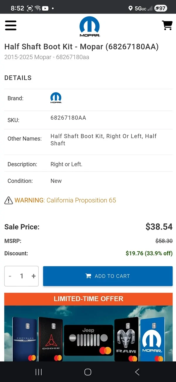

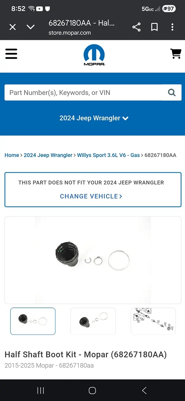

Guys, Mopar doesn't sell boots alone, they come with axle assembly. Are you guys sure boot is available alone?
