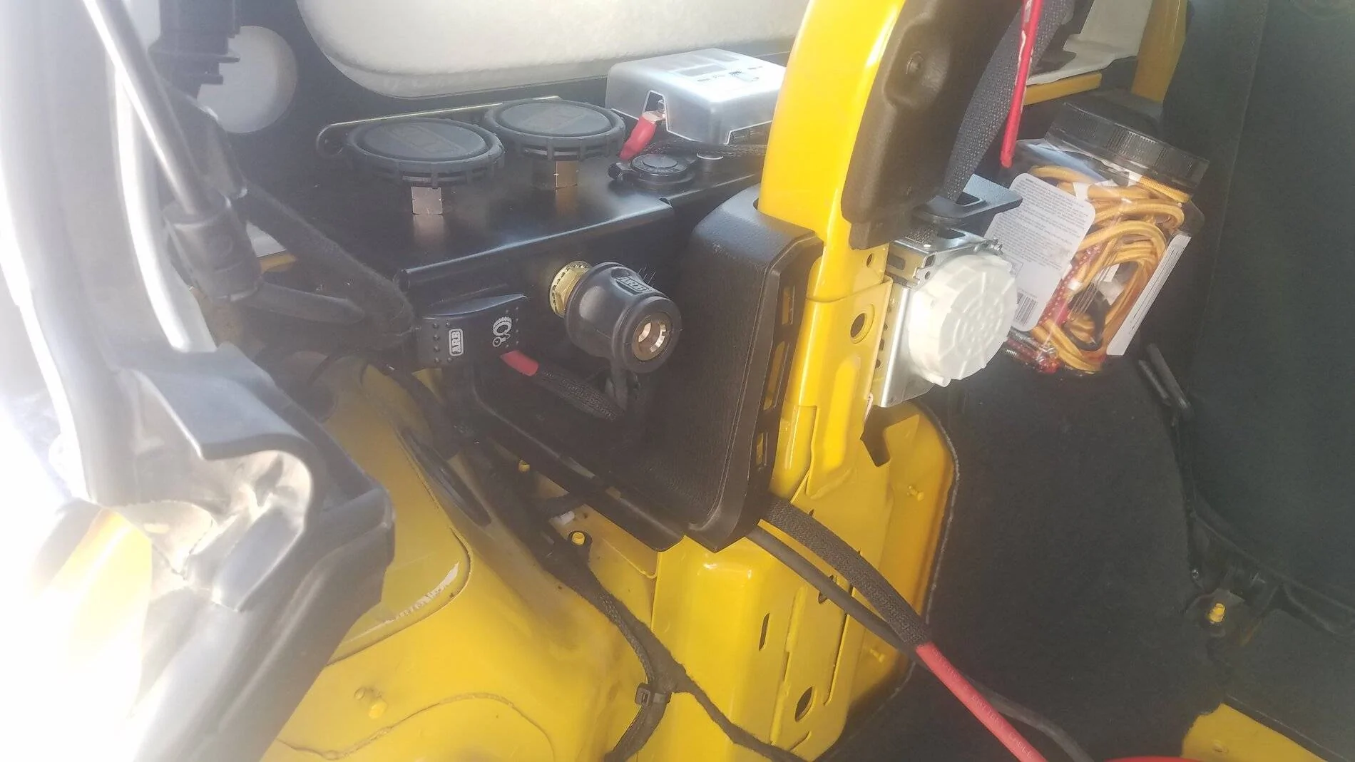

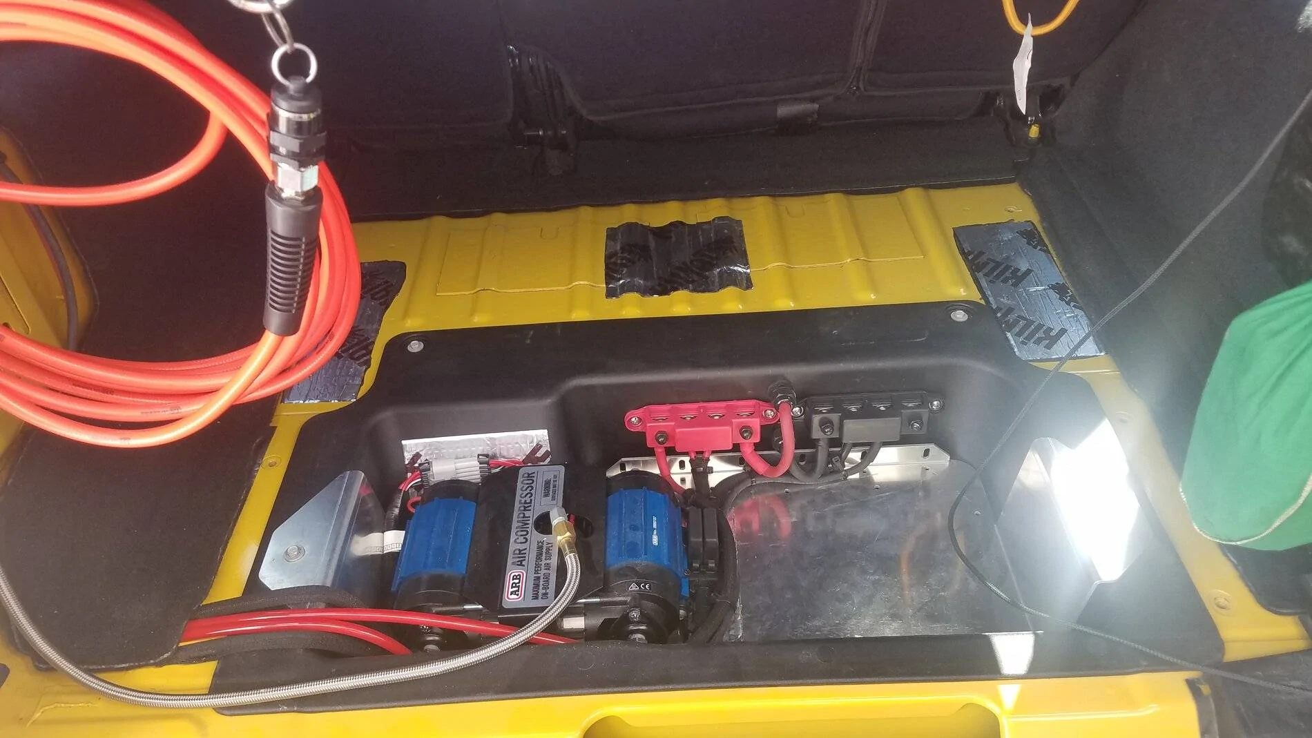

do you have to keep the lid open every time you operate it? can you run the air intakes out somehow? i often have a full trunk, it would be crazy to unload every time.

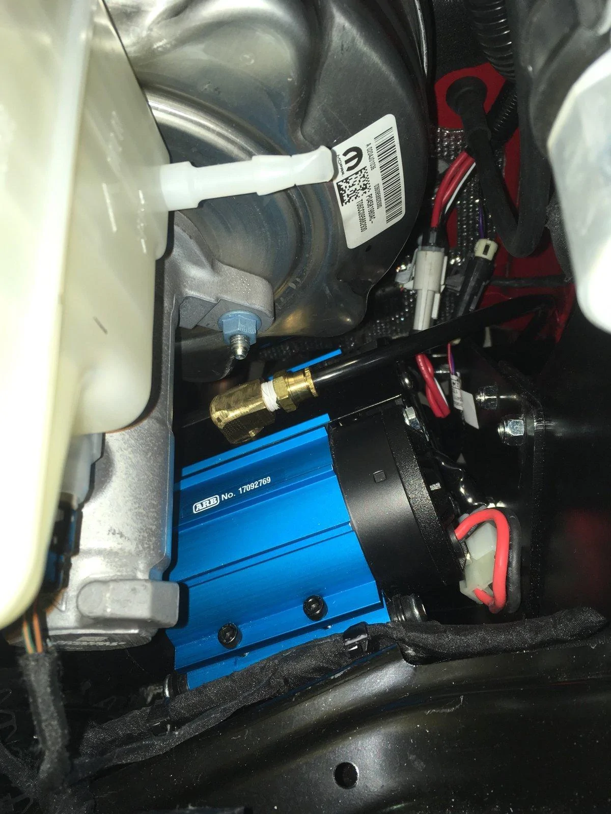

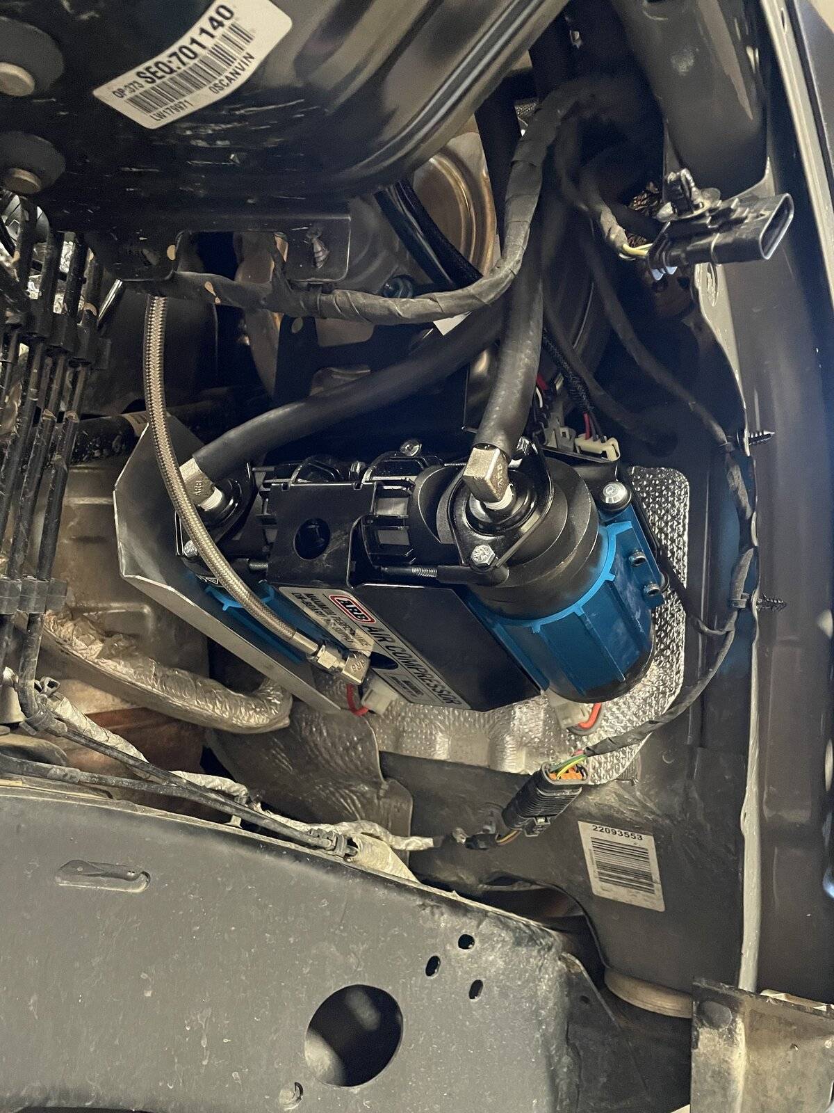

It took awhile, but I was able to come up with a mount under hood for the ARB twin. Clearances are pretty tight but it works like a charm. One of the sweet things about having it under the hood is the ease of wiring to the aux switch and creating an attachment for the air hose. I’ve attached some pix.
Jeep Wrangler JL Mounting ARB Air Compressor 77786E62-C0E8-4BB1-BCA1-226005B6D5CE
Count me in too. Keep us posted as if and how we can get the brackets.
No, and yes. AAL makes a remote panel to mount the intakes on, but people have also made their own, the AAL one is a PITA to install
