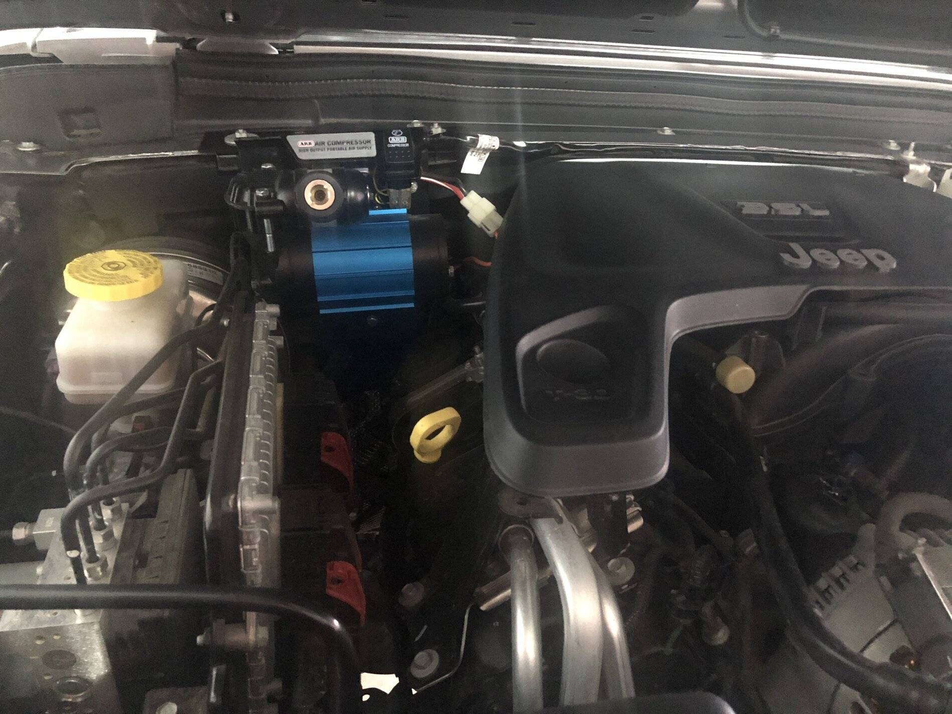

Hey Guys,
Has anyone seen the 813 Fabrication Under the Hood mount?
Looks very clean!
I was wondering if anyone has installed it on the JLs?

Hey Guys,
Looks very clean!
Cheers
I did a similar installation on my right hand drive JLR. I do not have the need for the ARB Twin, so I installed the ARB High Output. Perfect spot, nice and high, does not get too hot or dirty.

I really wanted the 813 as well. Will not work with 2021 3.6l eTorque...

Oh man! I got so excited with this then I noticed its a right side drive!!!
