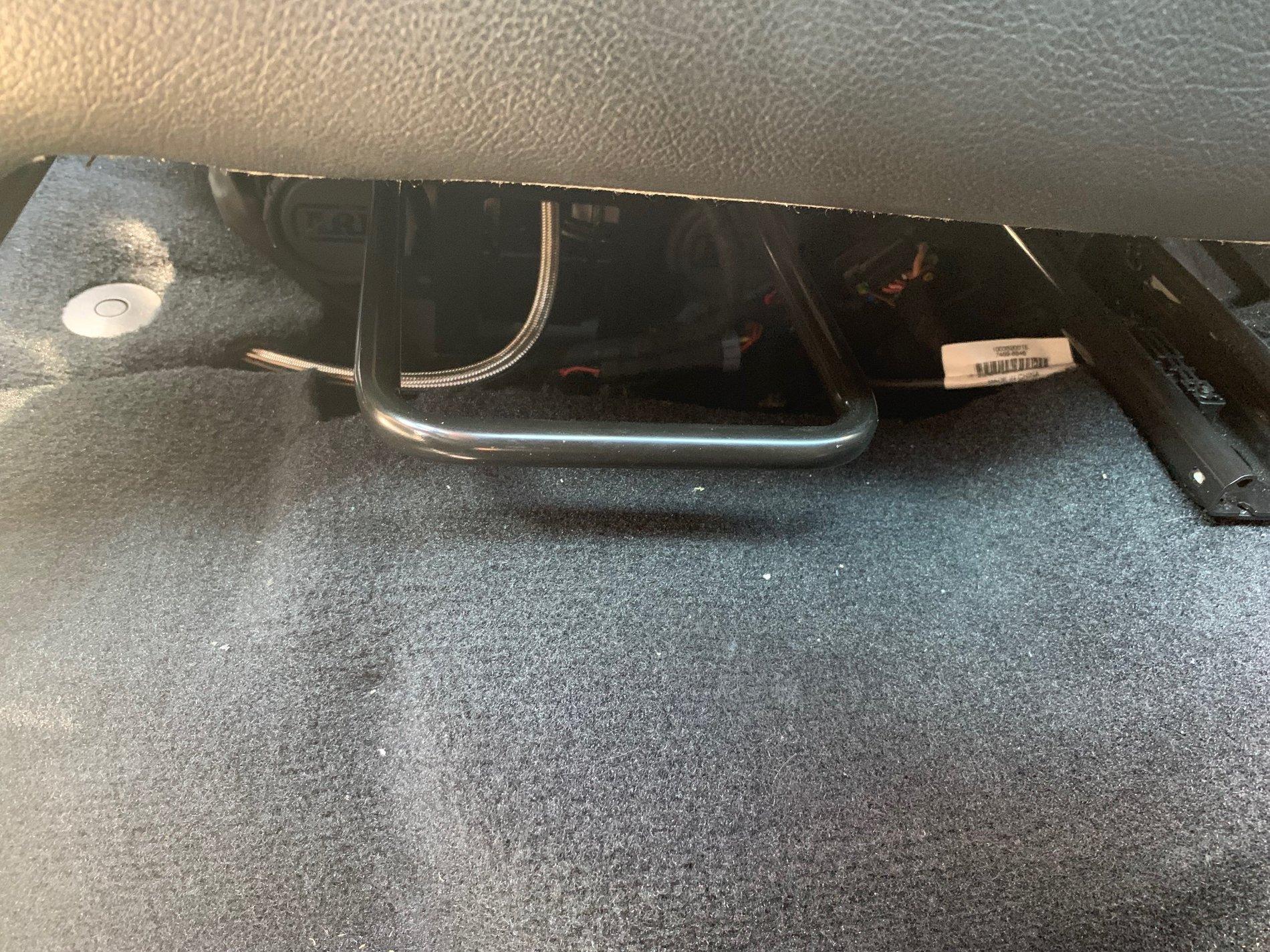

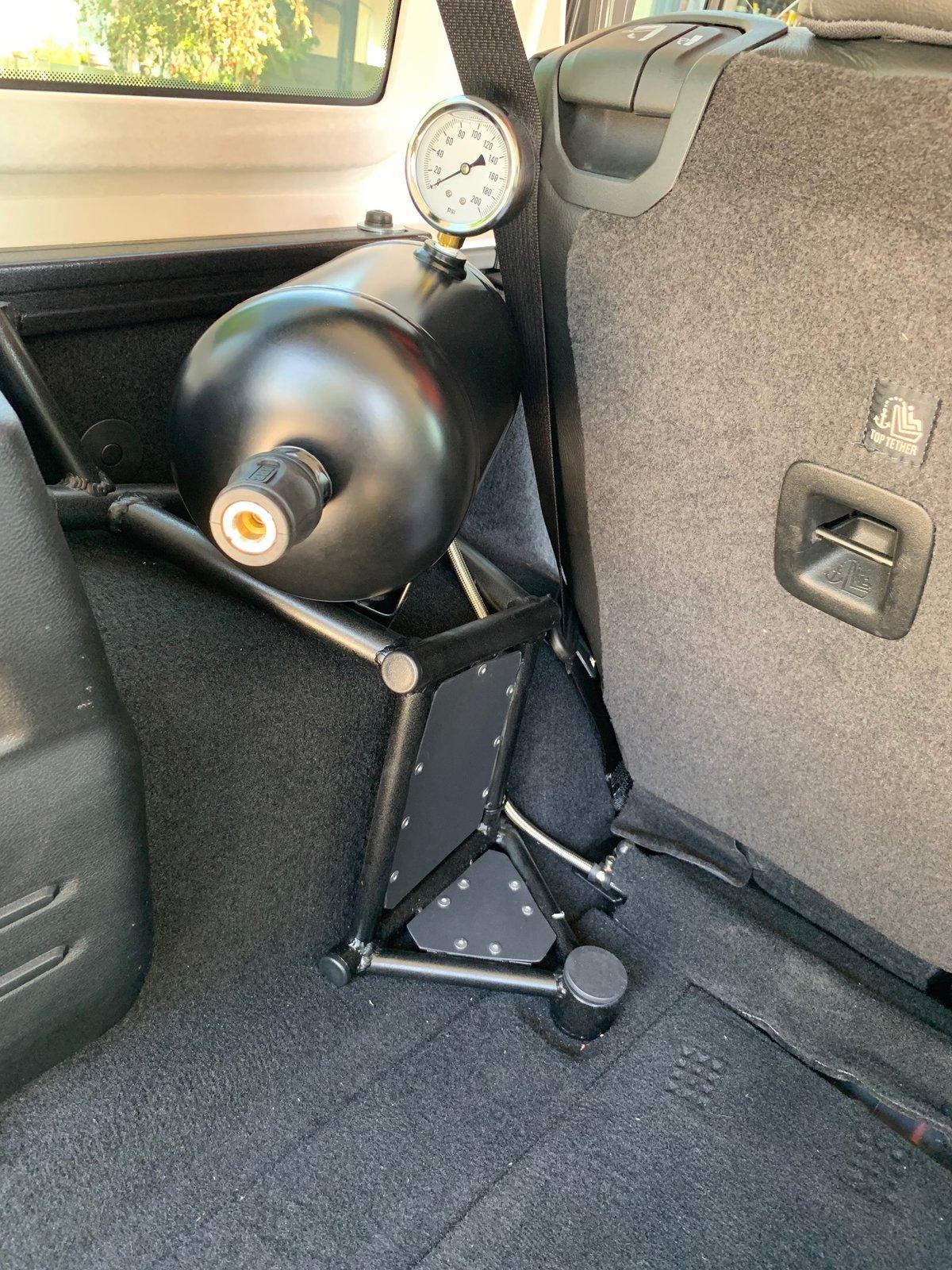

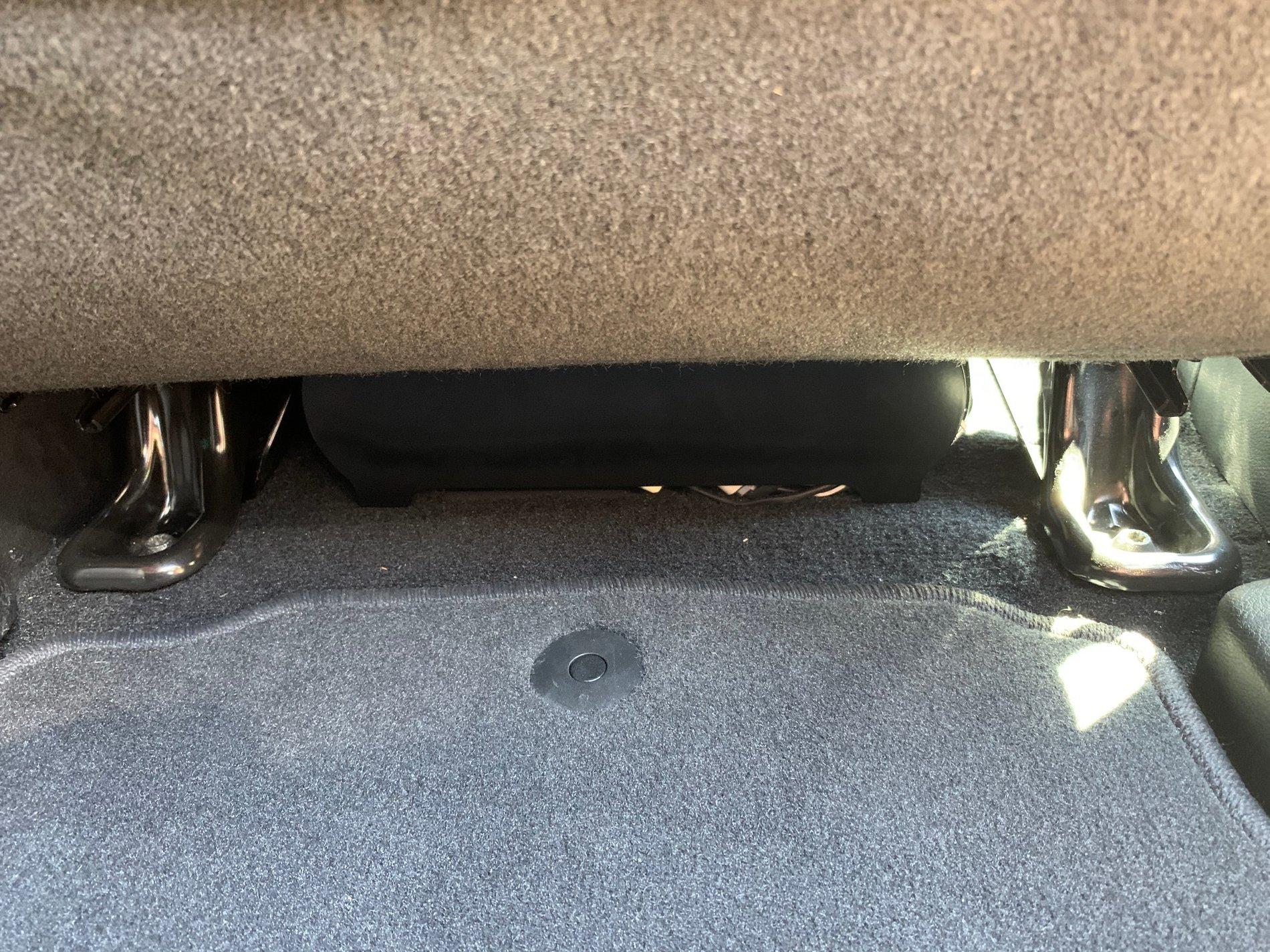

Installed the ARB under-seat air compressor bracket with my twin air. And I did not trigger an air-bag :) Plenty of foot room in the back for the kids and is tucked back far enough in the front. Also hooked up a breaker due to my paranoia.

nice! Does the power wire reach from the seat to the battery or did you have to extend it? And did you go through the drain plug or the passenger side grommet?
Thanks! I extended through the drainplug in the floor. (wrapped in a ton of electrical tape and then heatshrink)

I noticed that I did not answer your question. I ended up cutting the wires after only a couple of feet / running most of the way to the breaker with heavier gauge wires. I ran the wires the weekend before installing the ARB bracket and ran into a problem. ARB has you drill a hole in front of the drain plug and attach a nut / bolt for the front of the air compressor bracket. They want you to use the drain plug hole for access to connect the nut / bolt. (My drain plug hole had the power cables filling the hole from the weekend before)..... Just made it a pain to get to. :)
I just put a riv-nut in that location so no bottom access needed.
