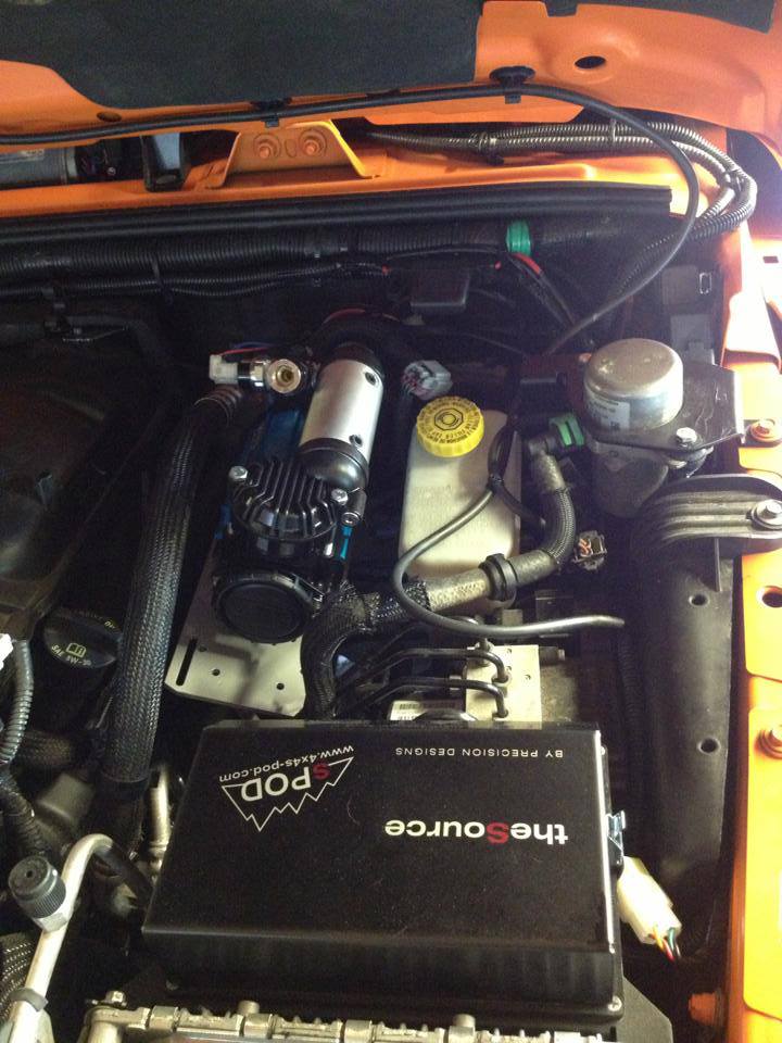

It worked fine on my JK with 35”s, but I’d always open the hood to access the air chuck and it was on top with good airflow. It never once overheated on me. It’s just too tucked in on the JL. And I have 37”s and beadlocks now, so I air down further and am placing more demand on compressor.

On my JK I had an under hood mount for the single compressor that placed it directly over the drivers side exhaust manifolds. After a day of wheeling I'd get maybe 5min of use out of it before it would go into thermal and shut down.
hmm I had my ARB installed on the ABS tray of the TJ I had and never ever had an issue. It wasnt above the exhaust but it was on the exhaust side. I could have swore I read ARB's were OK in heat.

I had mine in the engine bay, driver side with the KansasJL homemade mount. I would wheel in Socal in 100 degree weather and put the Jeep through its paces. It had to be 200 degrees in there. It never failed. Now I am not saying that is good for the longevity and like I mentioned before I did move it under the pass seat but did that because now I have snow and salt from the roads to deal with and I am sure that is not good for it. I have been completely happy with the dual ARB. Bullet proof.
