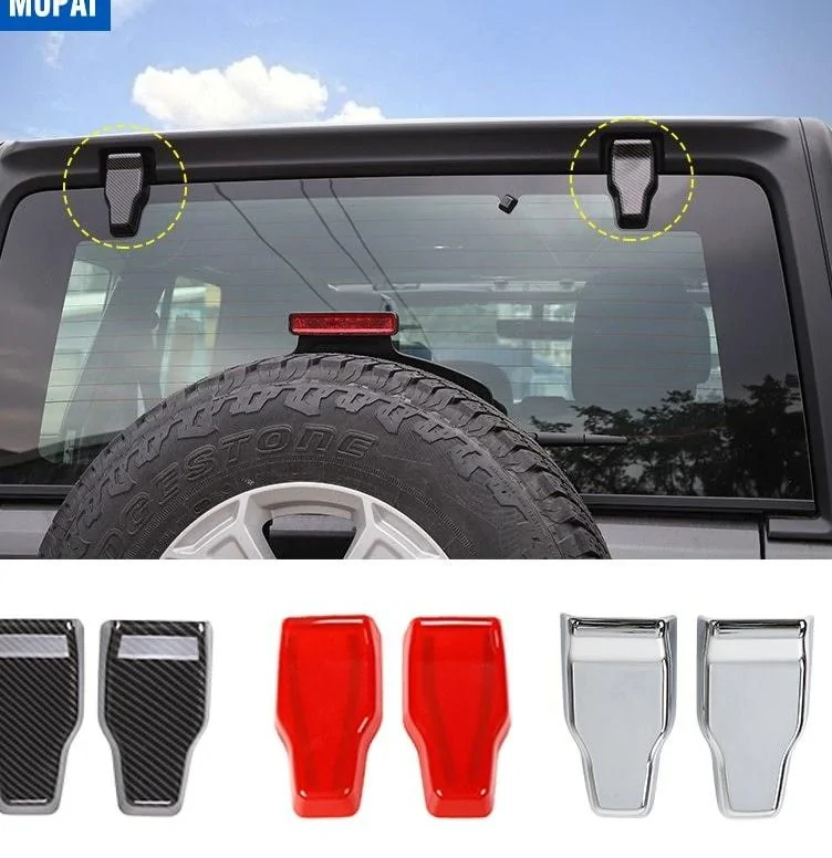

Also, the fiberglass hinge covers are on order but they might not get here before the trip. I did, however, order a spare pair in the red in case the fiberglass ones get damaged on the trail. Never hurts to have a few spare parts for trail repairs.
You have to get the carbon fiber ones to save the weight. Hinged weight is the 2nd most critical after rotating weight.
