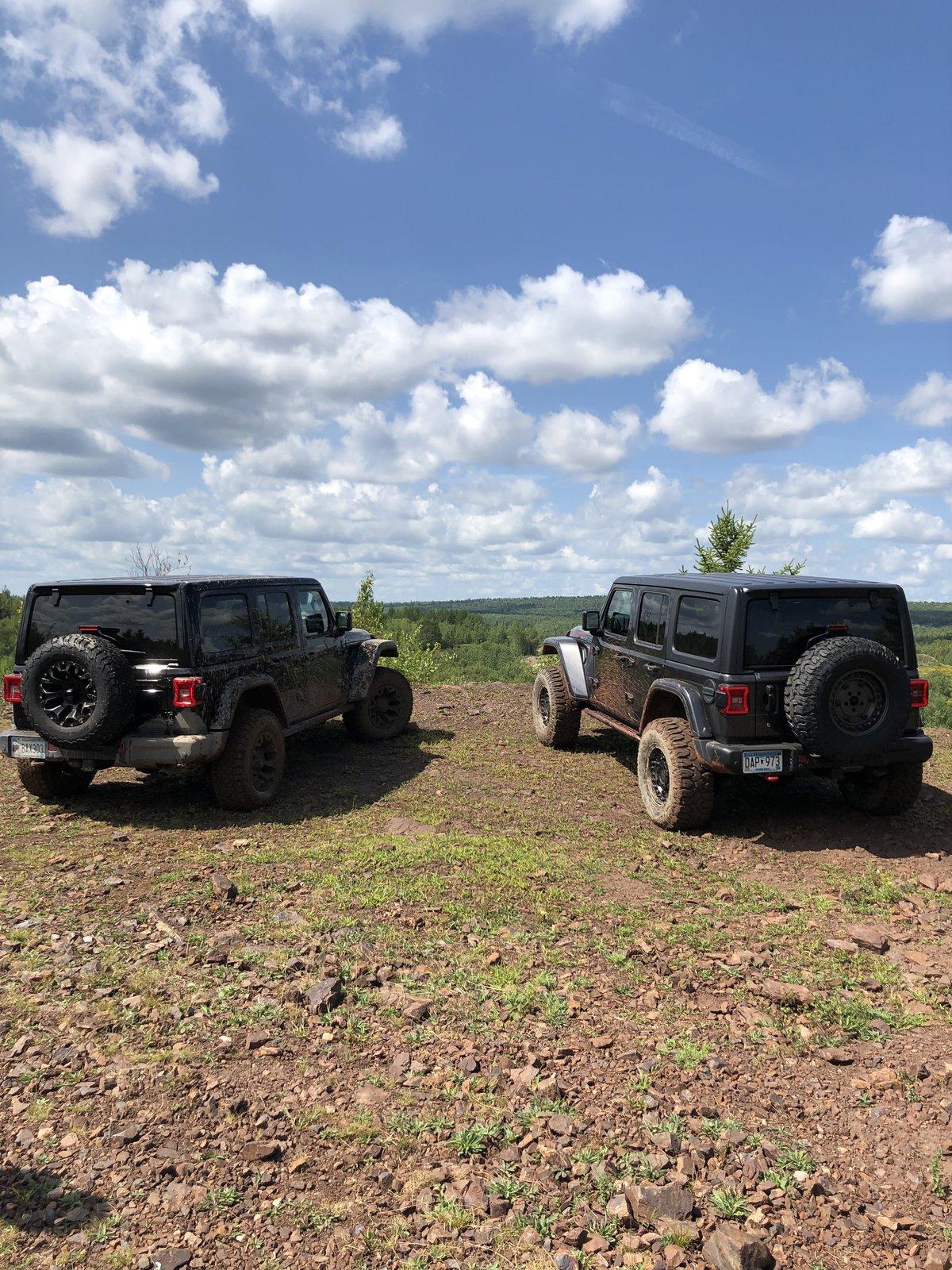

I went to an off-road park with my cousin in his bone stock 18 Rubi and my lifted rubi, winch, wheels, 35's etc. and he could do everything I could he just had to pick his line where as I could do any line I wanted. I also could go twice as fast as where he had to crawl. So I think the stock Rubi can do almost any trails but it requires more skill and more patience, I now have 37's and I just go over half the stuff like oh did I just do that?? It is so easy now! I never even get to use my lockers or even 4x4 for most the stuff clearance is amazing!!
Jeep Wrangler JL Most functional off-road upgrades? IMG_5040
