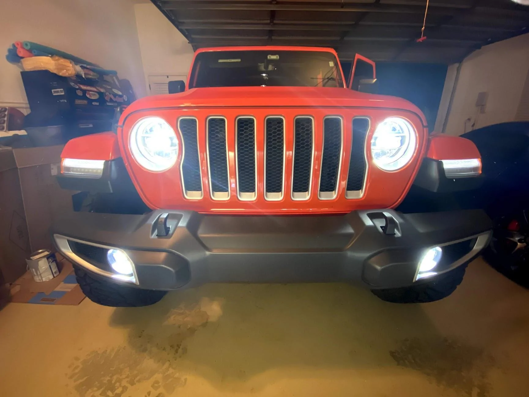

Alright, updated the Tazer JL Mini to 11.2.0, I was on 11.1.4 which already supported the Halos, but now it works. All praise be to jeebus!! Thank you to everyone that has put so much effort into this thread.

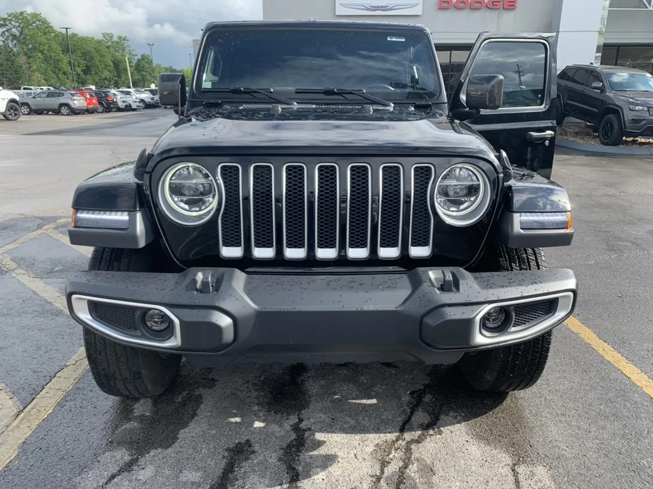

Went to go pick up my Jeep today from the dealership and was a little disappointed. They installed morimoto led turn signal lights instead of the mopar ones. They didnt even function properly. Turn signal light out on in the dash and no radio reception. No bueno. What a headache. They did get the halo lights working which is a plus but I had to leave it again so they can get the turn signals working.
I upgraded my fenders to the paintable HighTop Fender Flares w/ LED. Got hyper flash. Install the Tazer JL Mini. Works great. Ordered the Mopar LED Headlights, Mopar Steel Front Bumper w/ LED Fog Lights, Mopar LED Tail Lights, and a Mopar Remote Start Kit.. Waited a month and they never shipped. So I connected Mopar. They said they were waiting on the headlights. They went ahead and shipped everything except the headlights. Another month goes by. Ship date to AllMoparParts.com (AMP) was May 15th. Bust. AMP said 4-8 weeks out. So I go ahead and install the bumper and tail lights. Flash from dealer. Works great. The Remote start module would not prograM to my existing keys (to be used as backup). They ordered another kit. Hope to be up and running. Got a wench and my Nephews wedding this weekend. Really disappointed on the headlights, but in this case OEM is a better option for me than aftermarket. I would protest the aftermarket turn signals and tell them to get the Mopar ones in. They are plug and play. Also have the same color 2018.
