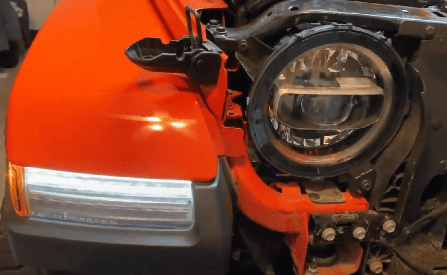

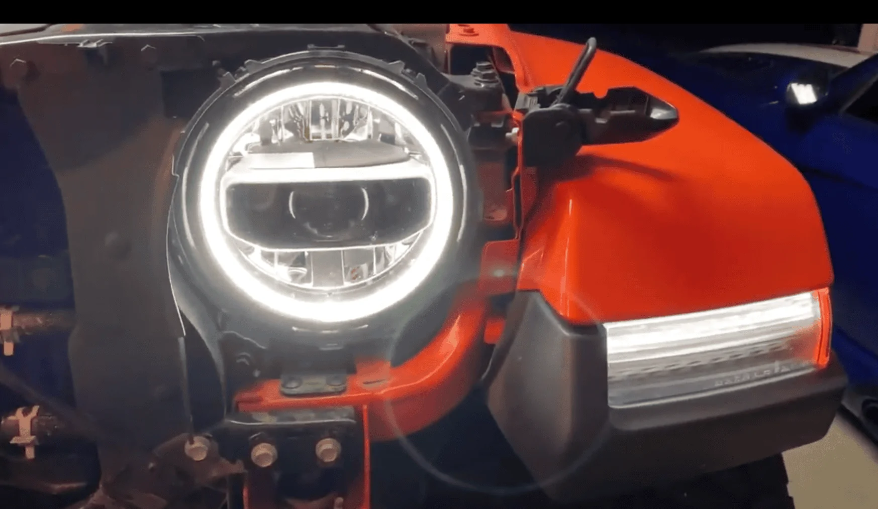

I did the swap as well for OEM LED DRL/Turn Signals, and LED Headlights, and fog lights. Everything worked with the Tazer, the only thing I was waiting on was the OEM wiring to enable the HALOs. I installed yesterday, used the tazer to enable the HALO and only one works. I tested both lights and its not the halos or light, its the wiring. Can someone please post an actual picture of where and how they wired up the wiring harness at the BMC? Following the diagram there's only one side that has enough openings to insert both wires in slots 5/7.
This side works fine - I can swap the wires at the BMC and make the other side work, but still only one.
This side flickers a tiny bit so I'm sure there's something wrong with the wiring.

5 & 7 are the slots. Try turning the option on/off several times thru the tazer setup. I found that helped and they both finally turned on for me.
Thanks for the quick reply. I did try about 5-7 times with the the tazer, hard resets, restarts, etc and still nothing. That’s why I think maybe my wiring isn’t right.

The wires are definitely pins 5 & 7 on bcm connector C1A. Probably dbl check the pins are seated correctly.
I’ve double checked and swapped them out and it just switches the halo that’s working from left to right :/.
