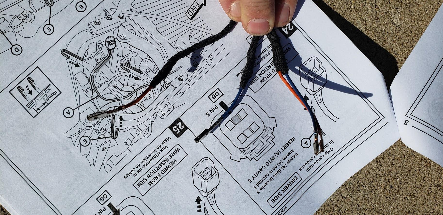

Gentleman, after reading all these posts, still confused on what i'm missing to convert to OEM LED lighting. Please confirm.
1. So I purchased used OEM LED Headlight take offs. Those are only lights with no any additional harness.
2. Purchased Merimoto LED DRLs
3. Purchased smoked turn signals for fenders
4. As I understand I still need to purchase wire/connector in order for Halos to work, part# 68347117AB (pic included), please confirm.
5. Lastly after everything is installed to work property I need to go to the dealer to get it flashed, please confirm.
A'm I missing something? Should this be enough for a conversion? Also, what if I don't have LED tail lights yet, would front be functioning properly? Cause I read other threats that without tail lights front turn signals were malfunctioning.
is this the correct part number do the wiring, look like is for sale by mopar for $60. I also bought the light before the kit was out and would like to wire it the correct way, I don’t like the fuse tap option
Crap I could have seen if the tag on the loom had a PN a few days ago when I did the install, but I don't think it's visible anymore. I'll try to see if it is tonight.
priscillav39
Priscilla
Dec 3, 2019
2019 Jeep JL 2dr Sport S
Yes. I bought it and it is that wire.
