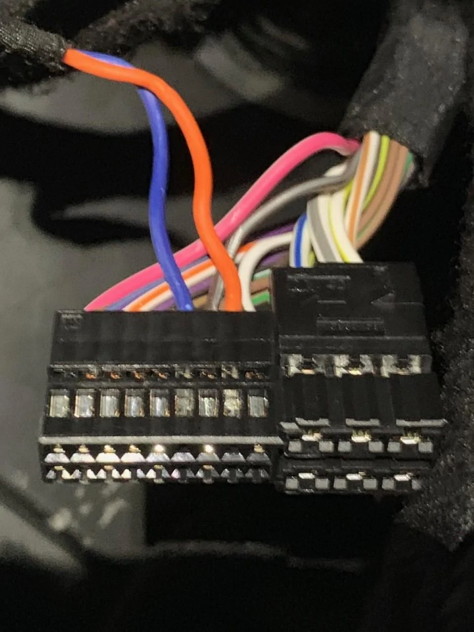

Any secret to getting the connectors to snap in? I can't seem to get the orange and blue wires to snap into the BCM harness connector.
This side faces out, correct?[GALLERY=]

I'm having trouble with the bcm connectors as well. I got the orange wire to snap in but the blue one wont.

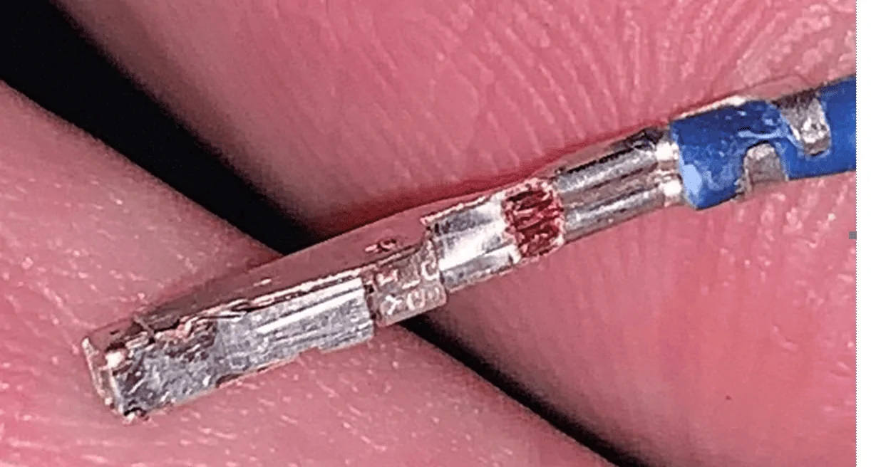

its 5am so forgive me I'm not near the jeep but from the pic it looks like you could just bend the tab out a little more
I finally gave up and its at the dealer because I was getting a Remote Start put in today. I was hoping to just have them have to put LPX into DealerConnect on my VIN, but now I'll see if they can get the two pins to snap in - I would imagine that it happens a lot - probably just need to bend it the right way. Crossed fingers - I talked to the service manager and explained where I got - sounded like it wasn't uncommon. Once I get this done, I am hopeful to never have to deal with the BCM again!
