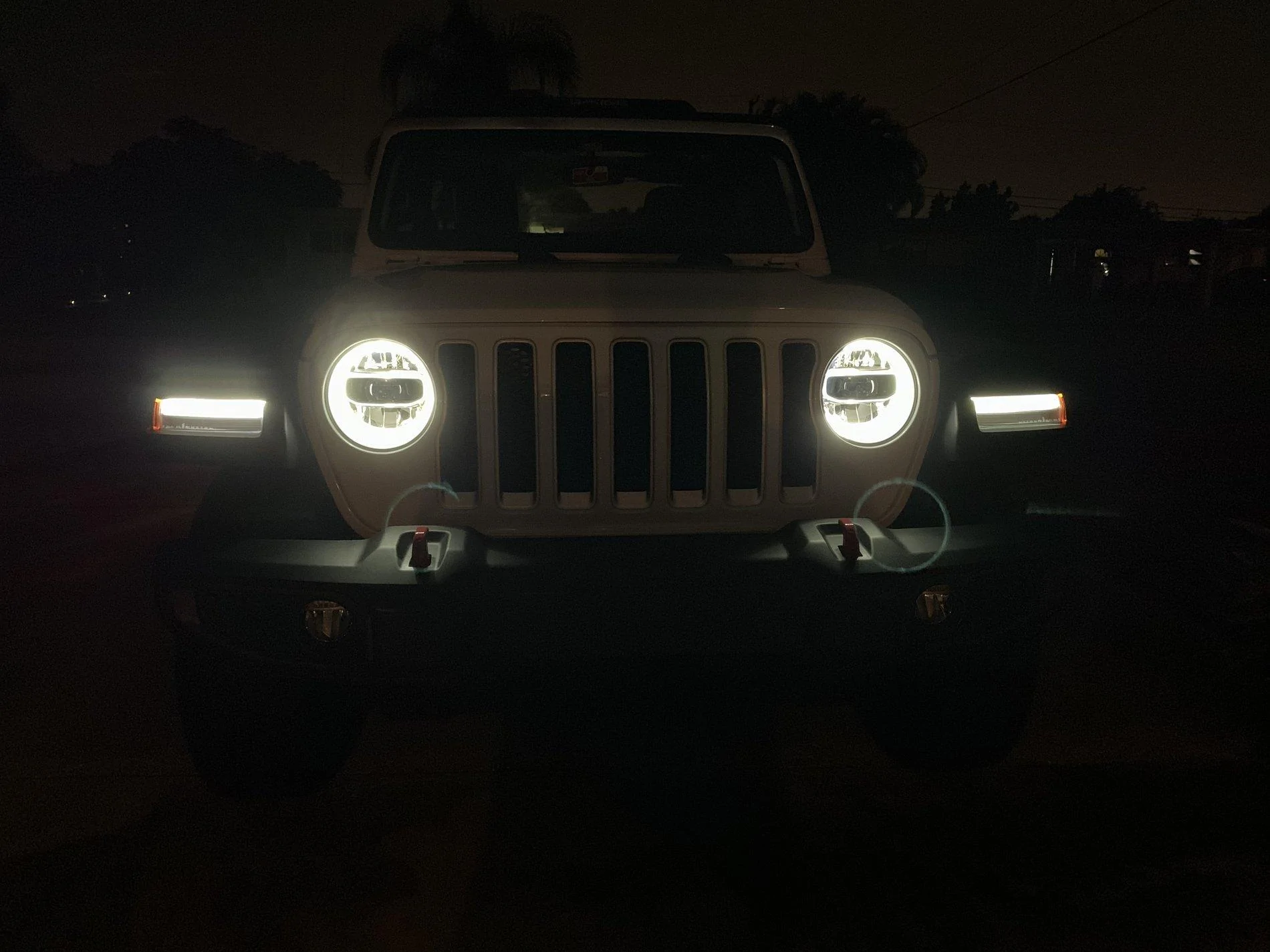

Installed this kit today. Honestly the hardest part was trying to plug the wires in on the inside of the Jeep. My arms must be too long to move around haha. If it wasn’t for that, I would have had the whole thing done in about 1 1/2 hrs.
