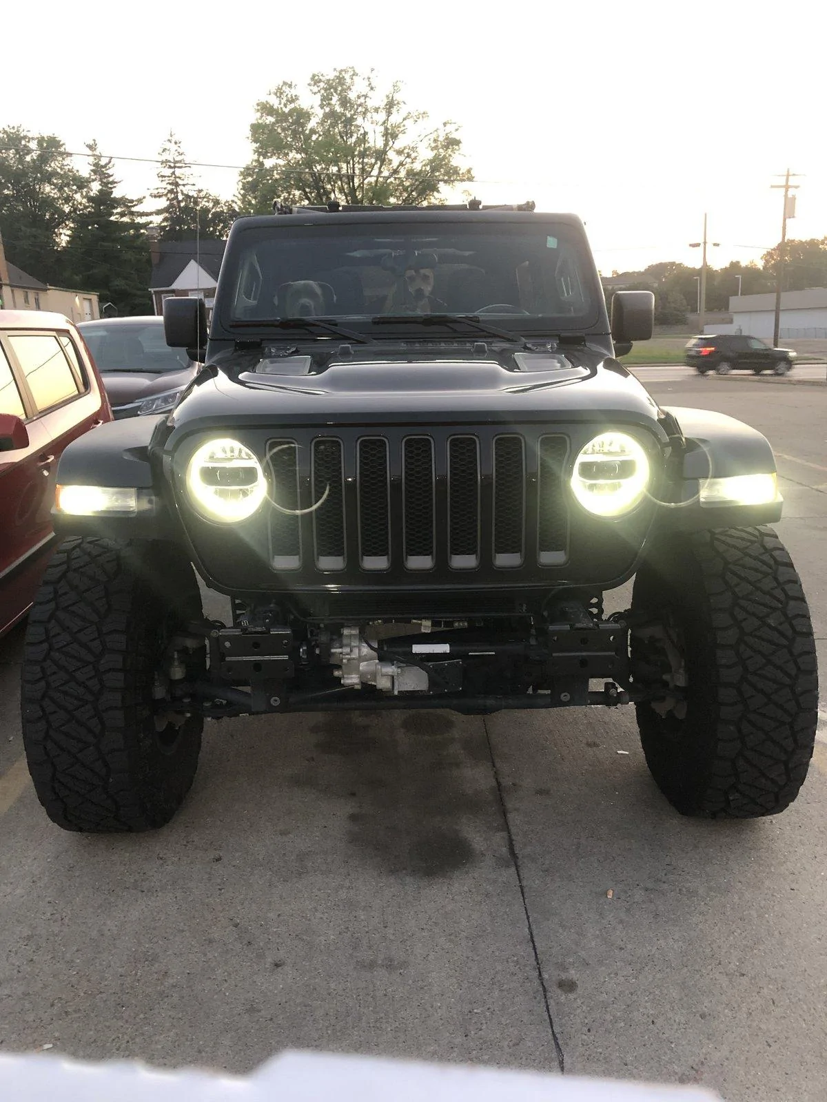

I just finished doing my LED's! I have an appointment tomorrow morning with the dealer to get it flashed so my halos will turn on. Very neck breaking install feeding the wiring harness into the vehicle but definitely worth it! I'll keep everyone updated on how it goes tomorrow. Hoping for no issues!

FAMILY I AM BACK FROM THE DEALER WITH A FLAWLESS FINISH.
So I took it into the dealer and had them reflash the car and everything worked perfectly. I am super happy with this decision and it's a very easy task.

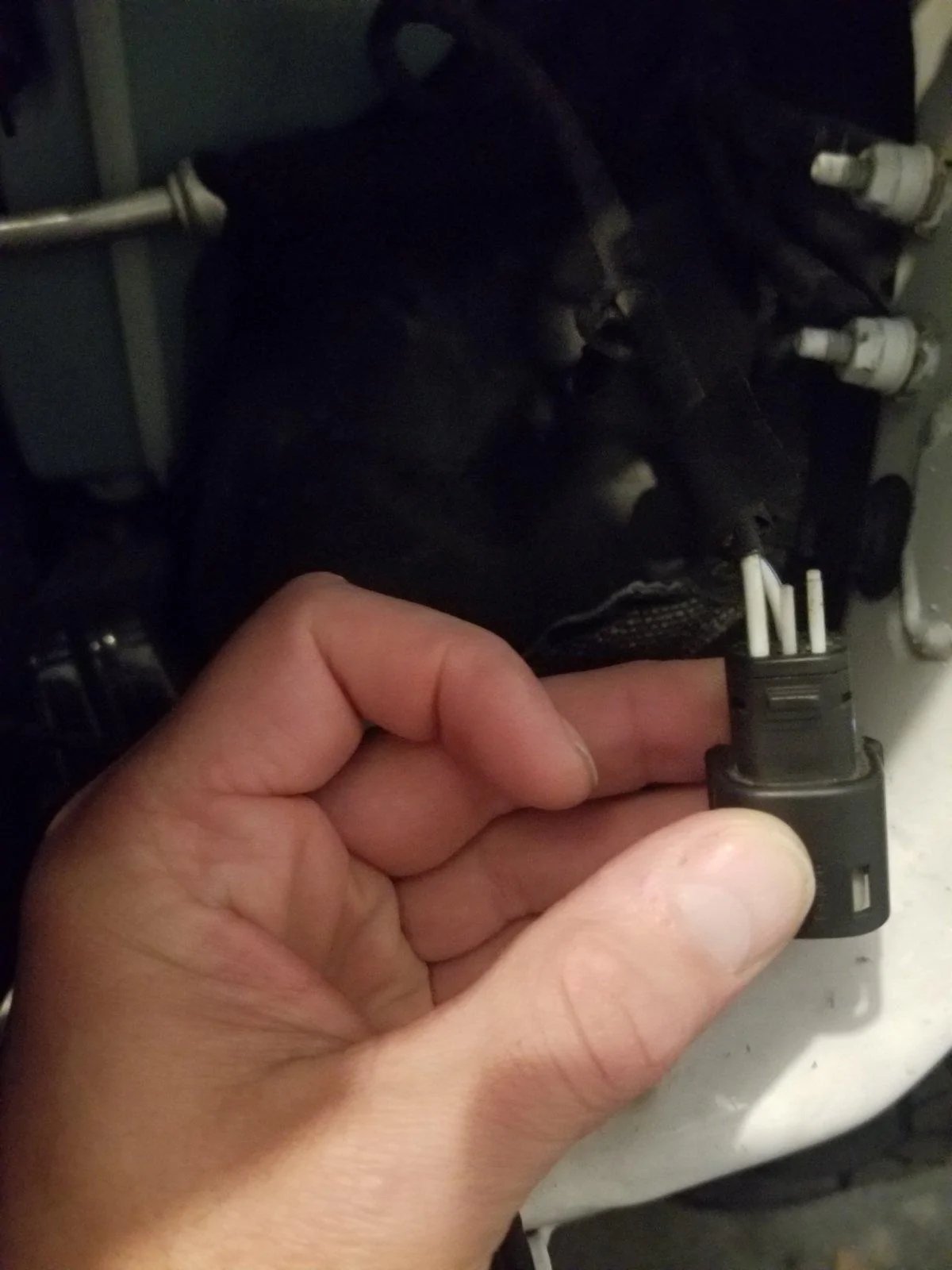

Someone in this thread made a how to on removing it. But all you need to do is find some needle nose pliers and pull the white part out of the connector.
searched all over for someone showing this, i thought it was that easy but they broke with that method.

I figured it out. It’s very easy you don’t mess with the white plug blanks. Leave them alone because they will break. You grab the entire center part of the plug on the other side with pliers. Pull straight out and it separates from the outer housing
