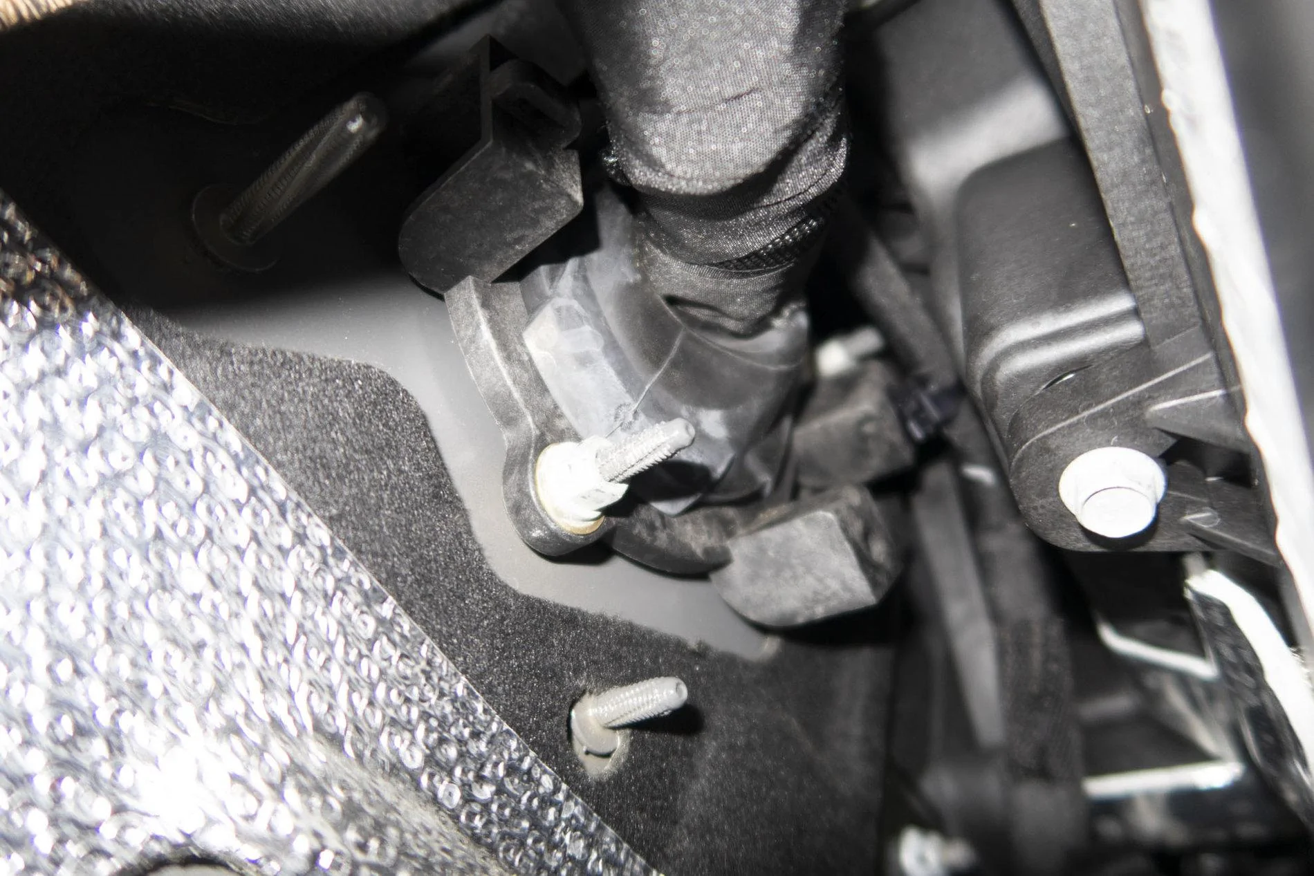

are you guys legit just stabbing a new hole in that giant grommet or is it just really tight around the main harness?
i can feel it by hand under there but without taking the seat out there is zero chance of me somehow getting up in there to actually see it.
if we're just poking a hole i can just do it from the outside and grab it... though things look a little different on the turbos.
Jeep Wrangler JL MOPAR LED FACTORY UPGRADE KIT IMG_3646
Jeep Wrangler JL MOPAR LED FACTORY UPGRADE KIT IMG_3651
trying not to make any additional holes in this thing LOL
I went ahead and poked the hole through the grommet - seems like it will seal fine with the RTV - wish there was another way to get it done.

(warning, venting rant ahead) ... the trick was to run a coat hanger through the grommet from the OUT side... and then, long basketball arms where barely able to unplug the connector, before fingers realized that re-seating was very much NOT possible ... fortunately the neighborhood garage wasn't busy and towed it in, and did in MINUTES what took me hours ... Clearly grommet designed NOT for servicing, and (don't get me started on) picture instructions clearly showing puncturing grommet from inside - not likely, at least with 4cyl loaded turbo, initially not having a coat hanger and instead using a sharp implement (of destruction) upon concluding this instruction could turn out VERY badly (with all the wires encased there) declaring that would be a most excellent, even genius, spot to design in a dedicated access grommet / hole (for people like me that shouldn't be playing with sharp tools in the first place) - not to mention the aforementioned instructions would have appreciated calling for whatever gauge wire a COAT hanger might be, or even let's just call it by the technical tool name - "Coat Hanger", instead of a picture pushing sharp implements thru the main wire-way, i digress ... still need to get the code loaded and the lights aligned, but need to get away from paranoia thinking how bad it could've turned out to be, shudder the thought, in the end, fortunately and most importantly, all's well that ends well :) (although have promised to never go anywhere near that grommet and bcm ever again) :)

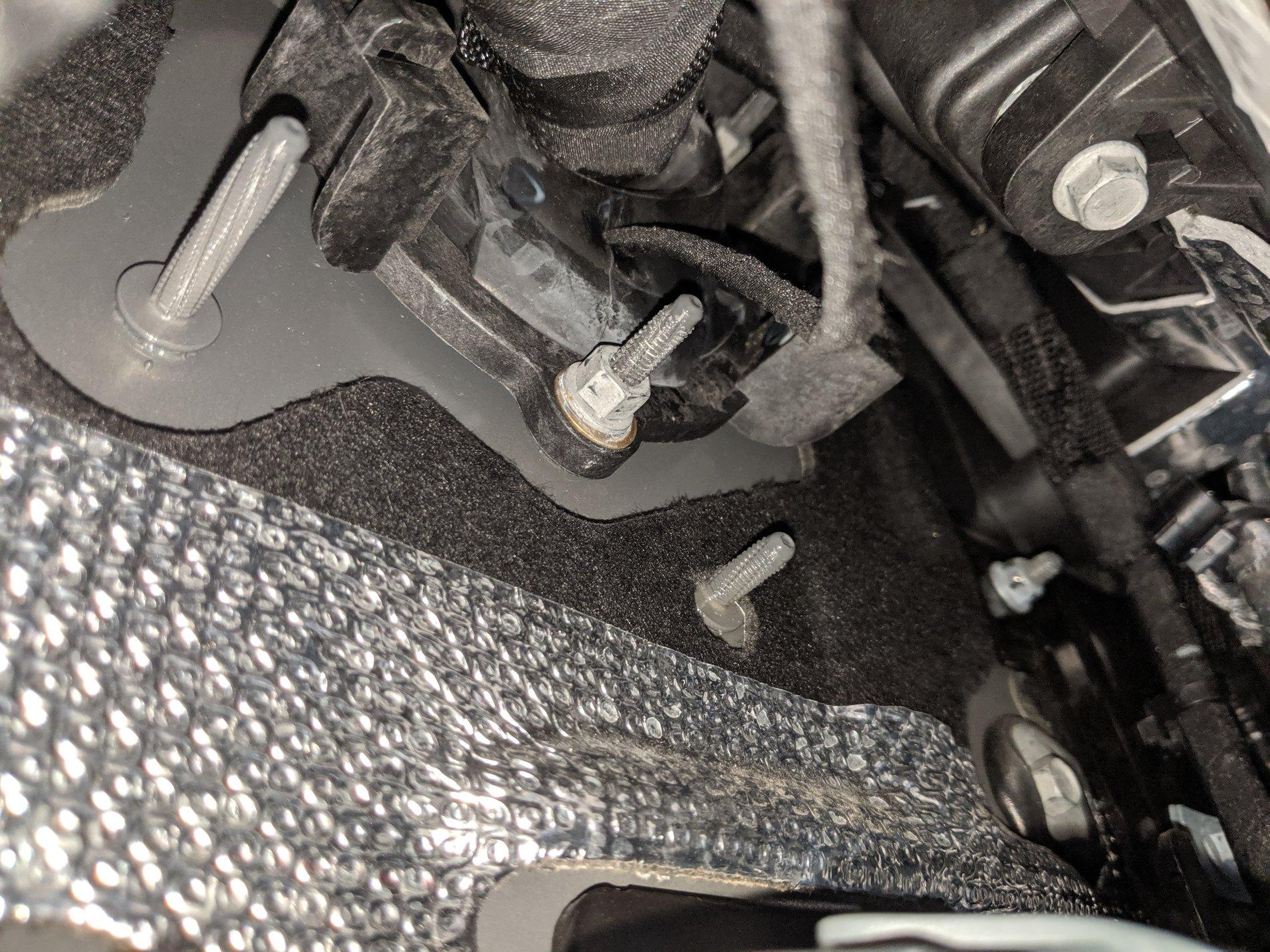

Well the coat hanger took more time to sharpen than it took to push the wire like I figured.
Now I'm contemplating taking the seat out so I can lay on my back and get up in there.
